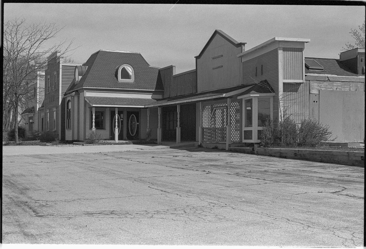

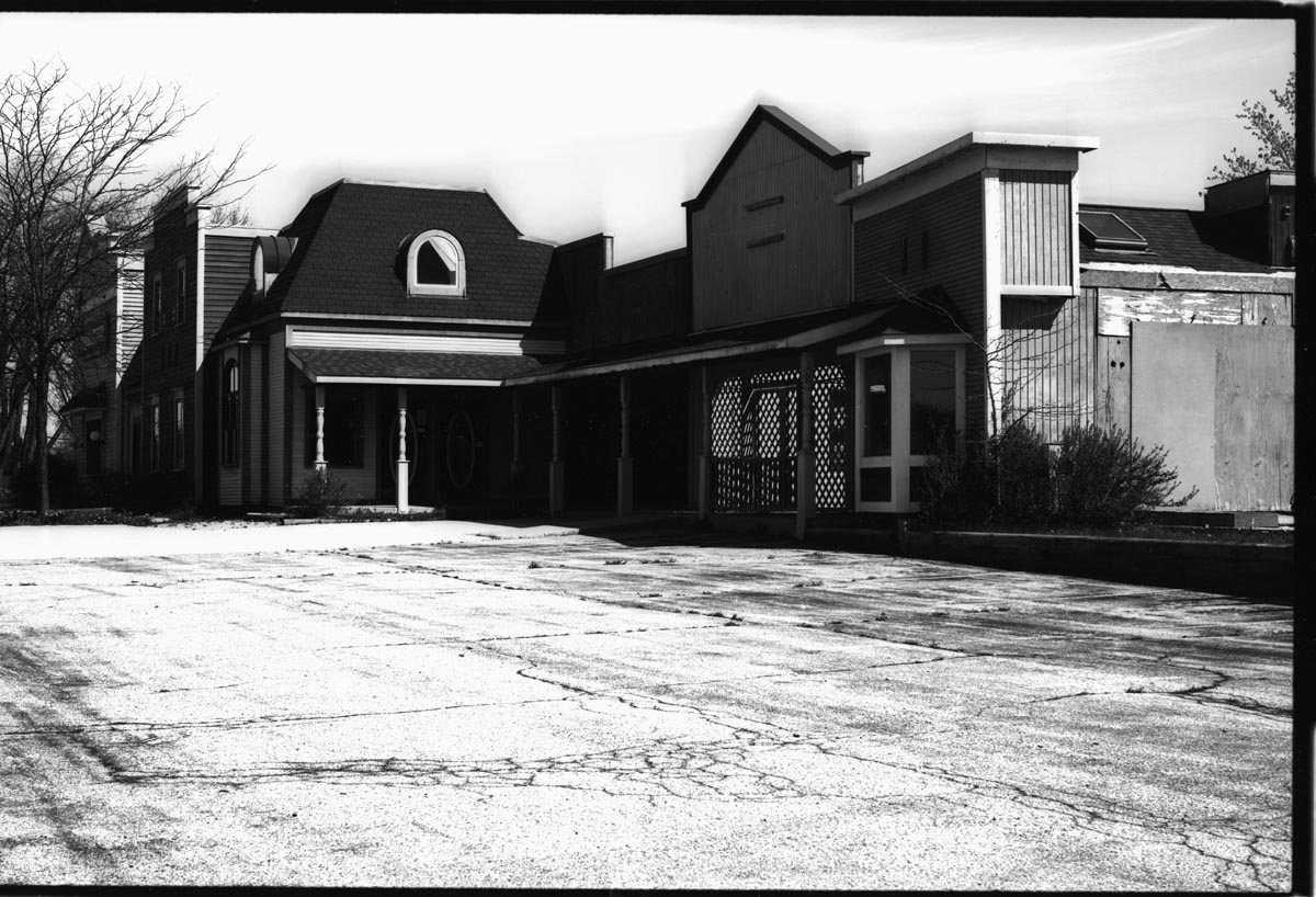

OK, some quick examples from one test shoot...
2369, which is the same as SO-331, which is a high contrast panchromatic intermediate film:

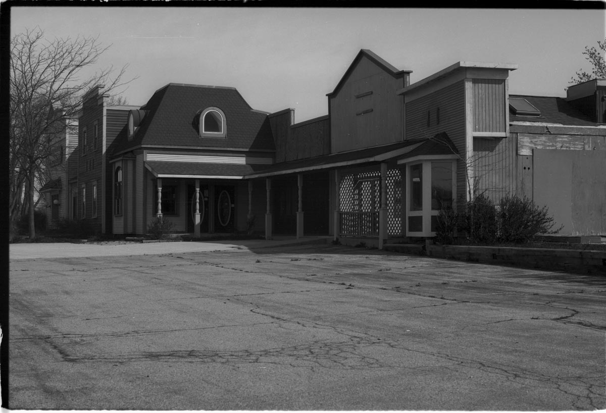

OK, just for comparison sake, here is some Tech Pan just developed in ID-11, i.e. you'd expect it to be relatively high contrast because I didn't use Technidol or take any special care in agitating it or anything. Just 7 minutes in 1:1 ID-11... and it's not nearly as contrasty as that high contrast stock!

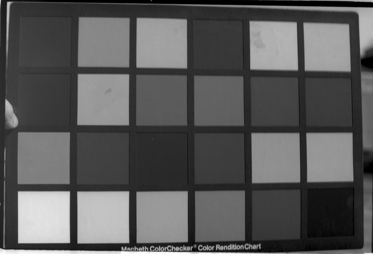

Here's the SO-379. These results should be similar to the 2302 print film that the original post in this thread was pondering because it's the same concept in film... or may actually be the exact same emulsion in its earlier name (I can't tell for sure.)

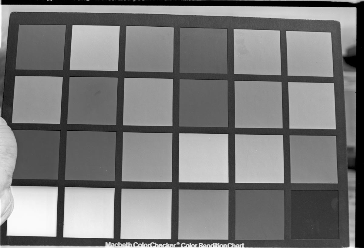

Here's the 5246, processed as a negative film:

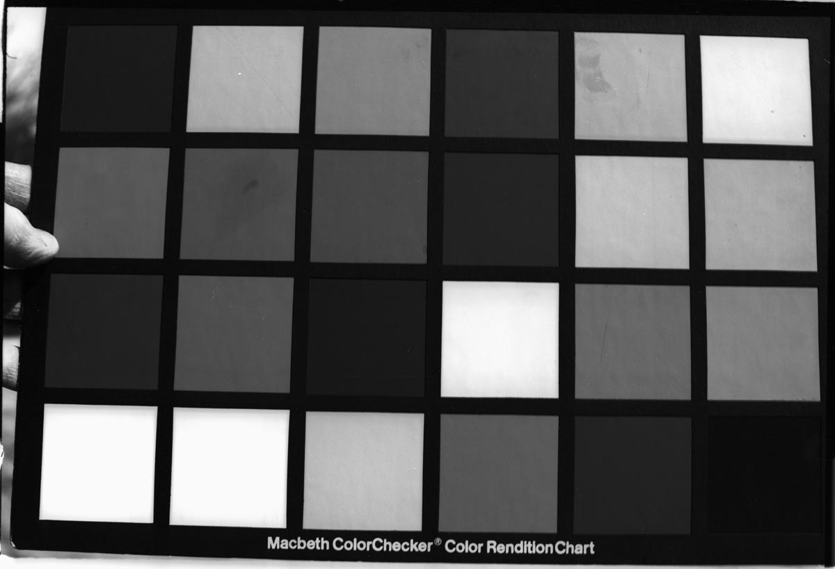

And here's good old Double-X 5222. Grainy but reliable!
