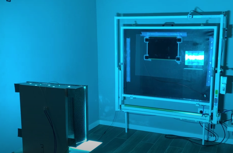

I think I'd be inclined to solve the issue differently and more along the lines of Calvin Grier's approach to exposure: with a powerful light source several feet away from the print frame (horizontal projection). It's seen in this video of his:
He uses a big vacuum frame and some sensors for light integration, but the concept is straightforward. The actual light source is an array of COB LEDs.

Yes as you say there are quite a few ways that it could 'drift' away from calibration over time. I also wonder if I would need to re-calibrate for different processes that might have different sensitivity vs. wavelength curves (e.g. I'm calibrating for cyanotype currently, but would DAS for carbon printing respond the same or need re-calibrating?). My hope is that aging effects over time will largely effect all LEDs equally and any non-uniform brightness changes will be small vs. the magnitude of correction I'm having to apply initially, but I suppose time will tell.
I've seen videos of Calvin doing his exposure with that setup and it certainly is interesting, seems like a fairly wasteful way of doing things but simple and robust. I'm not sure I'd want to stand in the same room as my light source for a full exposure time (currently 4 minutes) if it was uncontained. The LCD screen only transmits about 10% of the light at most, but when I've tested the light without the LCD in place even for a fraction of a second you can feel a significant amount of heat 'bathing' your skin. I have very light skin and a family history of skin cancer so I'd probably get sunburn in short order.
Yes, well, 'wasteful' is relative if you keep in mind why he does it this way. For is gum and also carbon prints, he needed very good collimation to prevent the effect he calls "blowdown", which is the collapse of tiny little dots of pigment-loaded colloid (10-20um diameter in his case, I think). It's a bit of a rabbit hole to go into why and how that's an issue, but the net result of all of this is that he needs very good collimation and the combination of some focusing using crude lenses and large distance is practically the only really feasible way to accomplish this. I imagine you could get a similar effect with a grid (much like you'd use on a strobe), especially a fairly deep one, but this, too, would be very wasteful.
For wavelengths we use, in the range of 365-395nm, the risk to your eyes is more relevant than skin. You'd have to spend a LOT of time directly in front of your exposure unit to accumulate even a fraction of the skin irradiation you'd get when taking a brief walk on an unclouded day. Still, it's good to be careful. Wear sunglasses with open systems like Calvin's, and don't linger unnecessarily directly in front of the unit.
