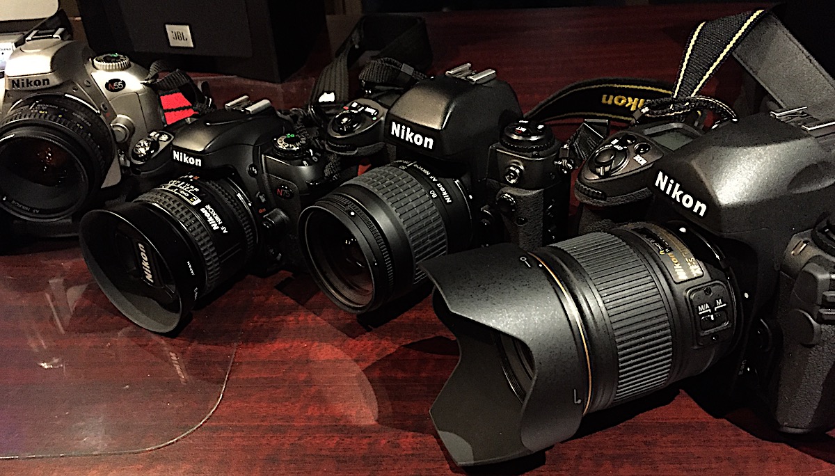

I have never held an F5, but to compare the F100 and F6, they look more related to each other. After having used an F100 for many hears, the F6 is easy to use and feels very similar.
One advantage of a gray market f6. I got all the bodies in the picture for $1600.They are all like new.
mshchem
Nov 26, 2007
14,666
Iowa City, Iowa USA
F5 has the big battery built in F6 gives you the option of not lugging all that weight with a lot of nice upgrades. I have a couple F5 bodies, they fit my hands, I have had D3 and D5 everything feels the same. I would love a F6 but I think the prices for F6 are just going up.

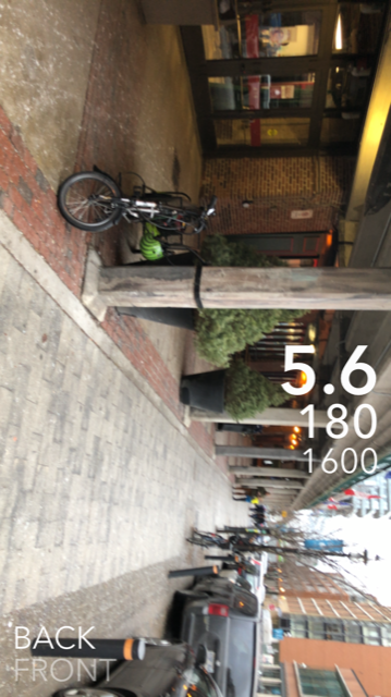

I quit from using of (D)SLRs as exposure meters.
Mobile phone exposure metering app allows to select which spot to meter. Once it is metered, it is possible to take the screenshot of the app.

I've never had luck with lightmeter apps on my phone...
I was very skeptical but decided to try one. It’s called simply, myLightMeter. I have iPhone 6 and 7. The app works so well that I stopped carrying a real (gossen) light meter. I think I did pay for this app...maybe $2.99?
