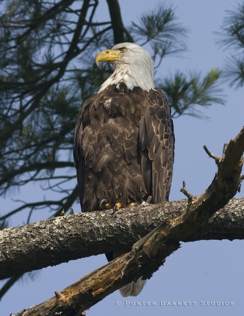

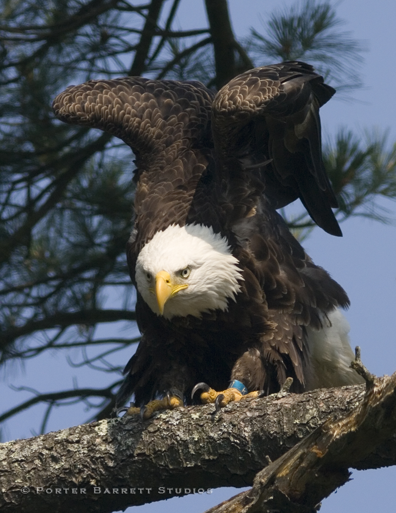

I used to use William Optics and also APM telescopes as long lenses but always sought out apo rather than achro. Better colour correction and less CA.
Used 80mm, 105mm and a80mm if I recall. I was first introduced to the idea by a couple of guys at an astronomy store in the USA back in 2007who were taking shots of an eagle on an apo. I still have their images and have attached them here for you to see (Copyright Dave and Grant at Highpoint Scientific NJ)
