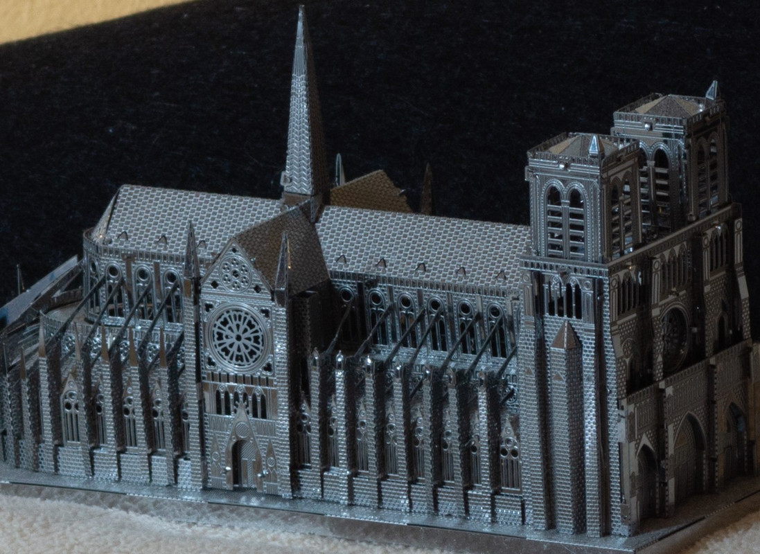

A little while back I picked up a very nice Fujinon 150mm f/5.6, having previously only used an Angulon 90/6.8 with a busted shutter on my B&J Press camera. I was immediately dismayed by the softness in scans at high magnification. I've since been able to attribute that problem to back-focusing caused by the ground glass being a bit too deep - an issue that I have yet to remedy (though the extent to which I've wound up overcompensating has been a real eye-opener re: 4x5 depth of field).
Somewhere in there, I decided to kludge up a holder to mount my NEX-7 on the camera for the purpose of trying lenses out. I was very pleasantly surprised by how well the Fujinon did:
A 100% crop from the upper-right quadrant of the digital image, which was roughly in the center of the image circle. LR sharpening turned down to zero (which always depresses me). This one is at either f/8 or f/11, I think.
This made me breathe a big sigh of relief with regards to the quality of this copy of the lens. But the simple form of my question is: should it have? More specifically: if the lens is capable of resolving that much detail (at least in the center) on a 24mp APS-C sensor, is it reasonable to expect that it's at least putting that level of detail on the film? Could a theoretical film with the same lp/mm as the sensor resolve the same detail? Or is there some function of a digital sensor that's giving me a false sense of optimism?

Well, a digital sensor has no intermediate film and scanning effects that would reduce the resolution of the final results, including your ground glass issue. As an aside, Clyde Butcher uses medium format lenses made for film cameras with his Sony digital cameras and prints 60"+ wide photos. I would assume, large format lenses would be similarly capable.

You’ve proved the lens has great resolving power which is not surprising. Now you have to properly adjust the groundglass and film plane to be identical. Then you will get the sharp pictures you expect.

Thanks for the replies. I'm getting a mild "I was right" vibe, which is nice! I actually think I'll end up getting rid of the lens at some point soon, since I'd rather have something wider (and with deeper DoF), but it definitely seems nice. And I bought a lot on eBay recently with some film holders and two orphaned ground glass backs, so hopefully one of them is sound and can be attached to my camera! If mine's error were in the other direction, I'd try shimming it, but I haven't the foggiest how I'd move it forward without sanding the whole thing down. I'm sure that would end poorly!

But I'm not sure that using a small sensor to image a small portion of the lens' image is going to tell you much. You basically need something like a flat piece of film to check whether the light images out to the corners the way you want it to.

Yeah I wouldn’t expect the same performance toward the borders (especially since the angle of light will do weird things to the sensor the farther out it gets). I did take some shots with full vertical shift, and they also looked good, but that’s still likely only around the 25%-from-bottom mark.
Still, it doesn’t need to do anywhere near that well, considering the resolution of any film beyond CMS 20. By my calculations a full array from the Nex-7 sensor in the 4x5 frame would be over 700mp…just a smidge of overkill there!

Like many beforehand with the same notion, using a digital camera to rate large format lens performance is a mismatch, and potentially going to give you misleading results. For one thing, view camera lenses are engineered with a large image circle to accomodate movement at both head-on and strongly tangential angles of light. Digital sensors are generally not, and you've only capturing the center of the image circle at best anyway. I don't get the point. Your digital sensor is what - about one square inch of photon capture overall, while 4x5 film is nearly twenty square inches. That like comparing a dinosaur beside an ant, yet expecting to interpret the world of that dinosaur through the eyes of that little ant. Doesn't make sense. Your Fujinon 150 is plenty competent to do the job well, and pixel-peeping won't tell you anything additional which is actually useful. If you can't get sheet film shots which are far far far more detailed than what you get with a tiny digital sensor, then the lens itself is certainly not to blame. With such a massive difference in capture surface area, it would have to be on hell of a fungus-ridden funky old lens to come up the same. But there are many other variables involved; and you're only as good as the weakest link.
