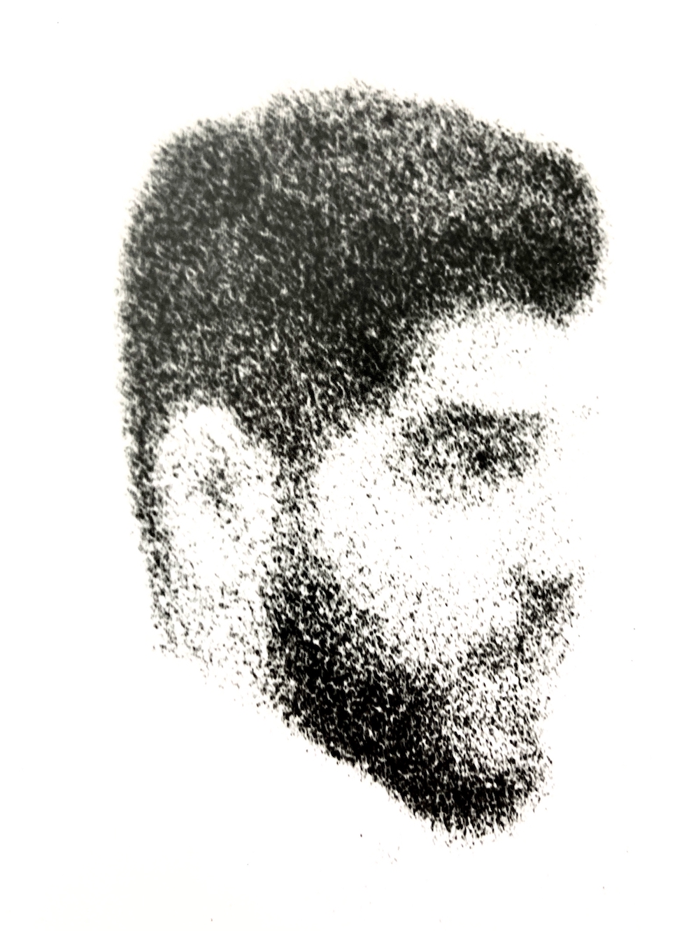

It is interesting that an 8mm movie film frame has much less grain than this B&W print even when projected on a 60" (1.5m) screen. Though I don't have any 8mm B&W movies to compare it to, the only 8mm films I have are Kodachrome.
The magnification here would translate (if I got the math right, and there is a lot of rounding...) into an 8x10 foot print from a 35mm negative.
Has anyone tried using a slide projector to make a high magnification print?
Single frame? I've been under the impression that movies don't look as grainy as stills on the same film because you're seeing 20-30 of them per second (24 is the standard for 16 mm cine, IIRC). Not to mention cine film is usually either developed to lower contrast (which reins in grain) or reversed (which in my experience greatly reduces the appearance of grain), in B&W -- and in color, you're seeing dye clouds instead of silver grains anyway.

This is Photrio -- is that even possible? :wink: Anyway, I'd guess that the film used for this enlargement was probably not one intended for the smallest cine frame. Even Tri-X Reversal is fairly fine grained. This, judging by the full frame, is probably either T-Max P3200 or Delta 3200, or else it's a 400 speed film pushed to 1600 or higher.
Hey, you cheated :wink: It is HP5 exposed at 1600 and heavily overdeveloped so your last guess was correct. I have to remember to try Tri-X too because I'm in belief that it has the most beautiful grain of all films. Hmm, maybe I shouldn't try and maintain that illusion :smile:

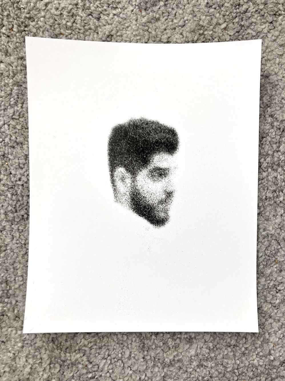

I like the print dryer...
Nothing beats Finnish summer breeze. It improves the actual photo and increases dMax.
Printed some more, this is fun. These new ones are drying in Finnish sauna. You guys haven't heard of smoke toning?

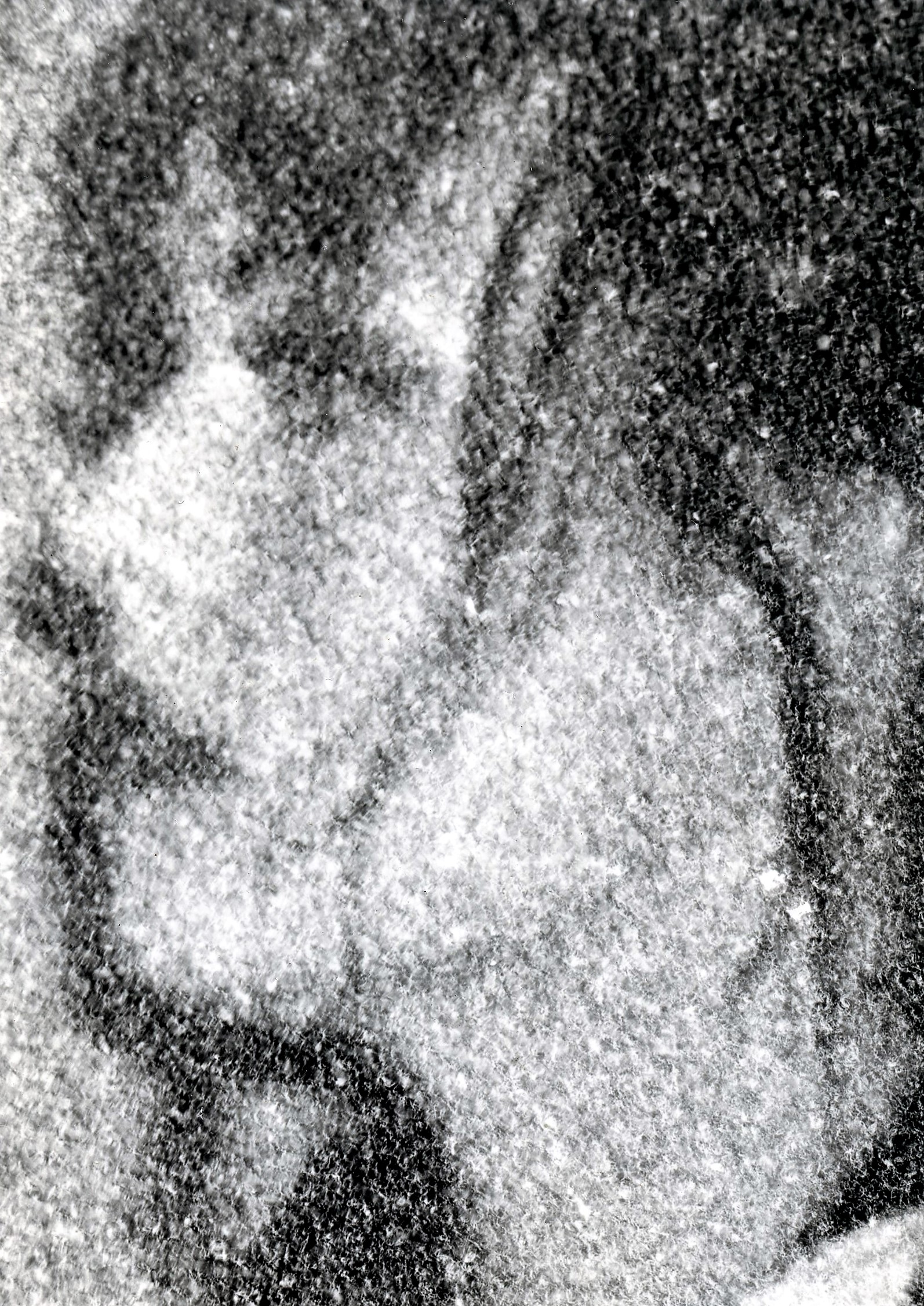

Even with fp4 I can get grain.
This is a 5x8 print with the enlarger quarter the way up and at f4 with No.4 contrast filter and about 75 sec exposure on my Durst 1000 with 150 watt globe.

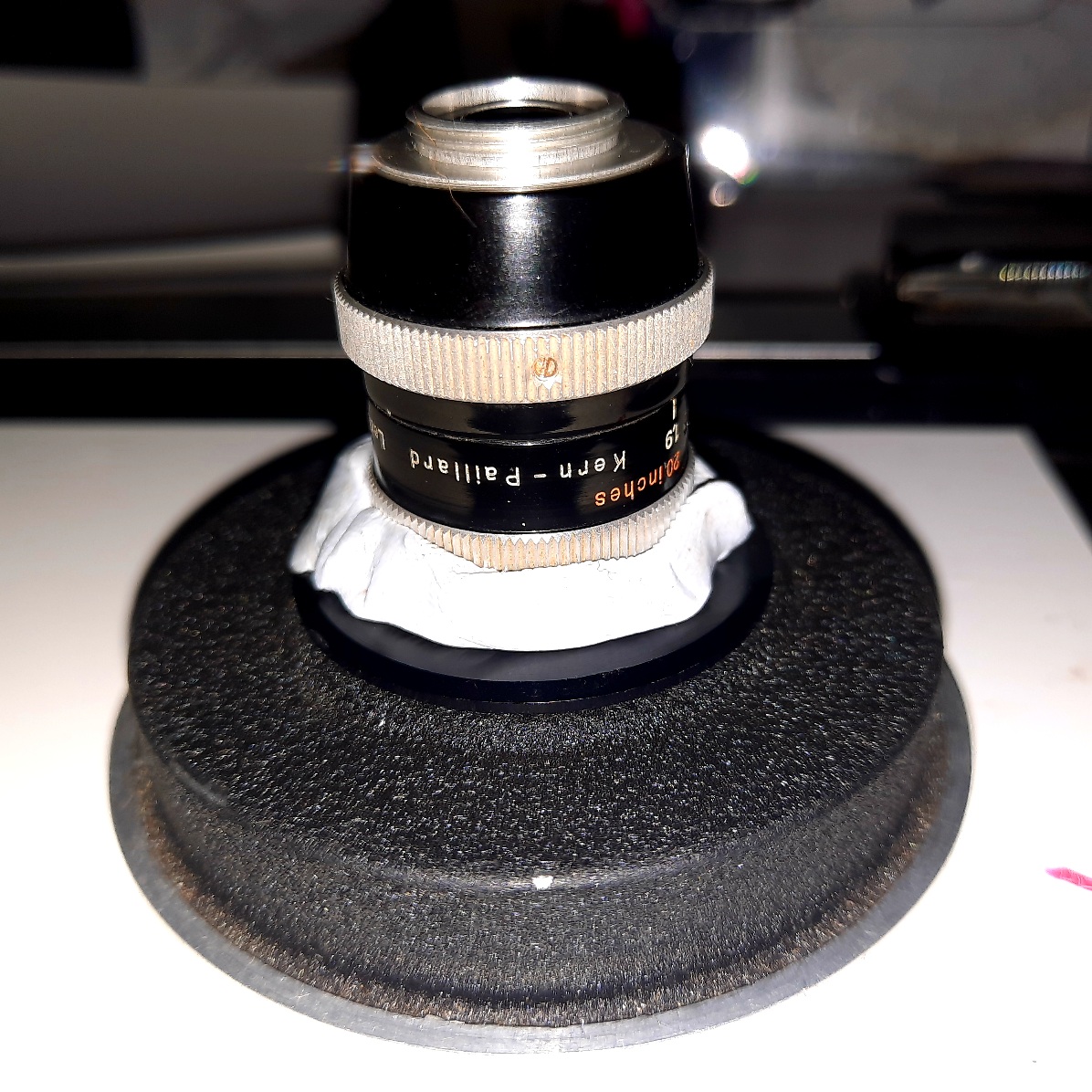

Found an appropriate lens. This one has a filter-holder retaining ring on the front with enough exposed threads to capture a lensboard. So I'll mount it that way, sticking upward from the lensboard.

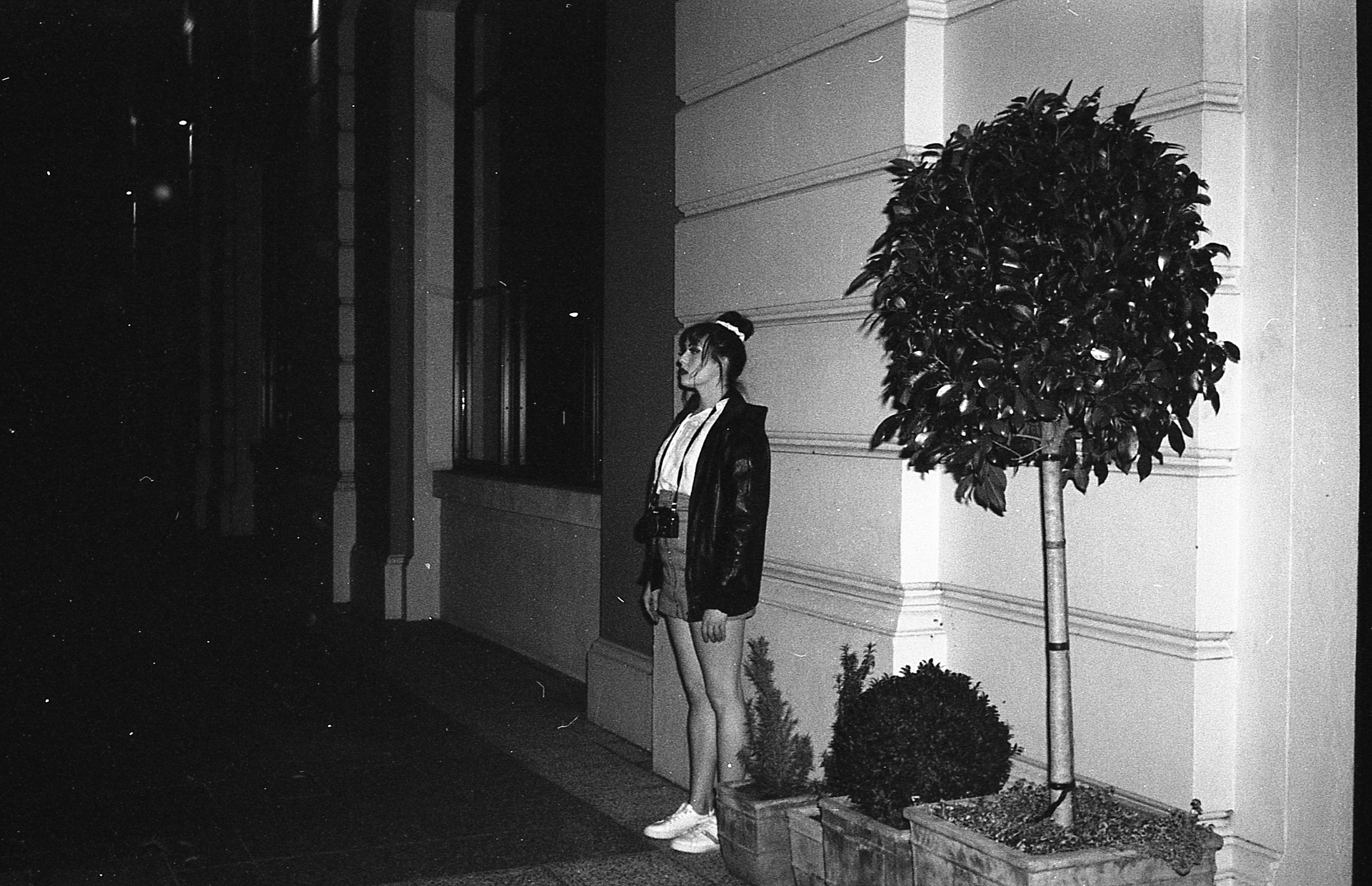

There is now photos inside photos. This is fun!

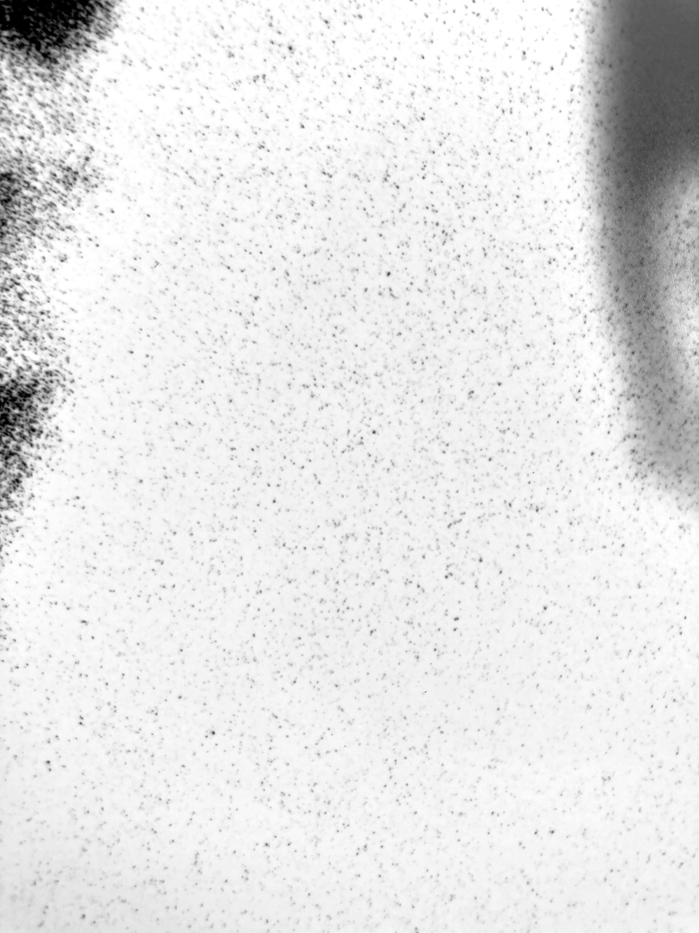

And the grain. It is wonderful to see real grain, even on really dense highlights there are some lonely grains who have decided to hang around.
I have to correct myself. The dense parts have grains who have decided not to stay on the party like 99.9% of the rest of the grains.

I tested 3D printed mount and holy crap that is sensitive to focusing. .
Considering how close your lens is to the negative I imagine if you touch the focus control at all it makes a huge difference! I know my Beseler is not designed for focusing in that minute of increments. And if your negative moves at all (from heat, etc) that will throw off focus more than it would with a normal enlarging lens. It's a fun experiment!
