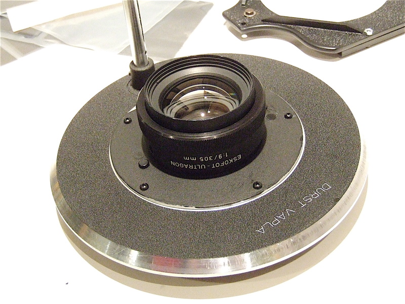

If you are on a budget, then process lenses can be a good alternative. A few years ago, a friend had a box of these. He gave me one. Works just great for enlarging 8x10 (see image of Eskofot-Ultragon 305/f9).
