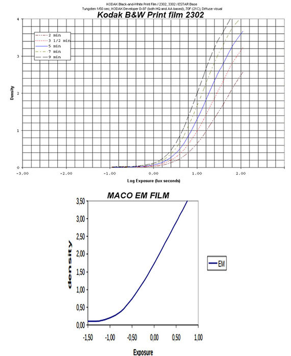

The films for the electronic microscope are characterized by a high resolution power ( › 300 lines / mm).
They may be sensitive to violet and blue radiation (up to 495 nm) - KODAK Electron Microscope Film 4489
There are also orthromatic films, sensitive up to 590 nm - MACO EM Film
http://www.puntofoto.it/public/marche/26_2.pdf
Compare the characteristic curves of MACO EM Film with kodak b & w 2302.
The kodak b & w 2302 is less sensitive with two diaphragm than MACO EM film.
The contrast for kodak b & w 2302 and MACO EM Film seems similar.

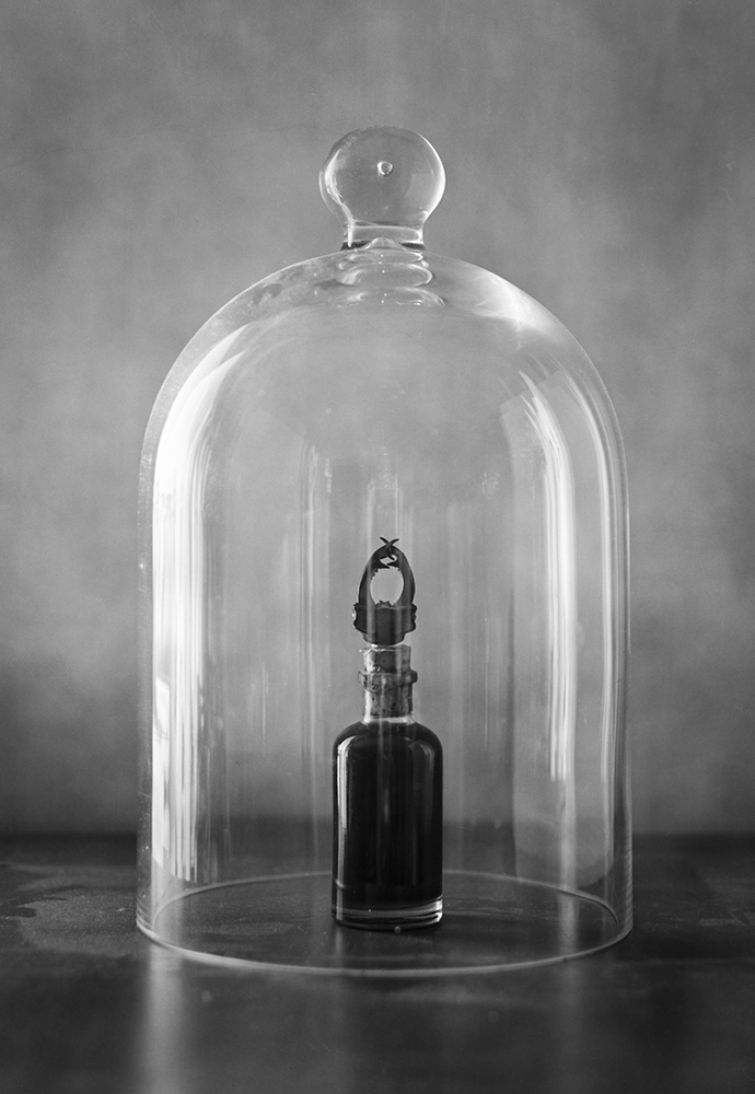

First try, exposed twenty seconds at f8 with my 150mm Voigtländer Heliar, on Sinar Norma. Developed in D-76 stock solution under safe light. Tricky to see the image at the emulsion side of the film but I realized it was easier to read out the develop status on the back of the film(?) to get a snatch point.
The liquid in the bottle is yellow, so I guess there will be no yellow filter on when I try it outside :wink:
Great results. Did you have to do anything special to fit the film into the holder?
Thank you.
I used a small piece of tape to attach it to the back of the holder (9x12)
I hadn't considered it. I guess that's easy enough under a safelight.

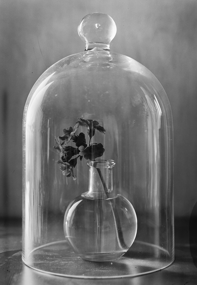

This film is weird. Today I used a lavender blue kind of Primula (or Auricle, actually) to get light looking flowers, but they turned way darker than they are :/

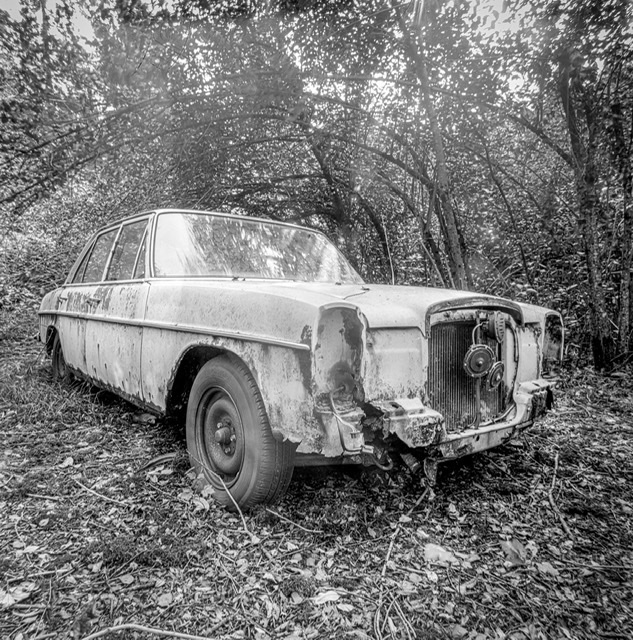

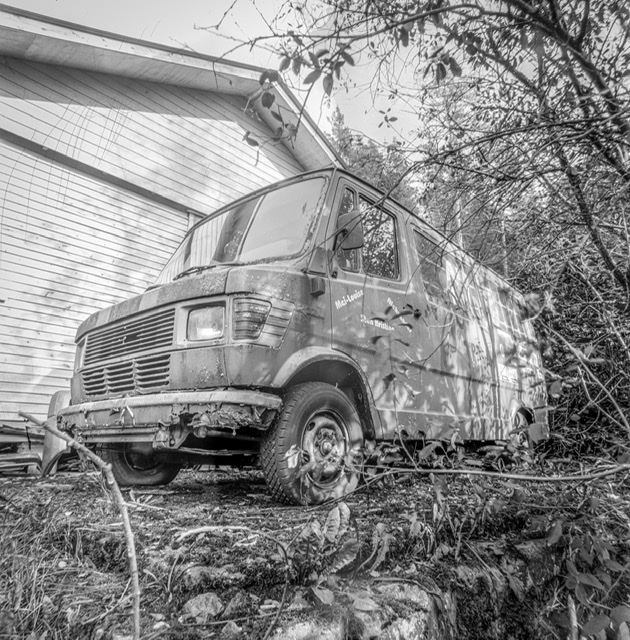

I use daily, at least after fine tuning the developing. Really nice negatives and very easy to print. Looks nice in grade 1 as well in grade 6 papers (Agfa )
I’m rated at iso 1,5 (I have boxes From the 98)
I’m not using any filtering
I’m developing with tmax 1:9 @ 90 seconds using red light ( under supervisions )
