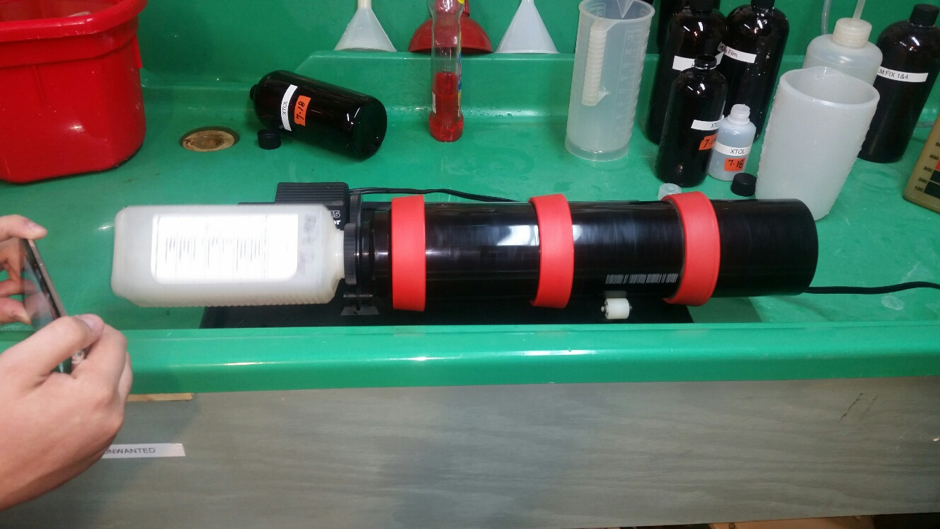

If you can find a Duolab cog, the Jobo bottles will thread directly to the tank. Use a 600mm bottle, thread the tank onto the full bottle. Stand on end the solution will go in a swoosh. Faster than a lift.
Here's a Duolab cog on a 1500 series tank. Using the truly bizarre motorized Jobo Color base. :D.
Cool contraption, @mshchem! I assume the Color base is just a motor with a cog, driving the drum? How does the duolab cog differ from a "normal" one?
Yes, the answer from the official source is that a new lift fits, but depending on serial number range it would need a different cog.
The Duolab cog is a wide mouth cog that is threaded to accept the bottles. You have it right, motor with a drive cog. The base model comes with a hand crank. Not intended for film processing, very dorky contraption.
