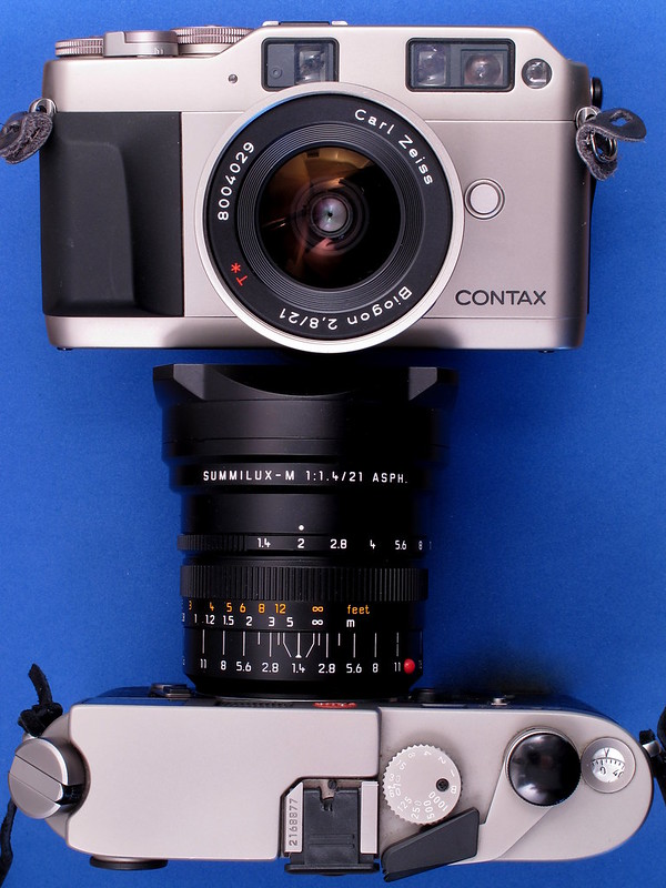

For reportage type work with no flash, when I needed something wider than my 35mm f/1.4, I used a Leica 21mm f/1.4 on my M6.
21mm Lenses by Narsuitus, on Flickr
