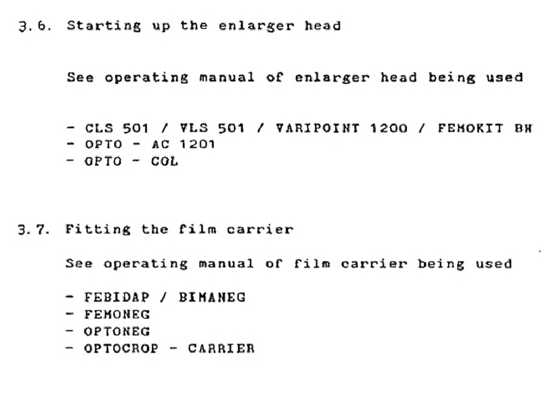

If you could reference L1200 pub that mentions Optoneg please do as I am yet to find it.
Are the names of those bits and pieces written in secret code for national security reasons?
Page 10, 3.7 for starters.

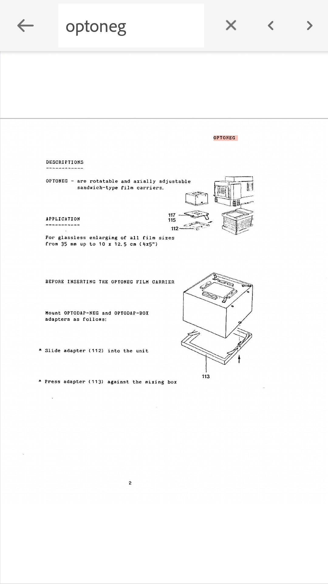

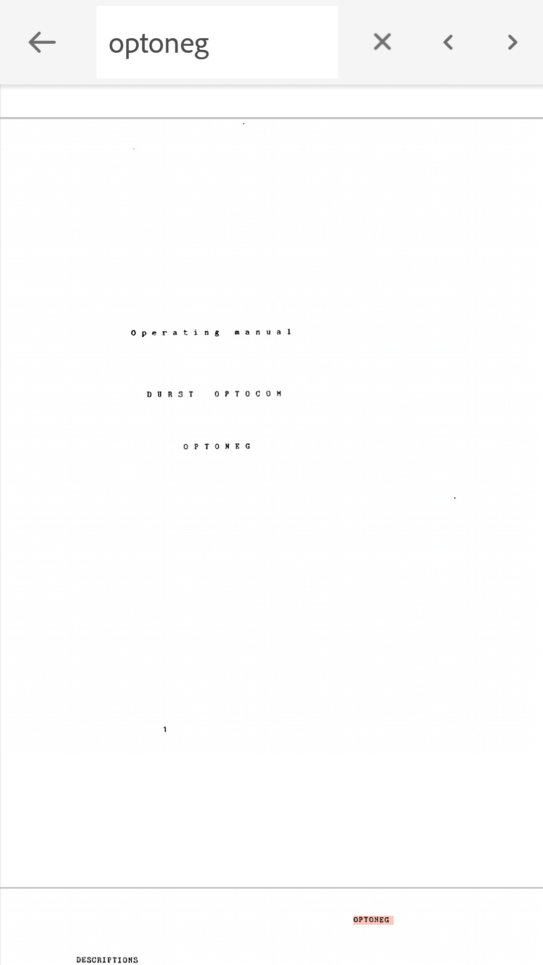

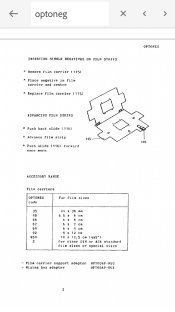

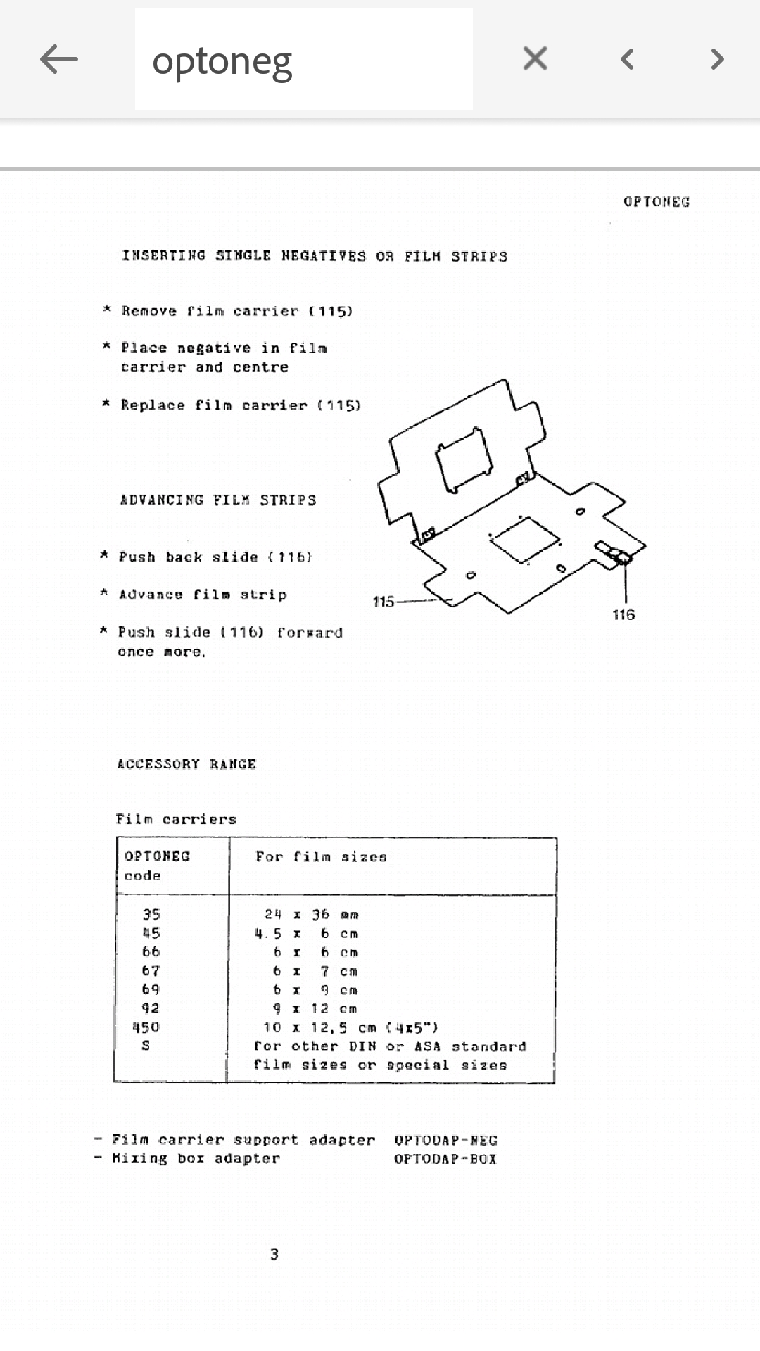

There appears to be a whole chapter. So I'm curious why you can't find it...?
