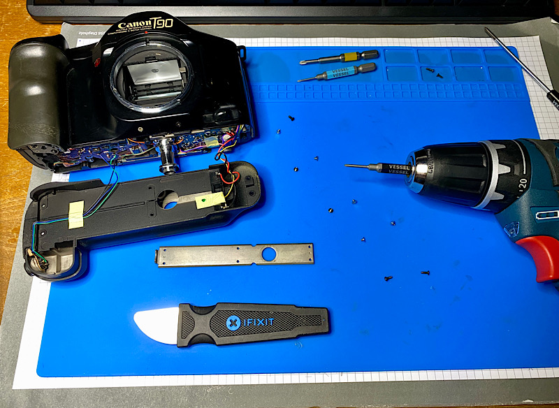

Unscrewing screws with the small Bosch

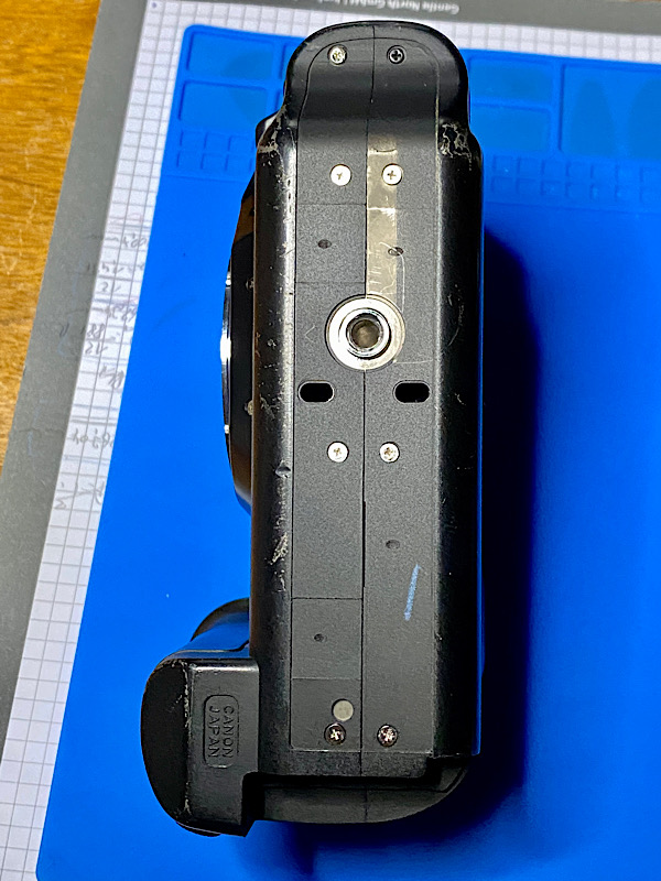

A decommissioned Canon T90 is used as a test subject. The battery compartment has to be unscrewed, as well as the long metal plate around the tripod connection.

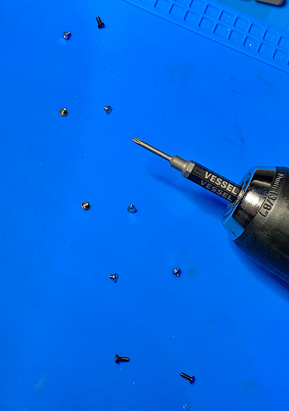

Three Vessel cross-head screw bits are used, which I assume correspond to the JIS standard. I estimate the sizes to be 000, 00 and 1.
Twelve screws in total, none of them are tight.

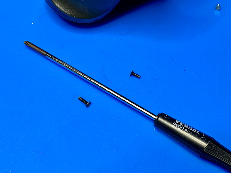

Slightly smaller than my Vessel 00 screwdriver.
The bit grips securely into the screw head profiles and the screws are loosened in no time.
For the two screws on the chassis bottom I need the longer screwdriver because the bit is too short.
The battery compartment is off. Much quicker than by hand with a screwdriver.
Even partially loosening the two screws for the backdoor lock with two turns is no problem.
Conclusion
  • The screws were removed quickly, safely and without causing any damage.
  • It really made work easier.
  • I only had one stuck screw that at least resisted the screwdriver without me trying to use force. With the Bosch it worked perfectly in slow motion.
