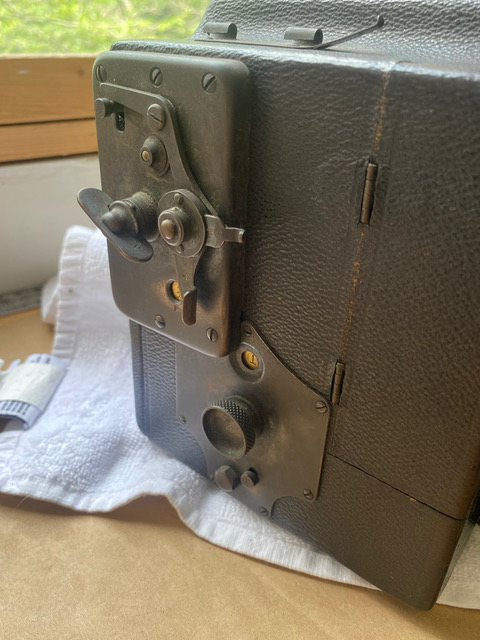

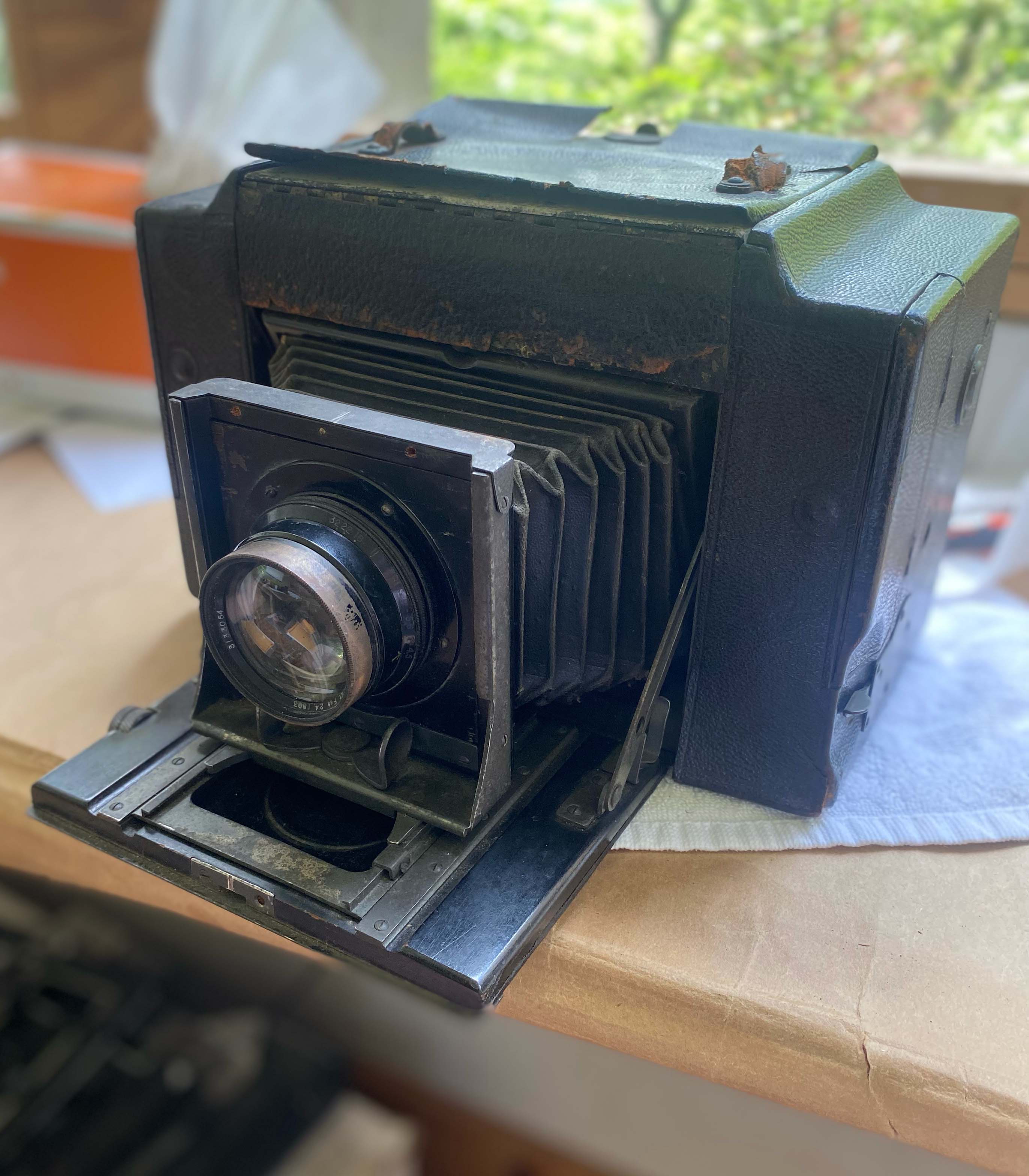

Ok, so I recently acquired a Graflex 3A
It has many issues but the primary on is I cannot works the aperture and speed settings for the curtain shutter as the buttones/levers are'nt all functional
So until if/when I am able to repair/restore the apparatii, it occurred to me that I might bypass the curtain shutter and replace the 3A's lens with a "lens in shutter."

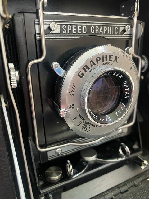

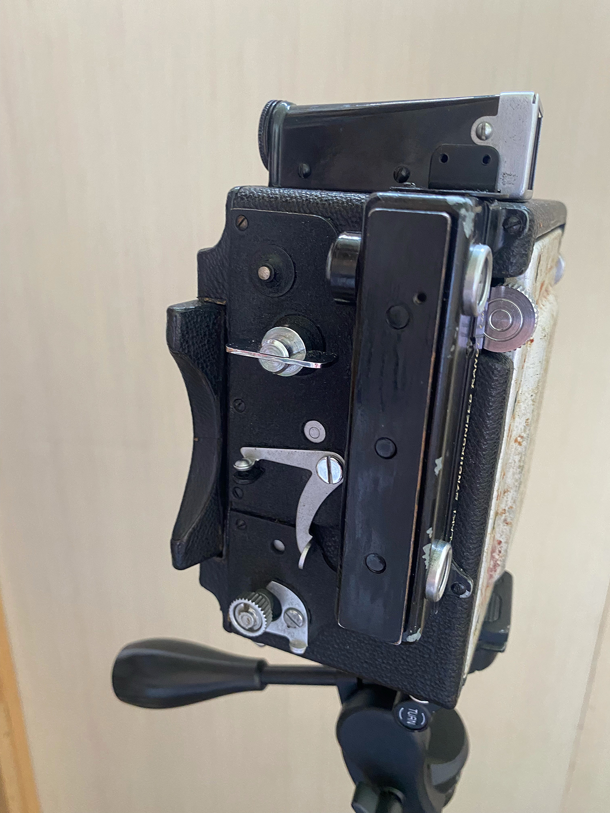

I have a Speed Graphic with which I do this:
The curtain shutter gets set wide open and then the shutter in the lens takes over.
SO, QUESTION:
Can this be done on the Graflex 3A. If so, how to determine what specifications the replacement lens must adhere to? And would other adjustments need to be made.

See the threads in graflex.org under the forum and also the technical camera files. You will need to have the rear shutter curtain fully opened.
The Graflex 3A is a fixed lens camera with a roll film back. To get the full focusing range you'll want a lens with approximately the focal length of the original issue lens on it. If the body's ground glass is in register with the film plane you should have no focusing problems with a replacement lens.
The 3A shoots 3 1/2 by 5 1/2 on #3A film, which I believe has long been unavailable. Not clear that you can use sheet film with it or that you can modify it to use 120 film.

OK, mirror down for focus. See what you want. Close the shutter. Don't move while you click the release for the mirror to go up, stop down the lens, set the correct speed, take your image, hopefully not a speeding DeDion race car, remember to advance the film 3 1/2 turns or 7 half turns if that works better for you. Mirror back down. Begin again next shot. 2 1/4 X 5 1/2 is attractive but a 180mm is hardly a wide field view. Totally do-able. BTW as I just went up to town to get my bride some meds at the pharmacy I stopped for a minute and spoke to some folks in a Model T Tudor Sedan with the stencil on the cowl, Model T Coast to Coast. So, yes, we do what we do because we want to do it. A 180 Symmar would be a fine choice. 165 Xenar if you could find one in a good working shutter. Or 7 1/4" Velostigmat in a Betax.
Well, the aperture's going to be on the lens, not the focal plane shutter. So what in particular doesn't work? If the shutter is intact, and moves freely, chances are the mechanical bits (the buttons/levers) are fixable.
Speed Graphics' and Graflexes' focal plane cameras have slit with and tension choices for shutter speeds. There should be a table on the side of the camera. Now it is time for you to learn to build a new shutter or have some one build it for you.
