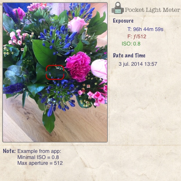

Where do you get a light meter you can set at .8 I.S.O. my Sekonic L-358 starts at 3 I.S.O ?
Beside a regular (genuine) handheld light meter, I also use an app on my iPhone sometimes.
The Pocket Light Meter app goes as low as 0.8 ISO and goes up to f/512. I use it for paper negatives in my pinhole camera. The app can also log all your measurements.
Here is an example from the app:
