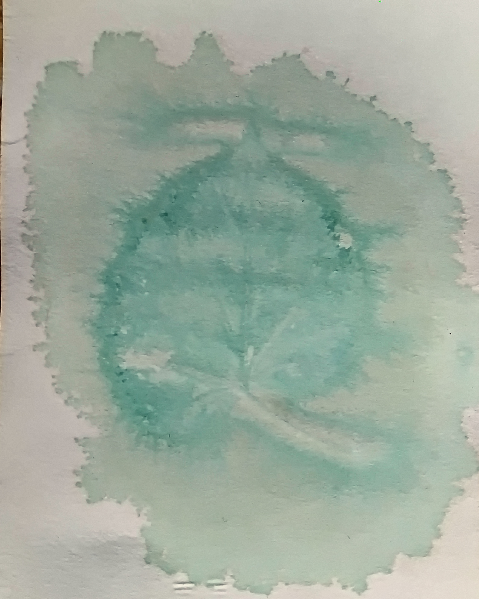

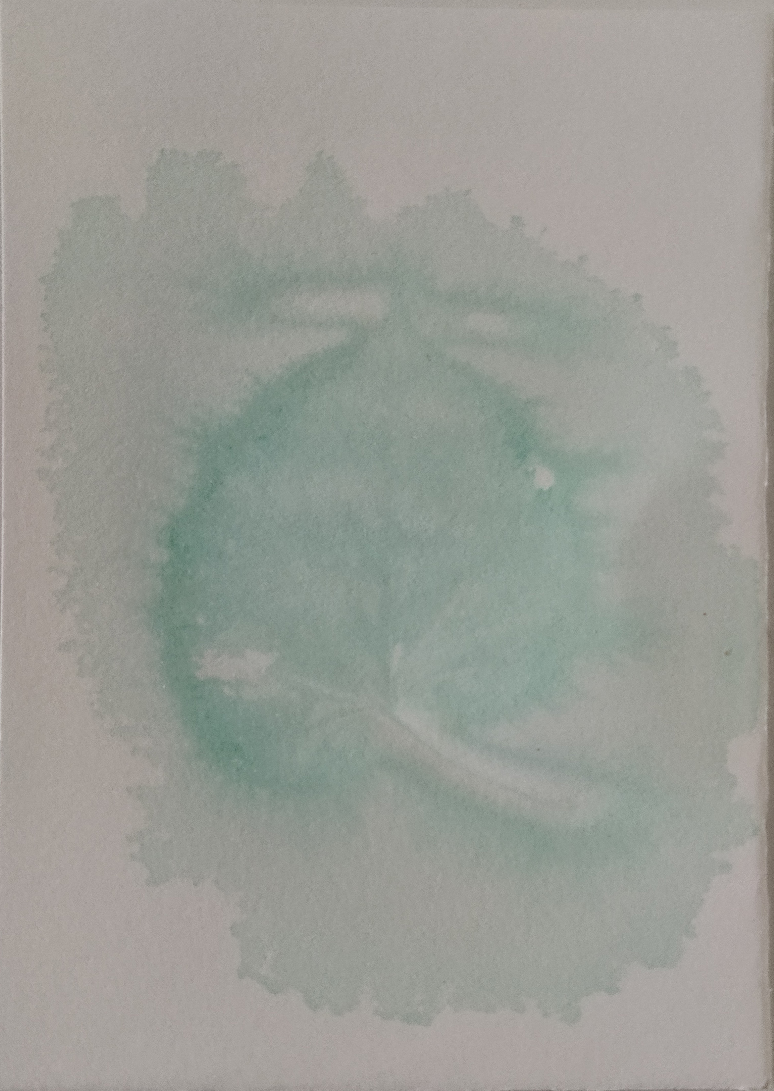

Hello all!
This is a copper halide applied over watercolor paper. It is a leaf over it on a contact frame exposed to mid-day heavy sun for 10 minutes, processed, and fixed.
Interesting!
Would you provide more details? Which halide, at what concentration? What does the paper look like before exposure to light? How did you process and fix?
Lastly, did you do a control that was not exposed to the sun?
I do not shoot the entire process, just after the exposure and after the fix. I will test again today and take pictures of all the stages.
I use copper chloride and coat the paper with a 25% solution. The paper looks pale green. After the exposure [wet exposure], you can see the image is there and positive, like the Bayard process. I have attached an image of this stage. Then I use 1:100 parodinal for an hour and fix it as a normal film using a plain hypo fixer.
About your control question, you mean a coated paper, developed and fixed but not exposed?

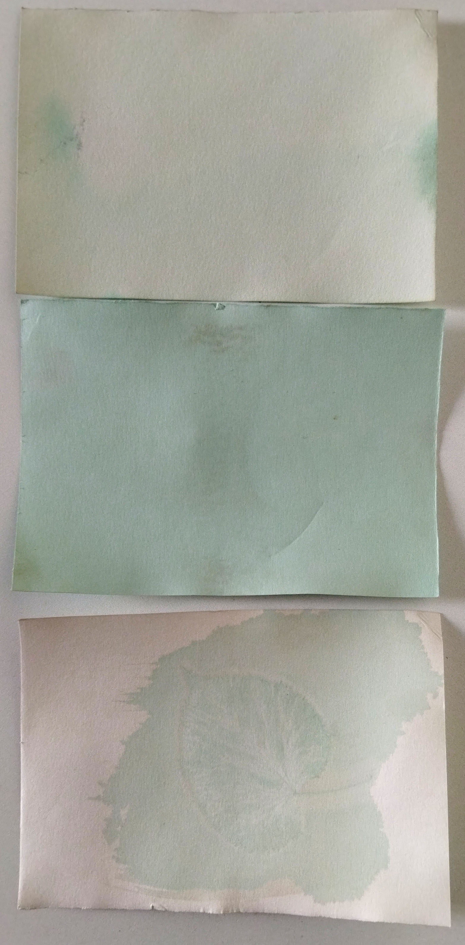

Today the sun was not as intense as yesterday but here is the new test.
The top paper is copper chloride coated with the leaf in the frame for 10min [not exposed], not developed, and not fixed.
The middle is copper chloride coated with the leaf in the frame for 10min [not exposed], parodinal developed and fixed.
The bottom one is copper chloride coated with the leaf in the frame exposed to mid-day sun for 10min, parodinal developed and fixed.

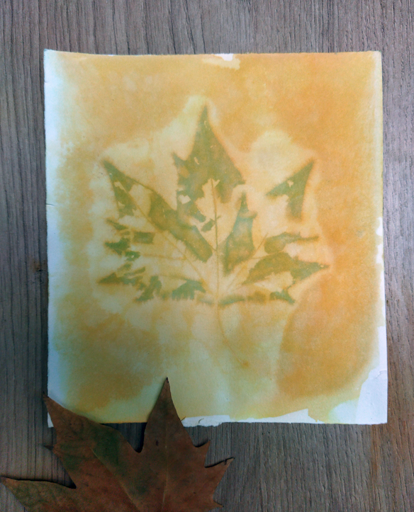

I am still experimenting with the copper halide emulsions and read somewhere that it works with an ascorbate developer. It fact works very well and better compared to my tests with parodinal. Parodinal leaves the image emerald green and ascorbate developer turns it copper color.
