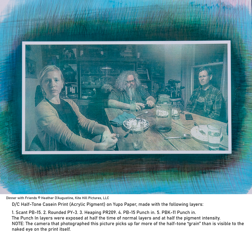

Hi,
I am very pleased to share that I have completed work on both the continuous tone and half-tone versions of the above referenced method. The half-tone method has been improved and updated as a result of my work on the continuous tone method.
Here's the link:
https://www.heatherdaugustine.com/
Take care out there!
Heather
