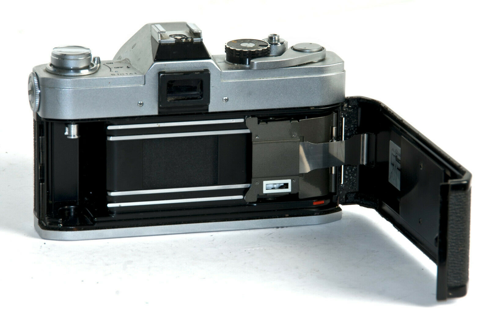

I found this within 10 seconds...it's called FTb QL and has a thing in the back I've never seen.
Does this one work with unperfed, too?
Can these two white sprocket wheels be "rubberized" for the unperfed, maybe?

I see a sprocketed shaft in that FTb QL photo.
Good luck, please keep us posted.

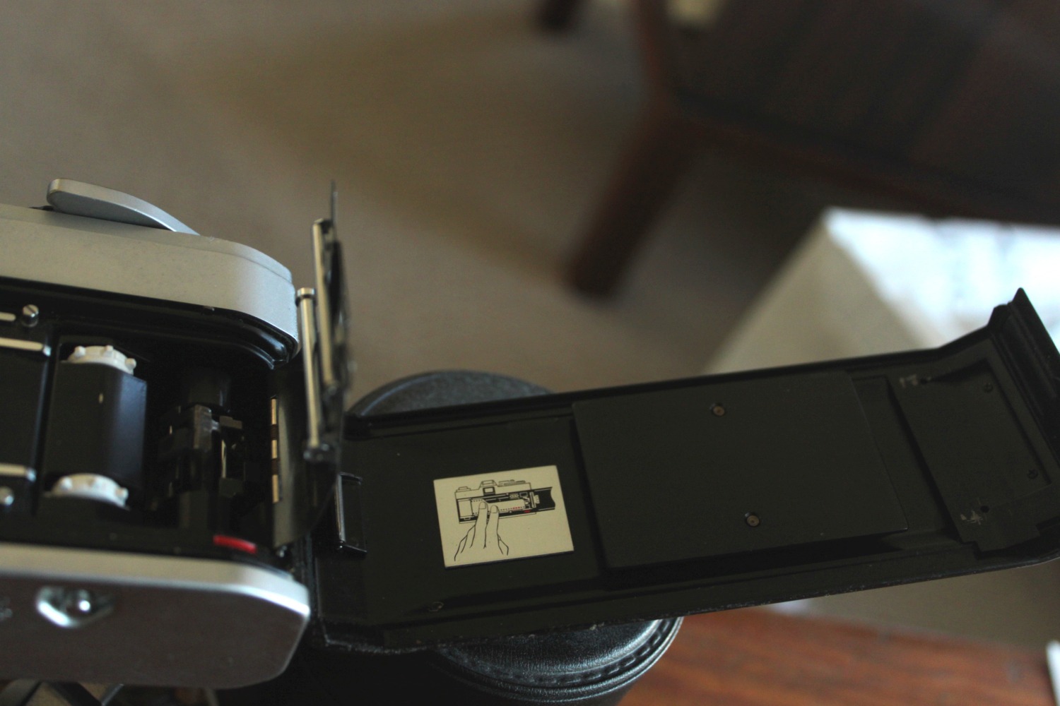

Yes, I have shot several rolls with the ftb. The sprocketed shaft is only used for alignment. I just align the film along the silver guides and tape directly onto the uptake spool. When rewinding you do feel resistance that tells you when to stop.
My camera was empty, I had a roll, so took a pic for you:
https://imgur.com/a/7rr8Dq1
