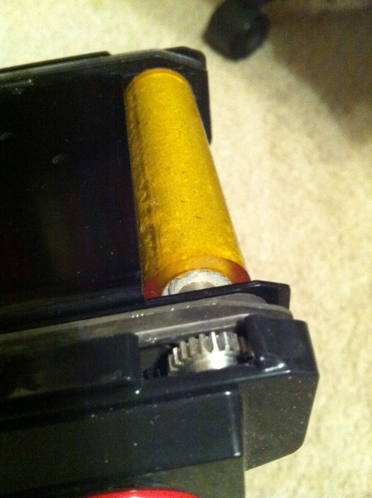

Also, the unperf often goes to a graflock setup with rubber rollers, you could replace the rollers?
Here I have one so I took pics...
It's kind of the same material as that "shticky" lint roller device on late night "as seen on TV" adds.
I'm sure you could find one and replace the roller on the perforated gear side and then it would work for both perf and unperf film?
Sorry if that's not helpful.
I would just test it, I mean you sound like you have a lot just run through 2-3 feet of images and see if there's any issue with frame spacing or advancing. I don't think it would damage the gear just maybe cause the film in one corner to not be as flat?
