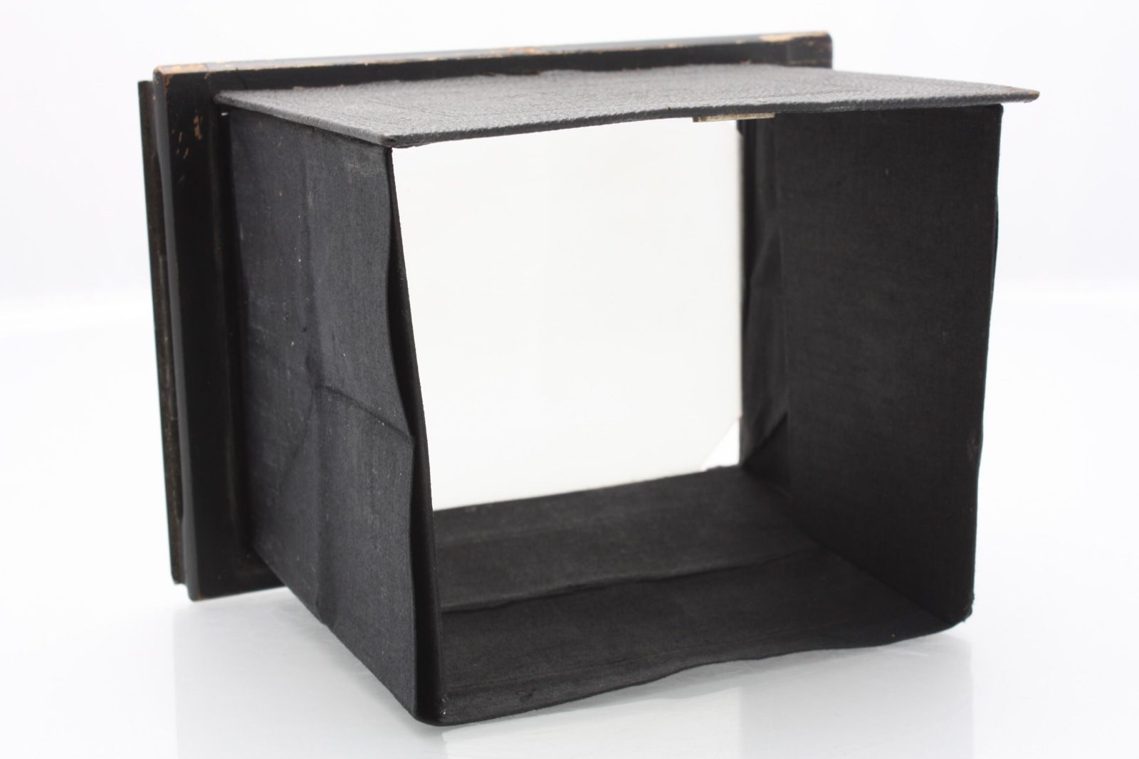

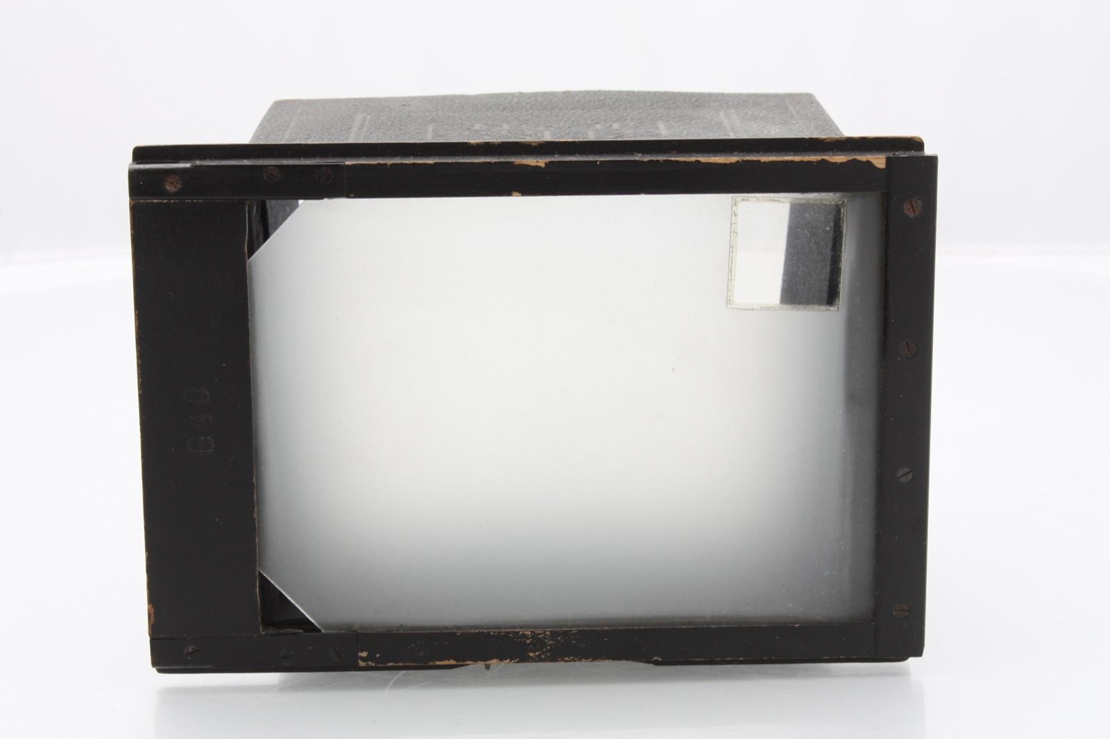

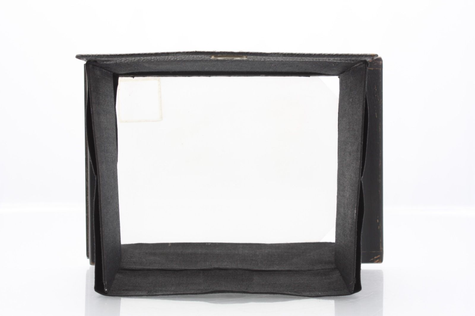

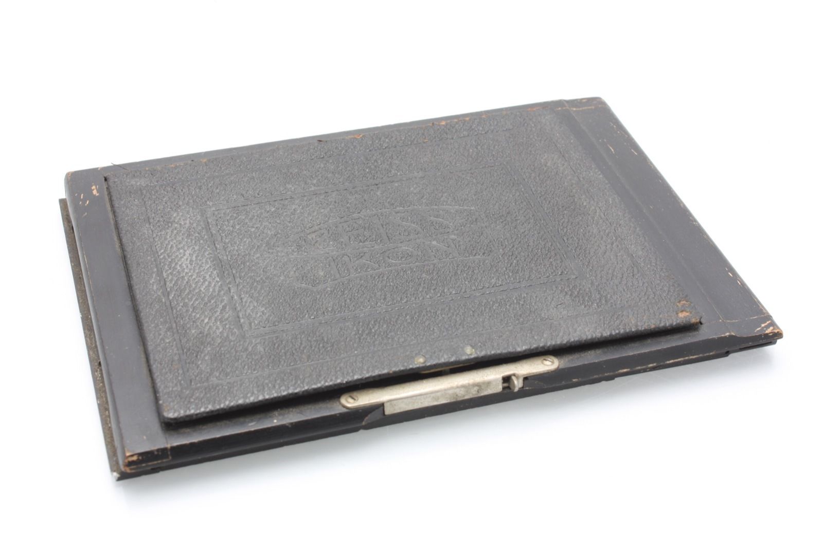

Hello,
I recently purchased a Zeiss Ikon 9 x 12 GG back that I thought would fit my Maximar B model 207/7.

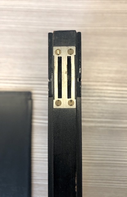

Unfortunately the back did not fit the Maximar. For those that own one you know that the GG back, plate holders etc slide in and are held in place by the metal grooved sides.
This Zeiss Ikon back has a wood frame, fold-out hood and different edge configuration. I'll post some photos now.
Anyone have an idea of what Zeiss Ikon camera it might fit?
Thanks,

The problem is that after the merger of Zeiss, Contessa Nettel, Goerz, Erneman, ICA etc in 1927 the factories continued making some of the same models but badged as Zeiss Ikon before Zeiss did some serious restructuring. They did actually publish some images in a catalogue of the different edge fittings, I have the images them somewhere but I'm in the middle of moving house so may take a while to find.

This is a temporary file, translated from Swedish and reworked. It gives an idea of the edges of plate holders, I have a second one and possibly another plus a lot of plate holders -some marked by the manufacturers.
Hope it helps. Essentially you have a focus screen holder / back that also fits a pre Zeiss Ikon camera and the model continued under ZI, many were dropped within 2 to 3 years.

Ian, thanks for posting the image of the plate holder edges. I didn't realize the variety of plate holders under Zeiss Ikon.
I'll have to post some better photos of the edges on the GG frame to see what matches.
apkujeong
Jul 13, 2007
166
Looks very much like a back for a 9x12 Ideal, it'd also fit a 9x12 Juwel. The G40 stamp seems common on backs for those cameras.

I want to thank apkujeong for identifying the Zeiss Ikon GG back to a 9 x 12 Ideal and a 9 x 12 Juwel.
Now to find either an Ideal or a Juwel camera body to match it.
Update 3/2019: The Ideal 9x12 and the Juwel 9x12 backs are not the same size and do not interchange!

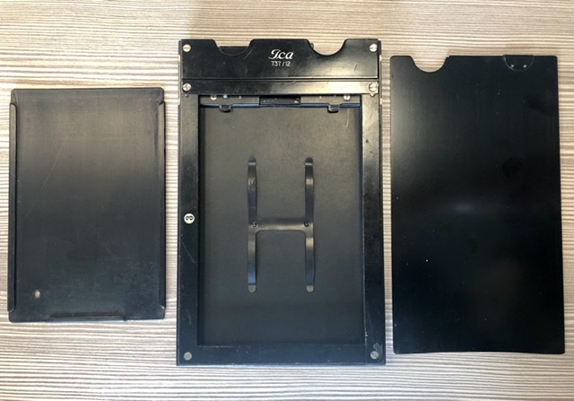

Ica and later Zeiss Ikon camera's came with two basic plateholder configurations: the ones that were made to 'slide in' in German called 'Kassetten zum einschieben' and the ones made to 'clamp on / pop off' in German called 'Kassetten zum anlegen'. Only the more luxury models had the 'Kassetten zum einlegen', since they could also be used in for instance very cold (freezing) weather and because when used it makes the camera less vibrate. Btw a G19 back is a 'slide in' back for 9 x 12 which sits on my Ica reflex camera; not sure if it would fit the Maximar.
Here's a page from the Ica catalogue with the different 'Kassetten':
ICA / Zeiss Ikon Favorit
by Ron (Netherlands), on Flickr

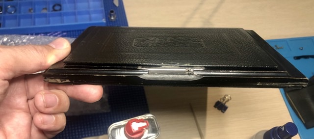

I think it’s from Ideal, at least my 10x15 Ideal has this GG
Hi Alex, If I'm correct the 10x15 Ideal had a clamp on/pop off back, just like its 9x12 brother - the Ideal was considered more luxury than the Maximar which had a slide-in back and plates. The slide-in backs and plates were prone to difficult handling during winter (and in the tropics).

Here's another pictures with different plates from the ICA catalogue, also used for older type of German cameras. The ones shown on the bottom are the slide-in plates (einschieben Kassetten):

Alex Varas
Mar 24, 2018
817
Bilbao
Thanks for checking.
My one has the GG as the upper left photo meanwhile a friend has a Juwel 13x18 with the ground glass as the upper right.
