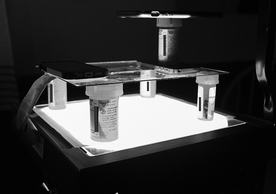

Oh and here is my ultra professional lightbox, iphones and an old projector!
