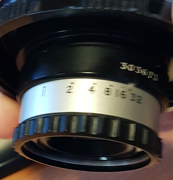

Hi Forum ,
When I bought my Vivitar Vi enlarger I also received an enlarger lens. The Lens is on a holder box that says minolta , but the lens itself does not have any brand , mm, or any other information.
Strangely (at least for me) is that the aperture values are 1,2,4,8,16,32
Any information would be most welcomed, See also the Screenshot ...
thx

It is an arithmetical scale with the figures representing x -1 .
Thus 1 , 1/2 , 1/4 ...
Such scale is more intuitive for a beginner.

I found at least two different Wray lenses with such scaling.
51mm and 108mm

I will go along with a Wray lens. I had a 50/4.5 when I first started out with developing and enlarging and I still have the original box whit curiously enough almost the same image as yours. It was a mediocre lens (actually awful) and soon replaced.
As I said, I guess it were only triplet lenses that got this type of scale.
Ross and Taylor Hobson used this aperture scale, probably other British ELs too.
Yes my Dallmeyer 6" f4.5 Dallcoated enlarger lens uses the same scale, as does another Supar. It makes sense as you really don't need a conventionally marked on an enlarger lens but you do need a scale for relative exposure. aperture.

Not the same. Leitz Varob:
1 2 3 4 6 10
