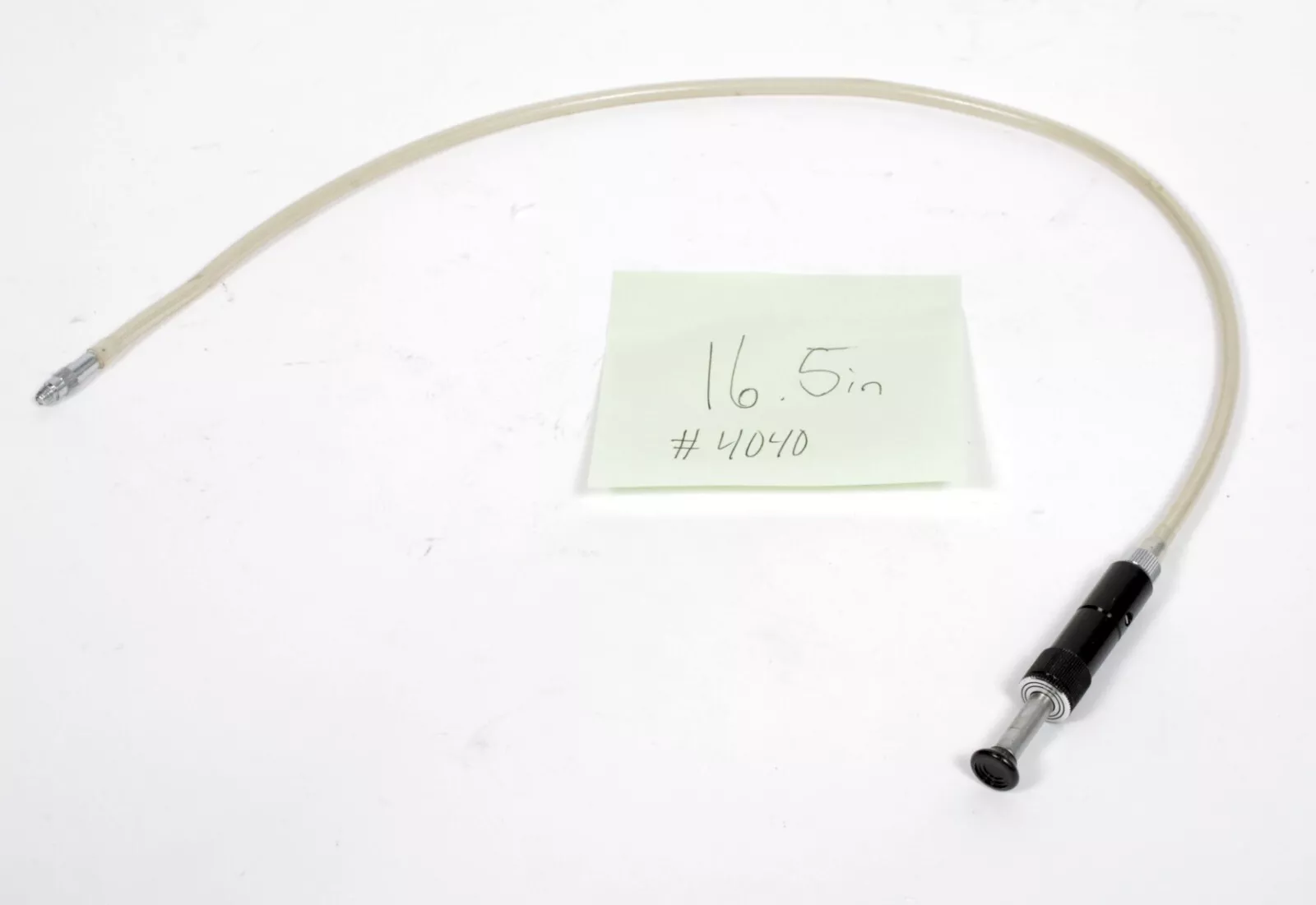

I found a decent picture of the Linhof release that accompanies the anatomical grip. You are right, no threads. It is a slightly different animal from "normal" cable releases though.
Image credit goes to the Catlabs/Jobo Outlet ebay listing team.
