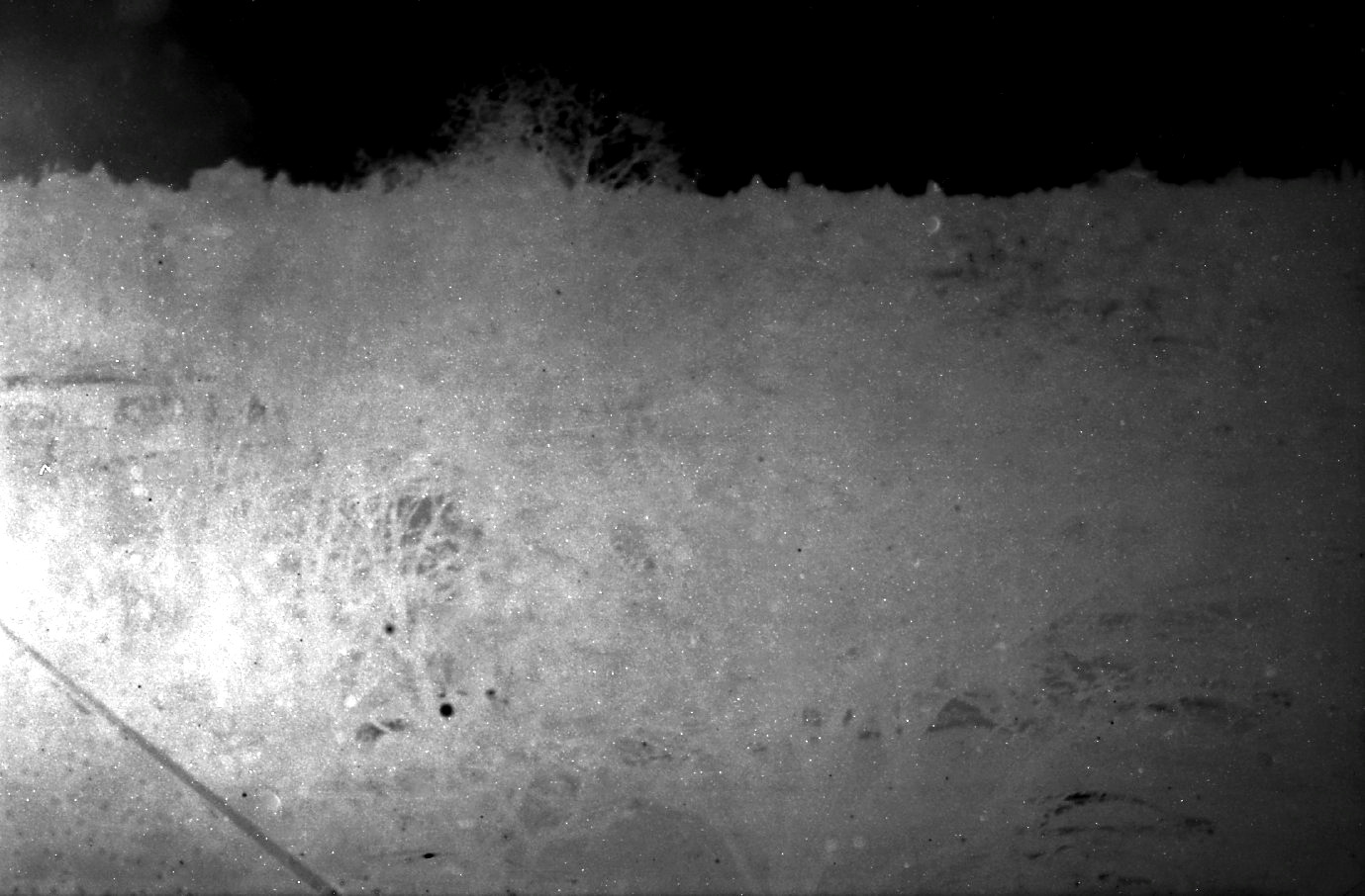

Success.? First sort of result from the strange orange film. I developed it in Ilford Multigrade paper developer. 2 minutes this time and it is definitely a positive film that will require a bit longer exposure time but at least I have something to start with no matter how bad it really is. I was careless with the film after developing it as I thought it was totally blank but after drying, I could see something there so I tried to save it but it is still noisy.
Congratulations to you
I hope you can find out the identity of that movie and then use it
It might be a microfilm
