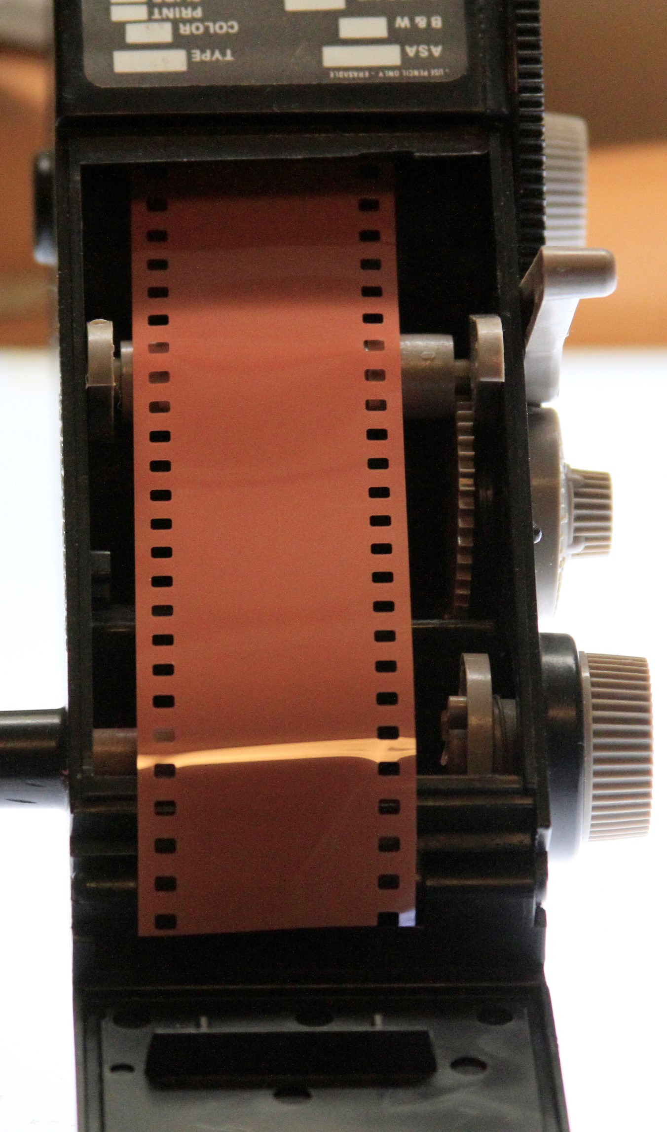

Swap meet in Vancouver. Picked up a few lenses I didn't know I needed but also bought a bulk film loader that already had film in it. Does anyone know what this film might be.? I know I can expose some and then develop in Rodinal but someone else may use this film. I tried Googling orange film but was unsuccessful so far.

It's shiny and pink on the emulsion side and it is also very thin. I'll just shoot a few frames and then dev. C-41 that was recommended elsewhere. Feels like there is a fair amount in there so it's worth the gamble.

The best plan is to load 12 inches into a camera, take six shots at iso 3, 6, 12, 25, 50, 100, develop the strip in d76 straight for 8 minutes, see what you get. There may be no edge markings. If it's colour film, it'll still be brown when developed. If it's b&w, you'll get an idea of a speed.

Are those motion picture or still film sprockets?

Very orange and a bit see through: ortho litho.
Otherwise; color c41

FWIW, the film doesn't look orange on my screen. Do you have any identified film that you could photograph beside it, for comparison purposes? Something like unidentified film on the left, and TriX on the right?
They are the KS sprockets and definitely bright orange as the camera I used doesn't show colour properly as you can't expect much from a digital camera. ;o) Also the emulsion side is pink and it's not very thick but I am glad I had sharp scissors with me.

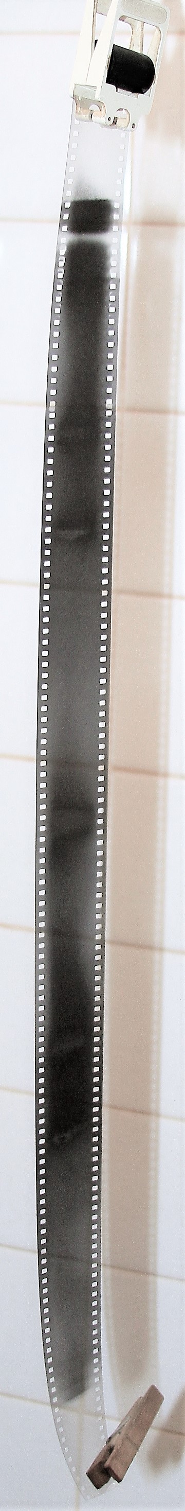

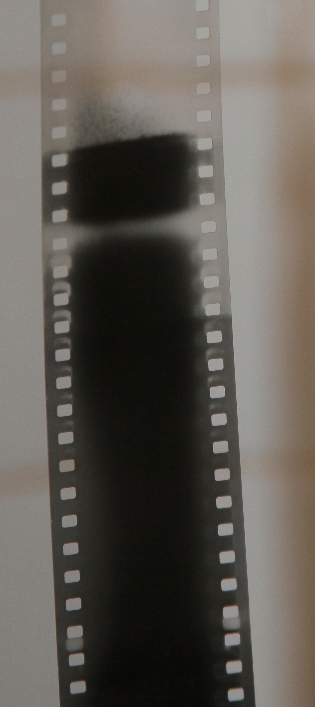

Well I shot it at 26 and developed in ID-11 for 7 min @ 21C but nothing was there except for some strange results. The film is not colour as it was clear on top, bottom, and black in between so I also know it hasn't been destroyed by light. No edge markings at all along the length. I scanned it anyway to see what was there but nothing really. Next time a short roll at 6 & up for the next test. Was using my Olympus OM 4 T and the lowest on that camera was 26. My F1N goes to 6.

Ortholitho

Developed completely clear at the ends that were fully exposed to light....
I also just went and cut a piece from one of the spools I have. Precision Line Duplicating Film is what it's called. It makes direct positives but is very difficult to expose correctly. Brownish-orange back, pink and shiny emulsion, almost transparent. I never looked at it in daylight before. It can be handled under a safelight.

Then it needs to be developed with positive developer, like Dektol. For your next test Dennis, go even lower than 6 iso, just open one and two stops from it.
OK thanks. I have had very few responses, but this sounds the most promising. I shot a roll yesterday and started at 6 as this is the lowest I can go with my F1 N. I guess I cannot over develop the film using Dektol so probably 10 minutes should be enough. I need to find out what it is as I never throw away film unless I know it is completely ruined as it feels like there is plenty of film still left in the winder.

I have mostly used this film to copy negatives to boost contrast and gain a bit of density. I've also used those negatives stacked for interesting (if pointless) effects. I have used it in-camera. I put a picture on instagram that I took using a 600 watt bulb....
Any film developer (other than lith developer) will give you continuous tone on graphic arts film. Dilute Dektol is typically used because graphic arts film can normally be handled under safelight - and people with safelights tend to be people with darkrooms that make prints.
