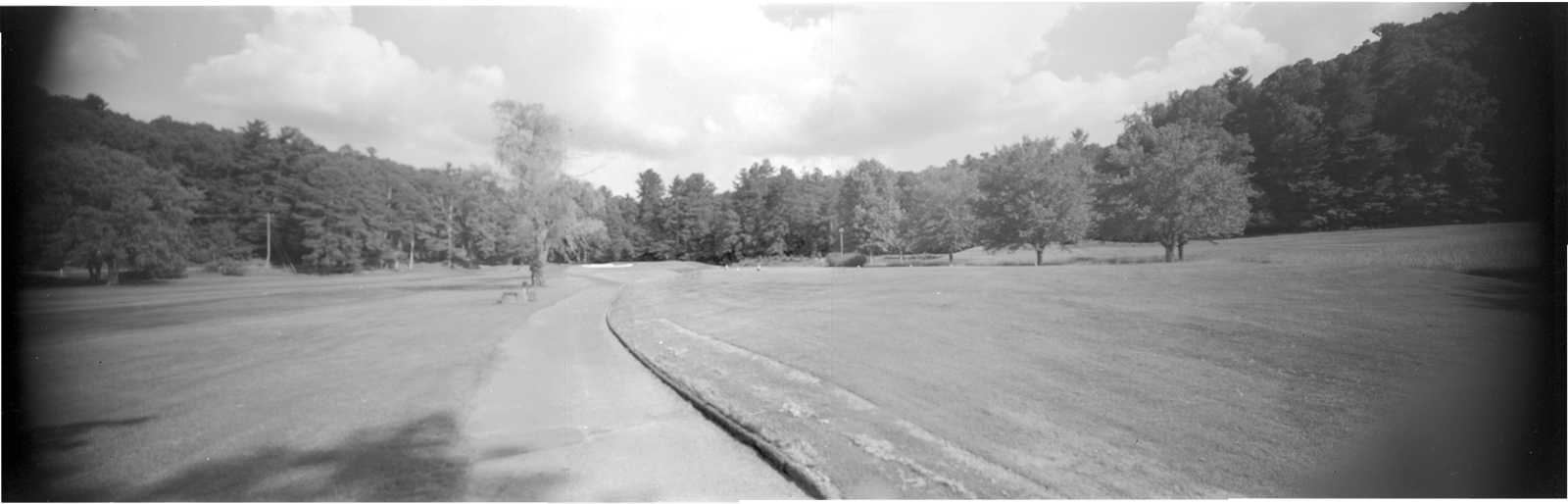

Having recently come into possession of an old 6x17 rig, I set about acquiring a lens to use with it. As I wanted images to be properly panoramic, I wanted a wide-angle lens, and I tried to read up on the alternatives. One lens that seemed promising was the Schneider Angulon 65/5.6; one site listed its image circle as being in excess of 175mm, and the Malefic website clearly lists it as being one of the lenses that will cover 6x17:
https://www.maleficcameras.com/usable-lens
So I acquired one and fitted it to my camera. But I was in for a rude surprise:
The image circle I measure on this negative could charitably be said to be 165mm at maximum extent, and if one excludes degraded margins and clipped corners the practical number is more like 155mm (and worse if you try to mount a filter.) WTF?!
(and before you ask, there is nothing in the camera itself that could obviously truncate the image in this manner.)
I would dearly like to know how there could be such a discrepancy between what I read and what I observe. Are there multiple versions of this lens, and did I get the wrong one? It would be nice to know so I do not get burned like this in the future.

The image circle I measure on this negative could charitably be said to be 165mm at maximum extent, and if one excludes degraded margins and clipped corners the practical number is more like 155mm.
The nominal image circle for the Super-Angulon 5.6 is 170mm.
The Image circle for an Angulon 5.6 would be lesser. BUT a Angulon 5.6 seemingly did not exist, but only a 6.8.
OP, Schneider claims the 65/5.6 SA covers 135 mm @ f/5.6 and 170 mm @ f/22. 6x17's diagonal is 180 mm. I don't know what aperture you used when you took the shot, but you shouldn't expect the lens to cover 6x17 at any aperture.
You lost more image on the right side of the scan than on the left. Check that the lens is centered on the camera's gate.
Also, the scan you posted is horribly soft. Look at the negative. If it isn't sharp -- scans are sometimes softer than the image scanned -- you have a problem focusing or your lens has a problem.
-The scan was done in a hurry and is a bit off-center. I don't blame that on the camera. The gate boundaries are pretty hard to see on the film. I had to scan this in 3 passes with photomerge due to the limited carriage travel on my better scanner.
-The exposure was at f/11.
--Yes, the image is a tad out of focus, but it was just a practice shot and that is irrelevant to the matter at hand. The camera is quite challenging to focus, especially in bright light, as the focusing screen is on the dim side and in bright daylight only a tiny image patch at the center is actually visible even with the lens wide open.

- you have a Super Angulon 65/5.6 presumably. There is an older lens called an Angulon 65/6.8 that covers only 6x9. I mention this just to say that talking about "Schneider Angulon" will lead to confusion.
- the diagonal of 6x17cm is about 178-180mm. The lens may not be rated to cover 180mm at all, and if you want to cover 170mm you may need to stop down all the way to f/22. f/11 isn't far enough. At the extremes of coverage, there is usually a lot of vignetting of the aperture.
- trying to cover 178mm with a 65mm lens, you are asking the lens to have a coverage angle of almost 108 degrees. That means there is going to be a lot of light falloff. This is basically geometrical and only a little of it can be mitigated by lens design. So one has to either accept vignetting or enter the often complex and expensive world of center filters.
So it's not just about finding a reliable table of lens coverages, but understanding the challenges of extreme wide angles in rectilinear lenses. These challenges are moderated if, roughly speaking, you try to work with about 90 degrees of coverage, which means the lens focal length is half the diagonal of the film (that would be ~75mm on 4x5, or 90mm on 6x17).
If that shot were focused properly, I'd be quite pleased with it as it is (with a little cropping, of course).
My Schneider data sheet states 170mm from f/16 onwards (so these data can be taken with a tiny bit of salt)
The problem though is that the OP has it about the Angulon, not the Super-Angulon. But I guess he just mixed them up.

Thank you! That is exactly the kind of information I was seeking, more detailed than what I had. Knowing what I know now, a lens should probably have a nominal image circle of at least 195mm to be even marginally suitable, and preferably 210mm or greater to be comfortably usable at all apertures. That might put such lenses as the Grandagon 75/4.5 in play, but it looks like no 65mm lens is really going to cut it.The Schneider 72/5.6 is likely too rare and expensive for my purposes.
