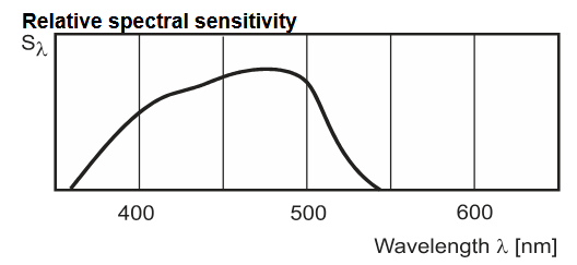

The spectral sensitivity is for this paper is explicitly included in its product datasheet:
As you can see, there's (virtually) no sensitivity beyond 550nm.

It will perform no better than a red safelight, but given the difference in human spectral sensitivity, it may appear brighter at the same absolute brightness as the red light, so you may be able to get away with less light. However, since you also are more likely to hit some of the wavelengths the paper has some trailing sensitivity to, the net effect can still be that you increase problems instead of reduce them.
The TL;DR is that a red safelight works perfectly fine for this paper and the cause of your fogging will likely have to be found elsewhere, assuming that the red safelight really only emits red light. What kind of light is it? Is it an LED-based source or a white light with a red filter?
