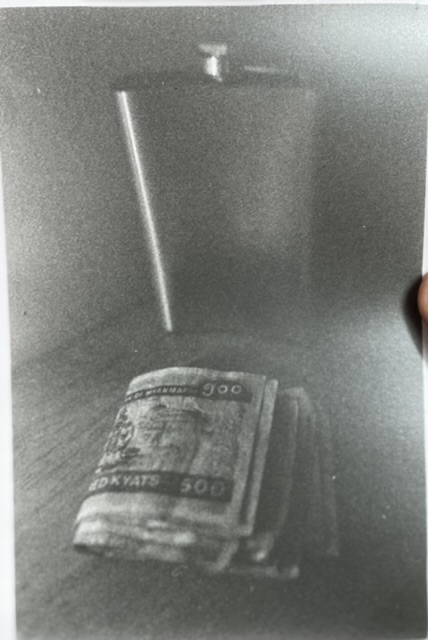

Kuortam
Jul 8, 2021
9
Yangon
Thanks Kino,
That makes sense - You’re absolutely right, I did try a test print (attached) - Muddy but not uninteresting :smile:
