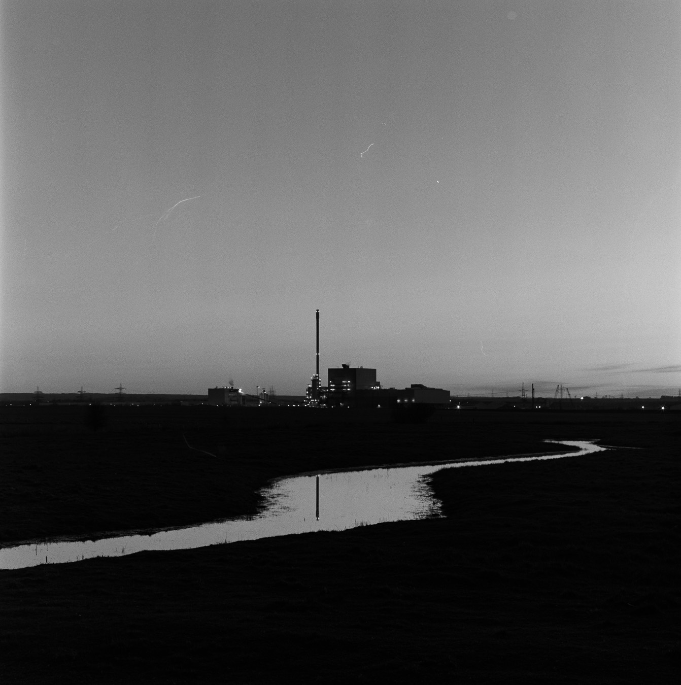

Thanks in advance for your advice here. Photo attached taken on a Hasselblad where you can see the pale edges and lines running vertically. Agitation is twist and turn for the first 30 secs then 10 secs every minute. I use more developer than required so it is well convered.

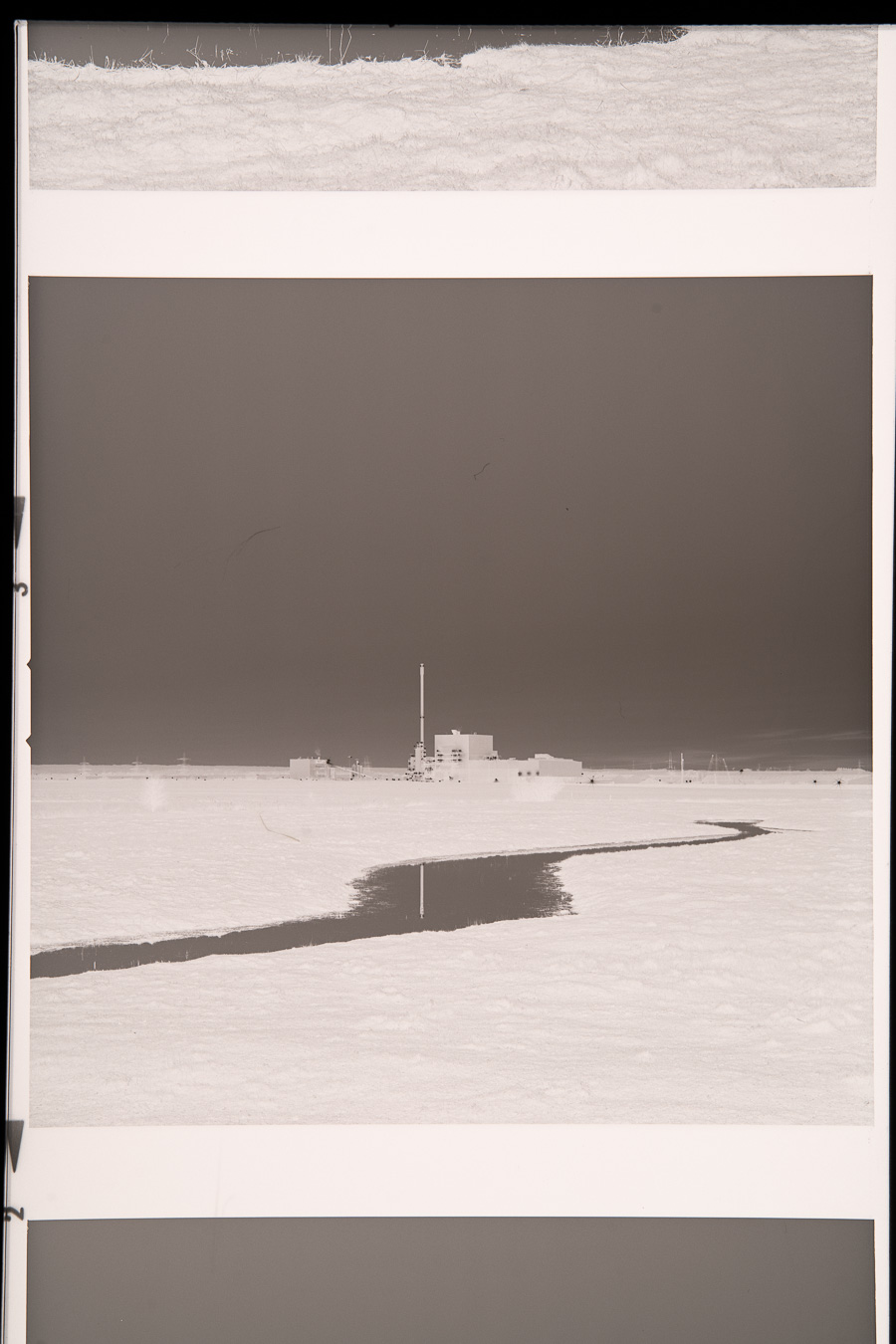

May we please see a backlit photo of the negatives, showing the rebates and the space between the frames.
That being said, it sounds like the sort of problem that often arises from using twist and turn agitation only, and not adding either inversion or continuous rotary agitation to the process.
What sort of tanks and reels are you using?
Thank you so much for your input. It doesn't appear on all frames, perhaps half. Paterson.

I take it that the lighter sky on the right as we look at it, is not simply the fact that that section of the sky was in fact lighter as might be the case if the sun is setting in that area of the sky?
If this shot had been in the gallery I am not sure I'd have thought it strange that the right part of the sky was lighter. I'd have assumed what I said above

It may be that the sky was lit in an uneven manner when you took the pic. I have to pay a lot more attention to things like this if there's a lot of sky in the shot w/ B&W film. Some nice fluffy clouds can be your friends when it comes to skies.

Pale strip also on the left. Appreciate your input. Thank you.

It was almost dark. The sun had set a good 20 minutes previously. Pale strips both on the left and right of the neg.
Did you, per chance, have a polarizing filter on the camera?

We seem to have become fixated on agitation as being the cause and a change to that as being the solution but I have never seen Canis' problems on my negs in 18 years of development and my regime is close enough to his to have brought about something similar in those 18 years
So is it time we examined other causes? What those might be remains a "head scratcher " for me I admit This one gives me the same depressing feeling in terms of finding a cause as did vania's and logan2z
So a few more questions:Canis, have you experienced this problem with this Hasselblad before?
If not what if anything was different on this occasion in terms of film, developer etc?

The streaks appear too linear and regular for an agitation issue.
