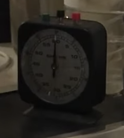

On the same note, about John Finch videos, does anybody know where to buy this darkroom timer I saw in his video?
If you drop him an email at pictorialplanet@gmail.com he'll probably reply. I recently asked him a question via email and he responded quickly.
Edit: It looks to be the one described here:
pentaxuser
May 9, 2005
20,335
Daventry, No
These clockwork darkroom-timers come up on a reasonably regular basis on the U.K. e-bay. They were made in their tens, may be hundreds of thousands or millions in the 1950-60s but of those that survive they are getting old now. Most are well used so be aware of that and finding anyone now who knows how to repair them if they go wrong can be difficult and this expensive
If you find one even of the outside looks good, I'd ask about it age and use. Occasionally one will come up that has hardly been used. If this is the case they will not be cheap but are likely to be worth it for reliability
I see no reason why they should not appear on other countries' e-bay sites as well
I've got one surplus to requirements tht you can have if you will pay shipping. DM me if interested and I'll send you photos. May take a few days, as I'm just heading off on hols.

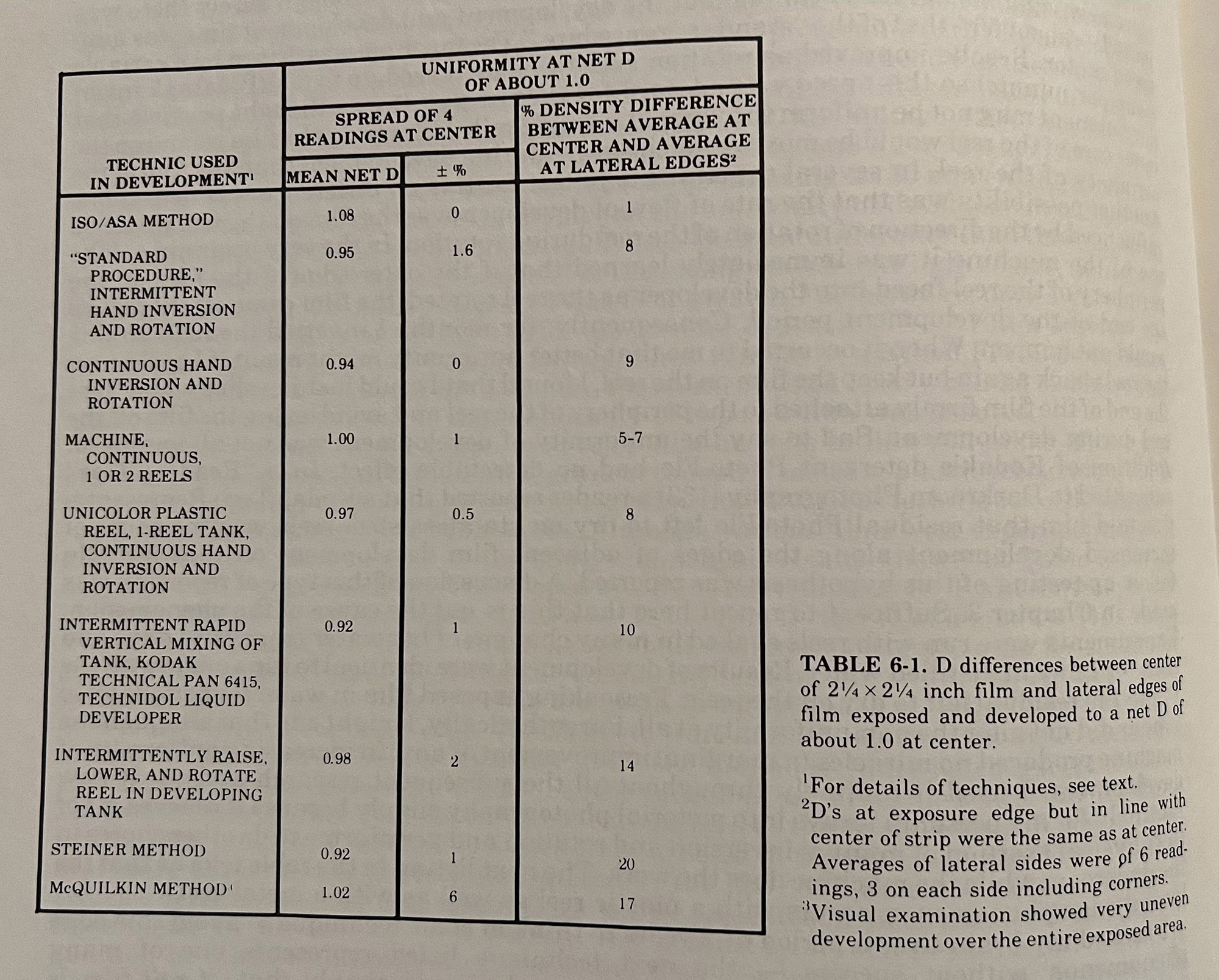

Richard J. Henry in 2nd edition of Controls in B&W photography wrote about univenes od film development. Unfortunately he mostly used 6x6/120 as base of most of his experiments. To fix non uniformity he even made his own motorised processing rig but never show the drawing or photograph of it.
And what is unfortunate about the 6x6/120 film base? Mamiya, Rollei and Hasselblad would disagree with that observation.

Nothing, but it allows people to try and hand-wringingly wriggle their way past Henry's conclusions rather than getting their processes under baseline control.
According to the table, the "ISO/ASA METHOD" is much better than all others.
What is that method?
