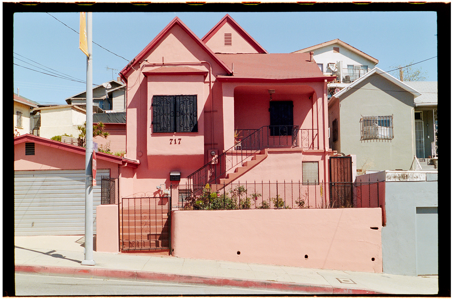

For what it's worth I get decent C-41 development doing either 5x 35mm rolls or 6x 120 rolls in a Jobo 1526 using Kodak Flexicolor chemistry. I use 600ml of chemistry because it's easier to measure than 570ml. I don't get any streaks or blemishes. Here's an untouched scan that has an even blue sky at the top and a pretty simple street/sidewalk at the bottom. Neither area shows the dreaded road rut/uneven density that I experienced processing black and white in the same tank.

Ah, I see that the Multitank 5 does suggest 330ml for 3x 120 (1 per each roll). I didn't catch that in my post above. Using 500ml should be more than adequate. I'm not sure how to help, sorry! Do your results look similar to my B&W uneven density in my original posts?

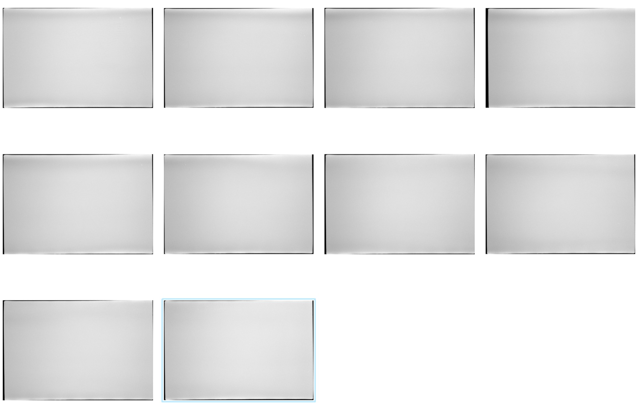

When I look at the photo of your nearly blank negatives, I see un-evenness that, at least in par could only reasonably result from un-evenness of exposure.
This is the photo I mean:
Note that the vertical areas of reduced density are adjacent to the space between the frames, and only there - not repeated anywhere in the middle of the frames.
I don't believe that is un-evenness which is development related, because I don't believe that there is any way that flow of developer could be affected by the location of the space between the frame.
I agree that the artifacts along the top could be due to development issues, but I find the narrow line along the top edge of the rebate to be interesting. That looks to me to be either an un-fixed area, or an area that has been light struck.

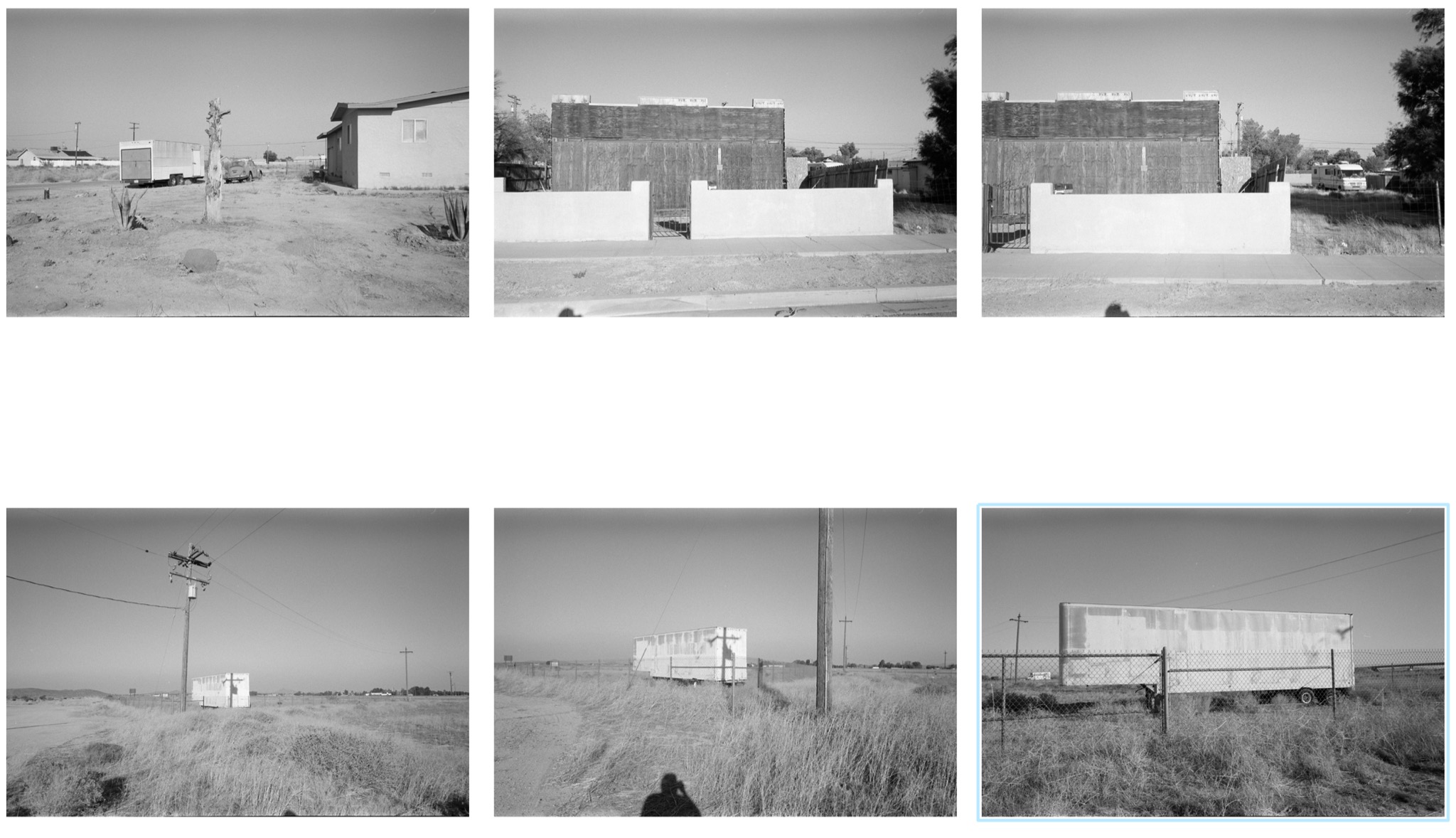

Hi, and apologies for opening another "uneven development" thread. I have searched through tons of posts, but haven't been able to find a fix.
I recently purchased a Jobo CPE-3 + Lift kit with a 1520 tank. I have been getting really bad uneven development in any smooth toned areas of my image. I've attached a screenshot of images of a flat wall, and images from a roll out in the field where you can see how it affects the sky.
Here’s more info about the equipment and process:
Brand new 1520 tank, CPE-3 processor and Lift
Tried both plastic reels and the Hewes stainless reels
Tried 35mm 400TX, HP5, and P3200TMZ
Tried freshly mixed XTOL 1-1, XTOL Straight, DD-X developers
Tried solution volumes of 300ml, 400ml, 500ml, 600ml (mixed to proper dilutions or used straight)
Tried with 5 min pre-wet, tried without pre-wet
68º for 6, 8, and 10 minutes
Processor and tank on the lift are level, rotating during the entire process
2 different changing bags
2 different cameras
And still the problem persists. Has anyone experienced this, and more importantly has anyone fixed it? I've invested a lot of cash into this thing and I'd really love to get it working properly.
Thanks for any help!View attachment 257787View attachment 257788
