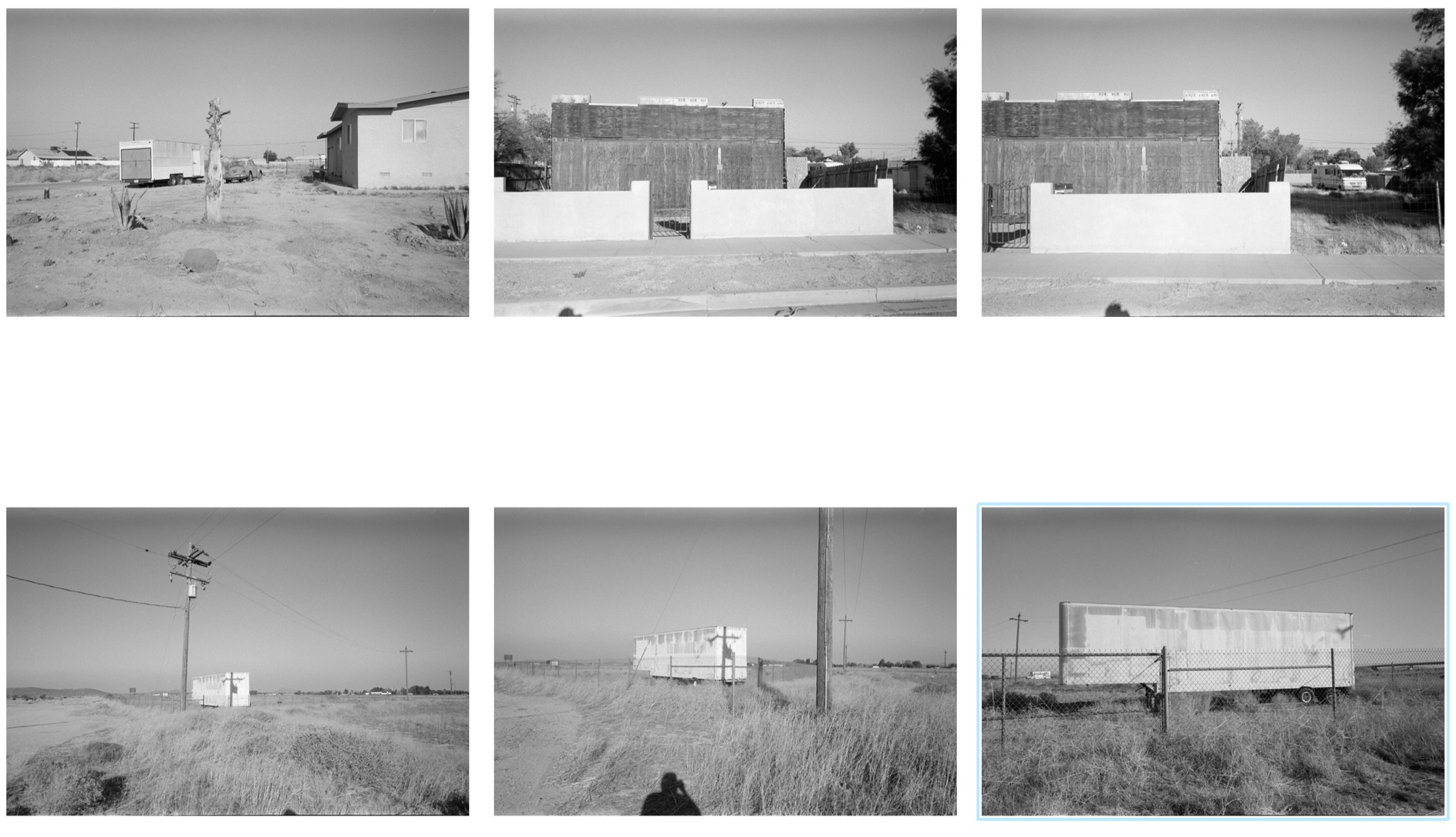

Hi, and apologies for opening another "uneven development" thread. I have searched through tons of posts, but haven't been able to find a fix.
I recently purchased a Jobo CPE-3 + Lift kit with a 1520 tank. I have been getting really bad uneven development in any smooth toned areas of my image. I've attached a screenshot of images of a flat wall, and images from a roll out in the field where you can see how it affects the sky.
Here’s more info about the equipment and process:
Brand new 1520 tank, CPE-3 processor and Lift
Tried both plastic reels and the Hewes stainless reels
Tried 35mm 400TX, HP5, and P3200TMZ
Tried freshly mixed XTOL 1-1, XTOL Straight, DD-X developers
Tried solution volumes of 300ml, 400ml, 500ml, 600ml (mixed to proper dilutions or used straight)
Tried with 5 min pre-wet, tried without pre-wet
68º for 6, 8, and 10 minutes
Processor and tank on the lift are level, rotating during the entire process
2 different changing bags
2 different cameras
And still the problem persists. Has anyone experienced this, and more importantly has anyone fixed it? I've invested a lot of cash into this thing and I'd really love to get it working properly.
Thanks for any help!

It's very strange. It seems like it goes over developed along the film border, and then under developed just on the inside of the frame. Notice the film border is black, then there's a lighter tone (high density) and then it goes to a darker tone (lower density), and then it evens out but still isn't perfect through the middle of the frame. I'm super confused.

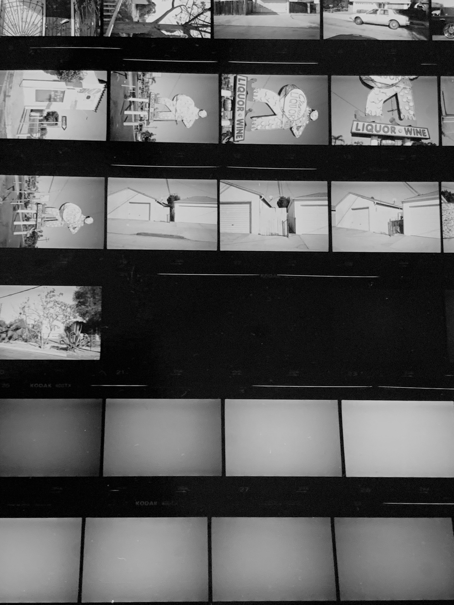

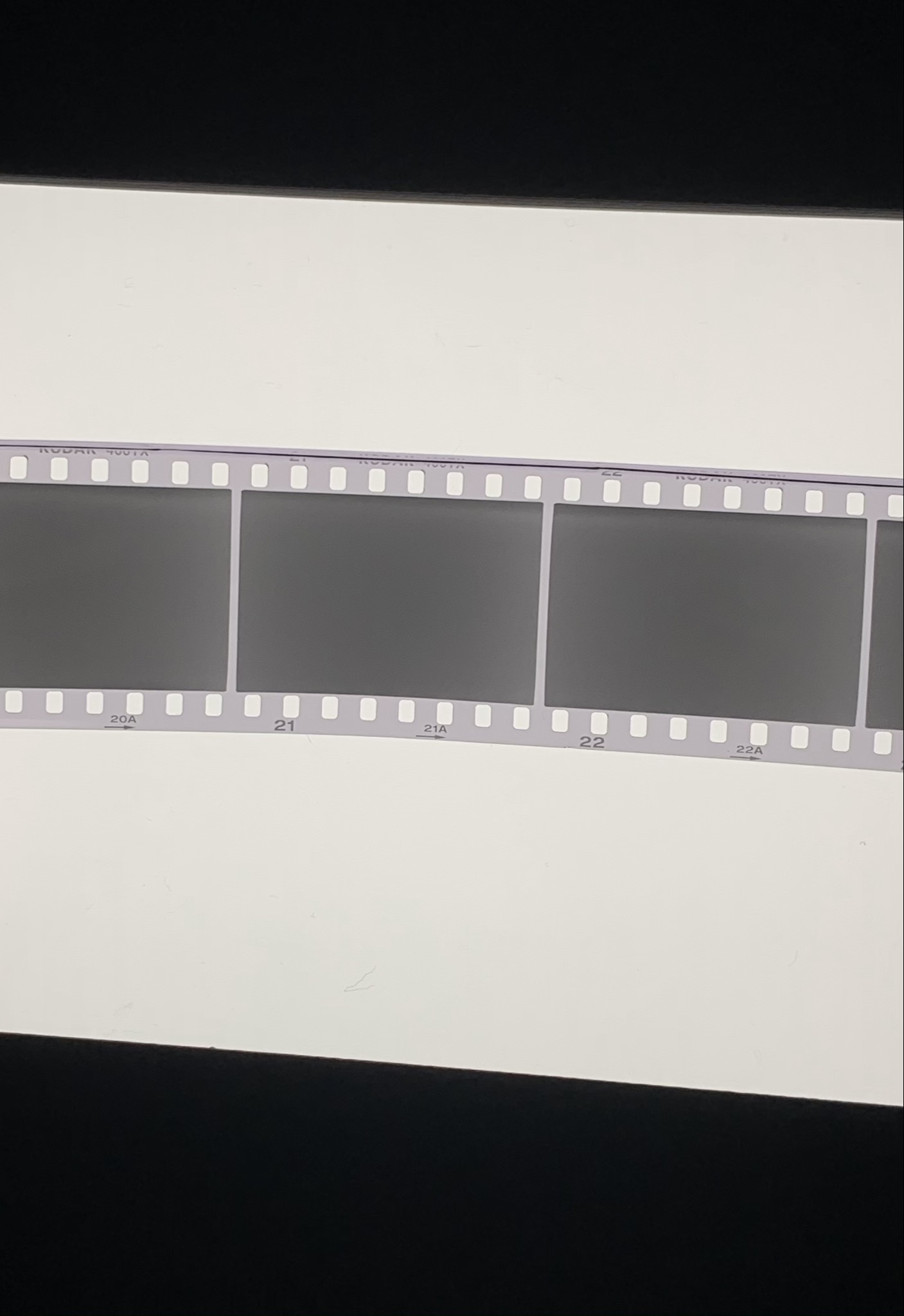

They are DSLR Camera scans in the original post, captured with a negative supply 35mm film carrier, processed in Capture One. I never had any issues like this before the Jobo, and my camera scanning setup hasn't changed.
Attached are iPhone grab shots of the negatives on a light table and a contact sheet printed in the darkroom. The unevenness appears in the darkroom which is the most worrisome part.
Also, I have tested it with my Leica M-A, a Leica M4-2, and a Canon EOS 3, so I'm positive it's not the film camera...

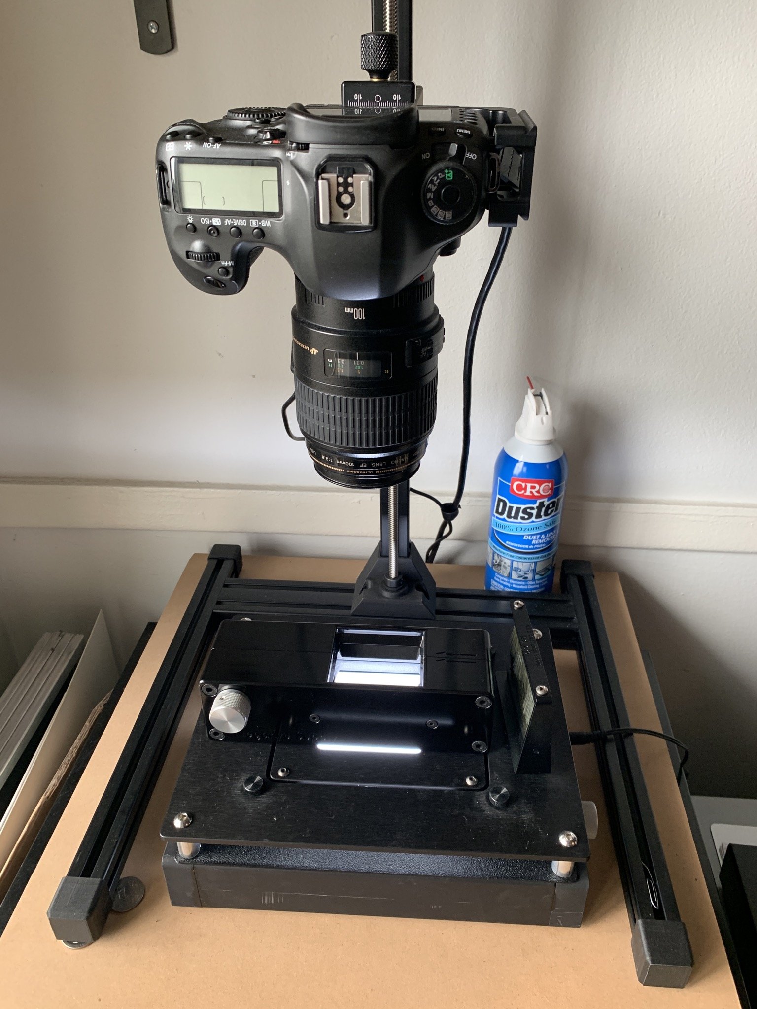

@xtol121 I am almost certain this is a scanning issue. I have the same Negative Supply film carrier, and I saw similar effects until I adjusted my light source (I had similar effect around the edges). How are you scanning it, i.e. what equipment is used, and can you show the photo of your setup?

@Bormental I wish it was a scanning issue, but if you look at the contact sheet in post #5 you can see it in the actual darkroom contact print. FWIW I have the complete Negative Supply kit with the riser, mount, light source, and film carriers. I scan rolls for other people developed at a film lab and those rolls do no exhibit that problem, and none of my rolls prior to using the jobo showed it either. Setup photo is attached, but the problem exists on the actual negative unfortunately...

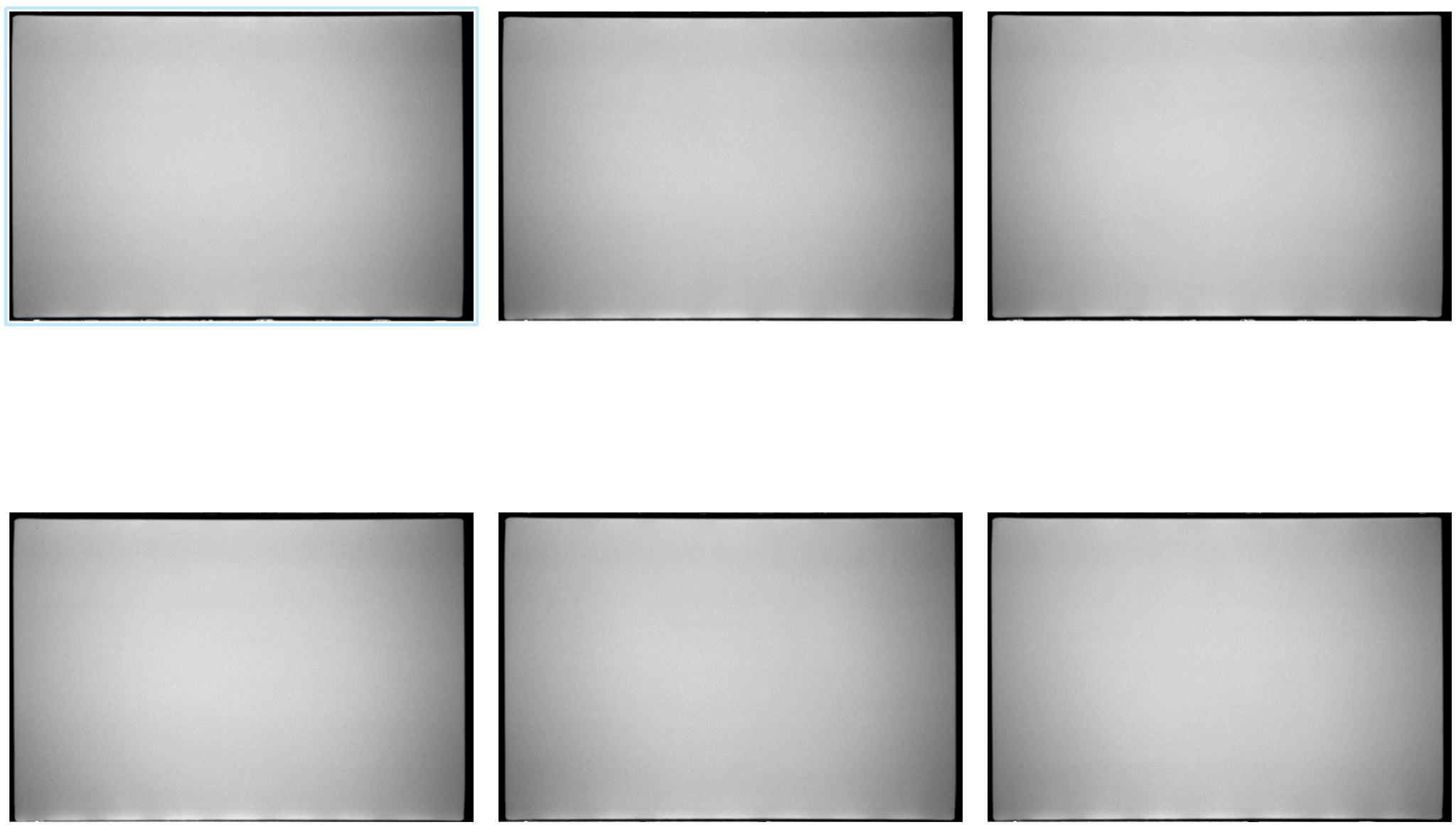

But, some good news! I was able to borrow a 2500 series tank and reel. I just gave it a whirl using 500ml of XTOL stock with a 35mm roll of 400TX and the results are encouraging. The strange +/- density issue seems to be fixed, but I have some sprocket hole surge instead... not sure if that's from just having 1 roll on 1 reel in a 2 reel tank. Any guesses?
The vignette in the attached file is probably from shooting at f2.8 on my 28mm Elmarit-M. Hoping to make a contact print later this weekend, but for now the scan makes me happy.
Again, thanks everyone for all of your help and suggestions!! I'll update this thread in a few days when I have some more conclusive test results. Hopefully I'll be able to borrow a different 1500 tank to try and find out if my original tank is just defective. TGIF!
