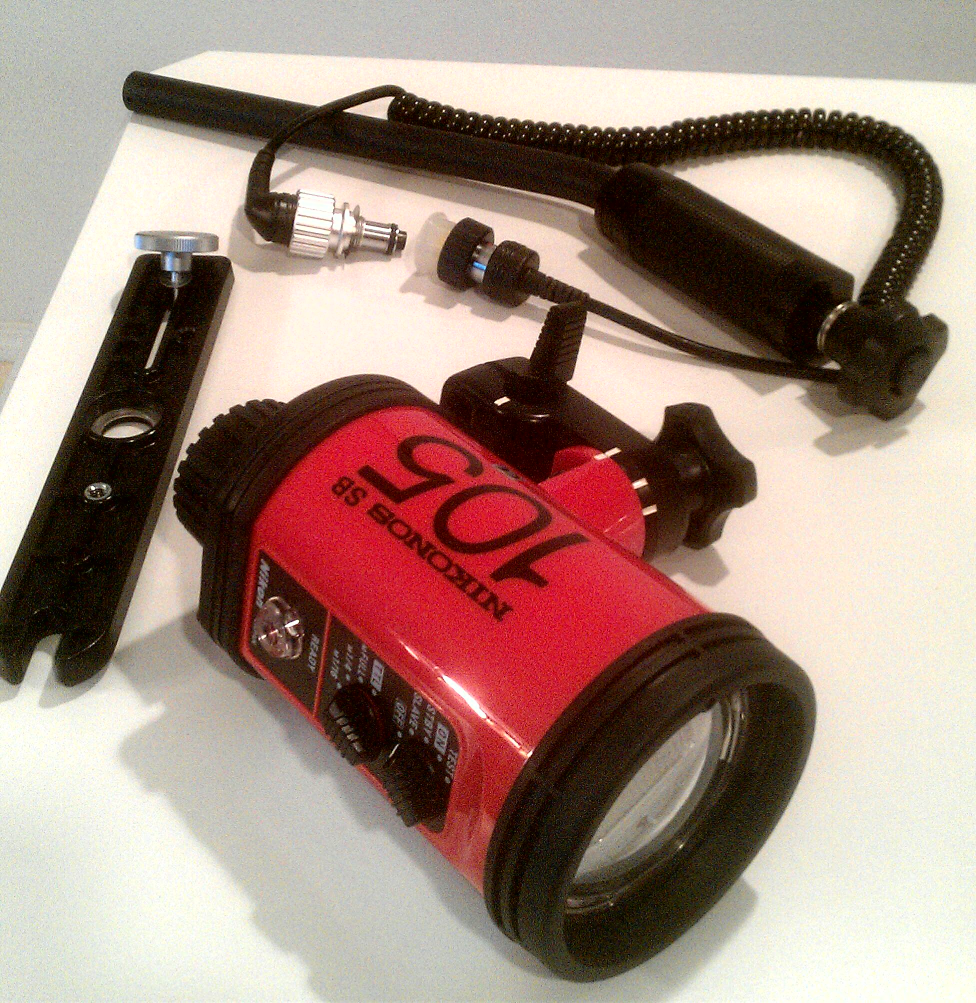

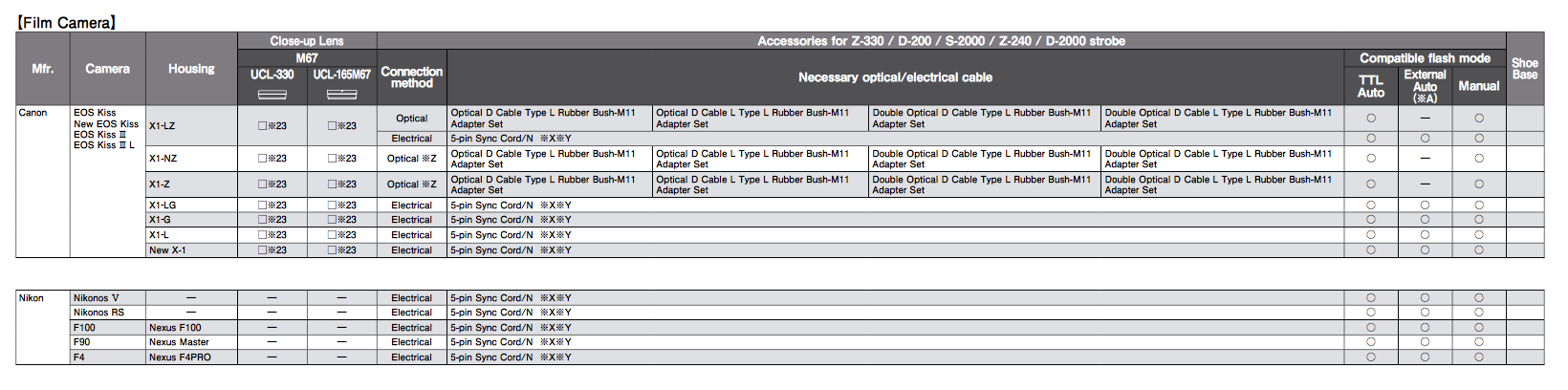

Since I have Nikonos your thread caused me to seek the solution to "does anyone make a contemporary NEW underwater flash for the Nikonos."
I found the answer. http://www.inon.jp makes NEW underwater speedlights that work with Nikonos film cameras! You might want to check it out too.

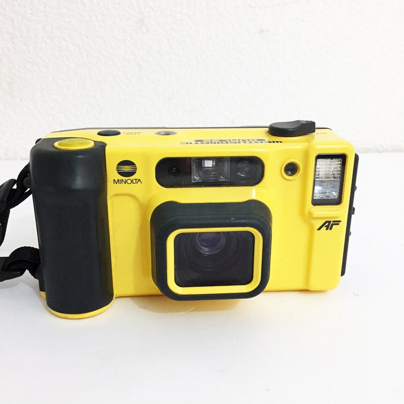

You ought be able to find a housing for a F100. On the cheap if your not going to dive too deep, Minolta Weathermatic, with built in 35 and 80mm lens, small flash as well. AF and auto advance, I dont recall how deep you can take, maybe 30 or so feet.

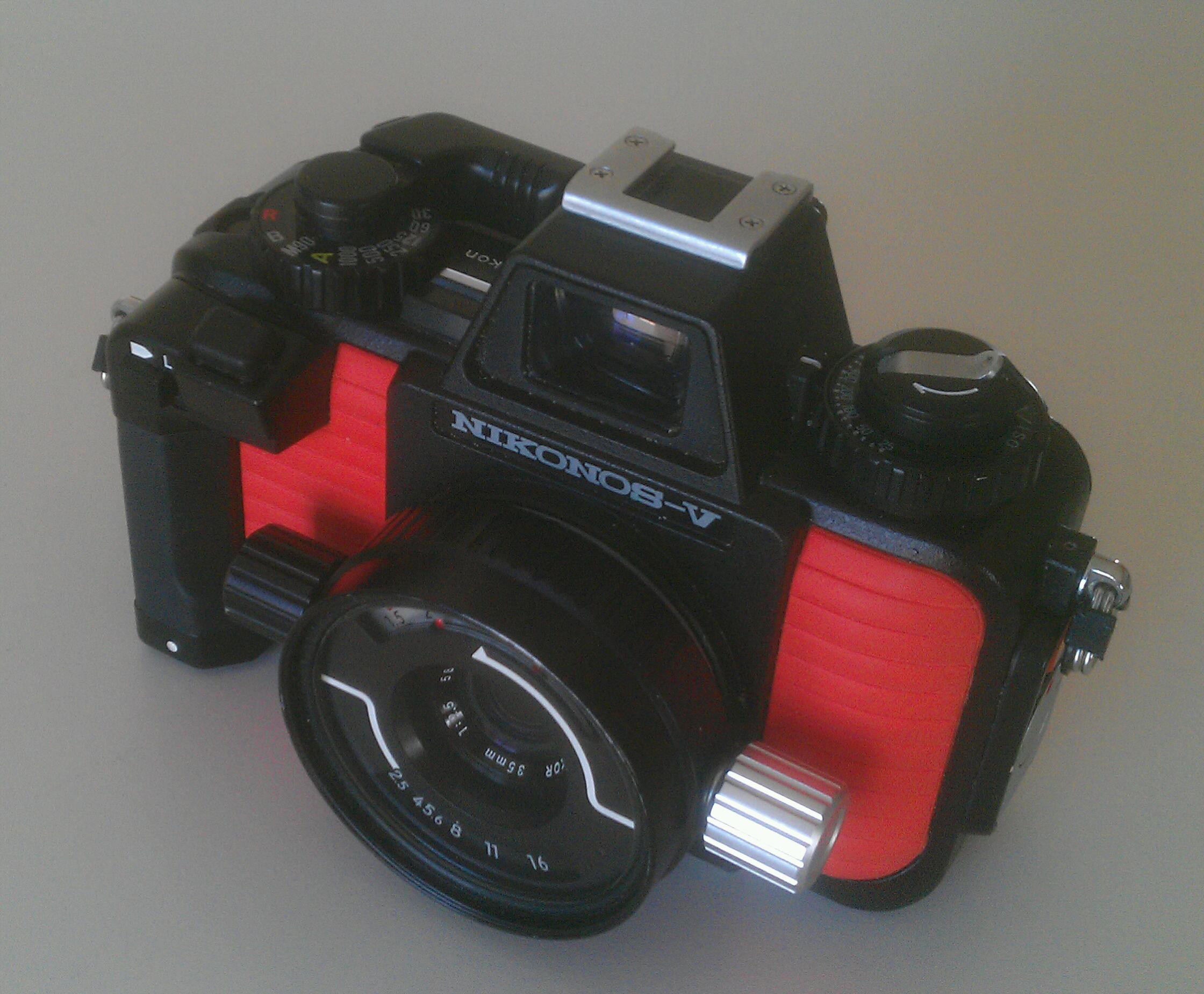

I'm not up on "current" UW film cameras. I bought a Nikonos II way back when they were still the latest, but I don't think I'd let it go underwater anymore. I would also be inclined to look for a Nikonos V, keeping in mind that they could be as old as 35 years (made from 1984 thru 2001, per Wikipedia). It would be nice if you could find a later model, or if the seller would give you a waterproof guarantee.

If you choose a Nikonos, the seals need to be in good condition to prevent water leaks. The best model, in my opinion, is the V because you can choose your shutter speed or use it in auto mode (the meter is TTL); shutter speeds are displayed in the viewfinder. It is a very solid and tight camera - there is no slop anywhere!
One of the best lenses is the 35/2.5 W Nikkor, which can be used both on land and under water. I think it's the highest resolution 35mm I've ever used.
I have the V and its corresponding flash unit - they both work wonderfully.

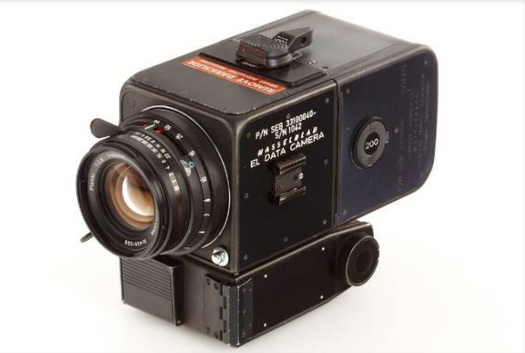

We are finalizing our itinerary to Australia and New Zeland for November this year. We will be in Cairns and will snorkel or introductory dive at the Great Barrier Reef, so which underwater camera for a one time use to get? We have two disposables but should I get a Nikonos and which lens? Other film camera? Underwater digital? I am open to ideas.
I can't say if a Nikonos is a good investment - but it could be (price could increase much)!
Why not to use your Hassi ? Is there a motor driven Hassi exept the NASA version out ?
Guess you want to shot 120 film - there are many other motor driven cameras from other brands
you perhaps still own ?

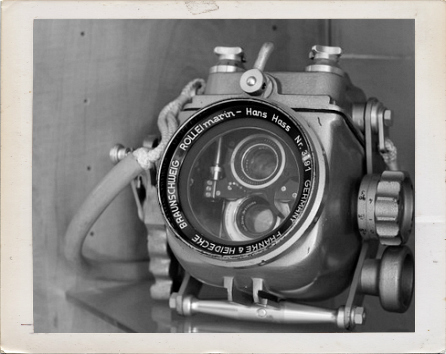

During the past there was a company managing all kind of underwater support for film cameras!
I just googled if this people are still in business today?
Yes they are allive :

Yes, the Minolta Weathermatic gets the job done - that's the camera I use for underwater photography. And it floats too!
Just found the manual for my Weathermatic, only good to 5 meters, so not so good anything deeper. I think the Sea and Sea are good for much deeper. I used my Weathermatic for wet weather, but have switched to a Pentax WR IQ with a zoom.

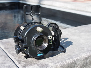

Later I bought a "Vivitar Cruise Cam" from an auction. This is, in reality, a very simple plastic point and shoot motor wind 35mm camera with a separate water proof housing. Fixed lens, fixed focus, click and go....doesn't even have an exposure system. But it does work, and it has flash which can be turned on and off while in the housing....good for a whopping three to four metres I think.... It does the job with 400ISO and 800ISO film under water and can be used on dry land without the housing - where it works better with 200-400ISO film. It's far from perfect but it does achieve cheap film photography under water. Motor wind is so strong that bulk loaded films can be ripped from the cassette spool unles gaffer tape is used! The lens is reasonably sharp across the frame, it does the job as a snapshot camera above and under water.
