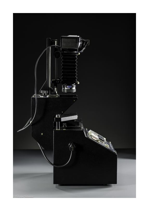

This is an alternative to your setup...
This is what I used before I got a scanner (I stil have it, you never know).
