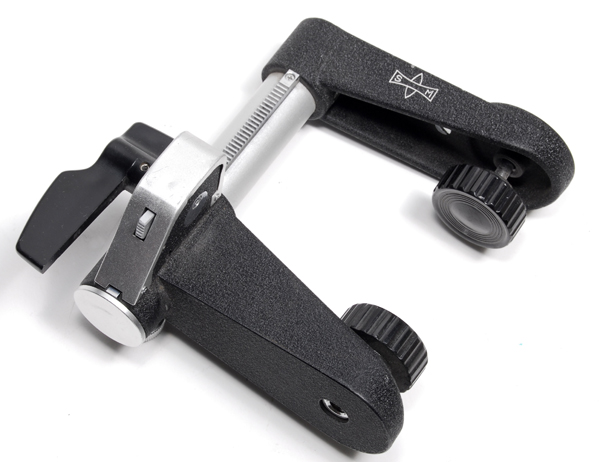

Solution:
That thingy is mounted on a tripod and then the camera on top if it. You screw it down, frame via the finder and then crank up the camera for the height distance between taking lens and finder.
Though, I see such for the first time too and am puzzled by it having two mounting screws instead of one. (The other one would be at the tripod.)
What is that gizzmo?
A Paraminder. It is for Mamiya Cx TLR cameras. Compose the photograph in the upper lens, then with the camera and the Paraminder on a tripod raise the camera via the Paraminder to place the lower lens in the place the upper lens was thus correcting for parallax.

Paramender works perfectly for all distances; no 'if.'

A note on the Paramender: the parallax correction will only be 100% accurate when used with a C series Mamiya. It raises the camera by the exact distance between the centre of the viewing lens and the centre of the taking lens. On most 35mm rangefinder cameras the viewfinder/rangefinder is not located directly above the taking lens but off to one side. Also, the vertical distance between the centre of the viewfinder/rangefinder and the centre of the lens will in most cases be less than the distance covered by the Paramender.
The Mamiya C series focuses extremely close by means of bellows, making the Paramender indispensable when used at distances closer than 3 feet or so. No rangefinder camera I've used focuses closer than about 3 feet.

That is why I specified Mamiya Cx only and made no reference to any other camera nor any other format.
