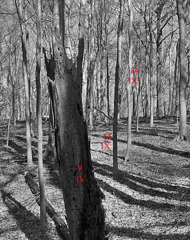

Here is an example (albeit not a great one), but an example of the use of a spot meter. From the camera's position, I metered my "important" shadow that was the trunk of the dead tree. It's reflective (luminance) value raised the needle to 9, I placed that luminance value on Zone IV.
Then I read various "important" highlight areas throughout the scene and found that the sunlight on the leaves of the forest floor and the sunlight on some of the trees had a luminance value that fell on 14 or Zone IX, 5 zones i.e. 5 meter scale numbers higher in luminance than where I placed the luminance of the shadowed tree trunk. Any other small areas that had a luminance value higher than a reading of 14 were ok with me, but I wanted the sunlight on the forest floor and that on the tree bark to be no higher than a Zone VIII print value. About the middle-left of the image there are two white dots, that's the ridge where there is a sign along the trail, I failed to see that while composing.
This is a SBR of only 6 zones. However, my high shadow placement on Zone IV pushed the luminance of the important highlights to a Zone IX negative density, where they would print without the desired texture. Therefore, I developed the negative for N-1, so that those important highlights would develop to an effective Zone VIII negative density. So, although the SBR of the scene was 6 zones from IV to IX (32:1), I developed the negative to an effective 5 zone range from IV to VIII(16:1) to accomodate those areas of the negative I want to print with the desired shadow and highlight detail.
The development time of N-1 is relative to what one determines as their "normal" time. My "normal" for this combo (TMY and D-76 1:1) is 8 min that puts the curve reaching a Zone VIII density of 1.3. So, N-1 dev would be the curve reaching a Zone IX density of 1.3----in other words, any area of the attached picture that has a luminance value of 14 (Zone IX) is developed to a negative density of 1.3. Continuing on with the example, for N-2 the curve reaches a Zone X density of 1.3-----the idea is to develop the film to the same density range.
I used an orange #21 Lee filter that brought the shadow down a bit, this is why I placed the shadow high on Zone IV----to account for an anticipated loss of some shadow density. Placing it on Zone III would have meant the filter would have brought the shadow down too low with more loss of detail than I wanted. The film was TMX with the basic exposure of 4 sec at f/64, accounting for the filter factor of 2.5x, the adjusted exposure was calculated to be 10 sec at f/64, then acounting for reciprocity, the actual exposure given was 25 sec at f/64.
I hope this helps in some way.
Chuck
