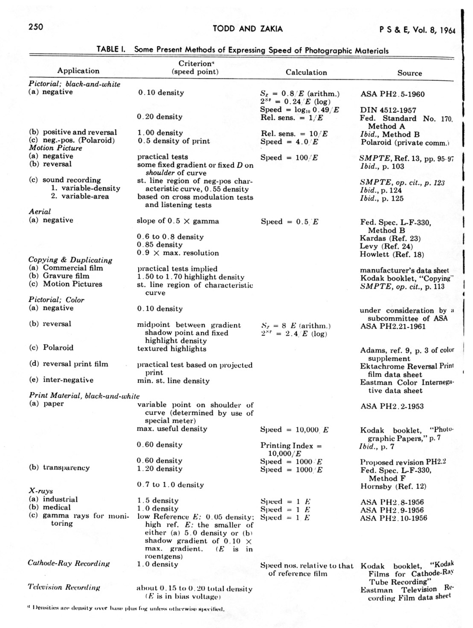

Two points of merit.
1) As one can see in this table (only half of the info shown) there are many film speed rating systems. Each with a different goal
2) The ISO system's goal is thinnest negative which produces the first excellent print.
a) ISO is based on ASA
b) ASA is based on fractional gradient
c) fractional gradient is based on a panel of observes rating negatives obtained by photographing some 8x10 transparencies of some 'pictorial' scenes.
d) A photograph of Willow Pond, Rochester, NY was one of the transparencies.
e) So ISO speeds are good for pictures of ponds.
