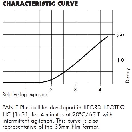

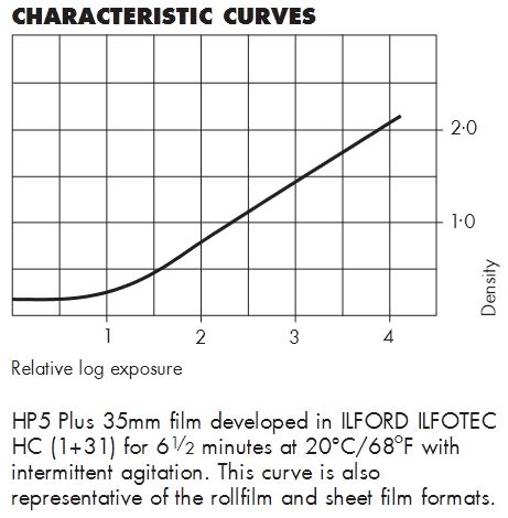

I'm not sure if this is the right section to put this, but after reading PE's "Photo System Engineering", I think so.
I now understand that the slope of the straightline portion of the curve is contrast, but what about the densities? Are they important in practical photography in terms of matching a film to a subject?
I was looking at the curve for Pan F and HP5+, by my rough calculations I make the slope of Pan F to be 0.8 and HP5 to be 0.66. However, the density of Pan F at an exposure of 3 is roughly 0.75 vs almost 1.5 for HP5. Does that mean a Pan F negative will be thinner than an HP5 negative? I've always associated a thin negative with low contrast, but the slope tells me that isn't so.
Pan F seems to build density quickly with exposure, does that mean I should use it with a subject of a small brightness range, say a cloudy day and a range of 3 or 4 stops from shadow to highlight?. Would HP5 be more forgiving of a larger brightness range? Or am I misunderstanding the information within the curve?

The slope of the straightline portion is gamma; which indicates relative contrast. The actual contrast is determined by a combination of the film stock, the scene photographed and the film stock response to a particular developer, (at a specific time and temperature).
Assuming your calculations are correct, then the Pan F was processed to a higher gamma than the HP5, but we know that the Pan F is ISO 50 and the HP5 is rated at 400 with normal development. Typically, low speed films have more capacity for graduations of density than higher speed films, but that depends on how they are developed.
The charts you are looking at are one developer (and dilution), at a certain temperature, with a certain agitation, developed by unknown methods (mechanical or hand?) Chances are, if you did duplicate the results yourself, there would be a difference in some aspect of what they used to arrive at their results.
A more meaningful comparison would be to generate a personalized "Family of Curves" for each stock by exposing multiple copies of the density target at a set exposure and then developing those targets at varying times and dilutions of developer. Of course, being this fine-grained gets tricky unless you are machine processing the film, as being consistent is problematic.
The horizontal scale across the bottom shows how much light was given to the film. This part of the scale is directly related to the scene and the camera settings.
With regard to subject matter in the scene their relationship (spacing on the horizontal scale) remains constant. The difference between say a subjects face and their shirt might be 2-stops, on the horizontal scale that translates to a spacing of 0.66666667 between those two tones. (A spacing of 1 on the log scale equals 3-stops in the scene. 2-stops is 2/3 of 1 or 0.66666667ish.)
With regard to the camera settings, adding or reducing exposure shifts all the tones/exposure levels equally right or left. So imagine that a face gets an exposure of 1.8ish on the horizontal scale.
Using the 2 examples you provided notice that for HP5 that places the face nicely on the straight line at 0.8ish density. With Pan F though that exposure level just barely touches the toe and the density is hardly different than Film base + fog; for Pan F that camera setting gives us an underexposure. Pan F is just a slower film so if we add three stops of exposure, so add 1.0 on the horizontal scale to get 2.8, we can see that the face comes up nicely onto Pan F’s straight line and that face falls at 0.8ish density.
With HP5 and the face exposed at 2.8 on the horizontal scale you should see that the face is still nicely on the straight line and the density on the vertical is now up to 1.3ish, it is not over exposed and still very printable. What needs to happen to print it ‘normally’ is simply more enlarger exposure to place the face properly on the paper.
So, does density matter? No, as long as you get enough exposure to get all your subject matter up off the toe a bit.

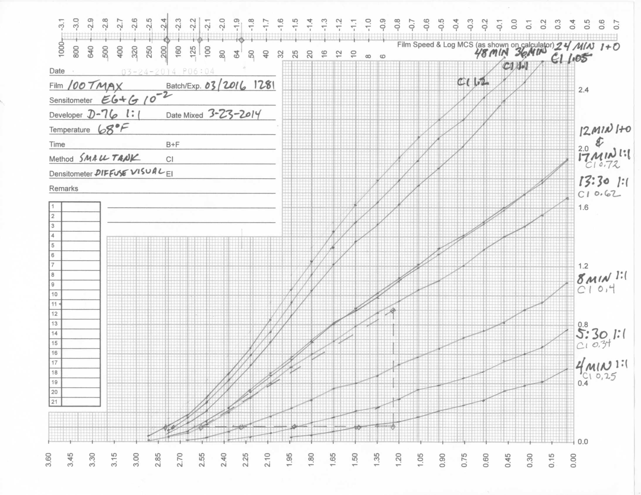

I always feel that those stylized graphs are difficult to interpret because you can’t read the numbers with enough precision.
I offer one of my more informative graphs which you can read to 0.01 precision. I subtract base and fog. Instead of giving relative exposure I purport to give actual exposure (probably accurate +/- 1/6 stop). The log meter candle seconds scale at top tells how much light hit the film. The bottom scale (like the 0 1 2 3 4 at the bottom of Ilford’s scale) goes from 0 to 3 but right to left on my graph, because I am showing how much light is “held back” from a full blast exposure (full blast would have 0 density blocking the light and my “step wedge” goes up to 3).
The large dashed triangle shows the ASA aim... the line closest to that hypotenuse is the one that best tells the film speed. In my case 13:30 meets the requirement and this film could be called ISO 100 because of where it hits 0.1 density near -2.1 log mcs.
That's a fair bit different from the datasheet time for TMX in D76 1:1 of 9:30

No, I think, you are starting to understand. a thin negative can (and often is) high in contrast.low exposure may have lead to thin midtowns and shadows but highlights had enough exposure to develop their full density potential. The result is a thin but contrasty negative, best printed on a medium to harder paper.
Should like to say something about the thread title. I think you want to understand a photographic material’s character, not a graph on paper. The so-called characteristic curve is only a means for explaining something.
As others have said you have only the negative side of the story here, the positive one needs to be added unless you want to look at a negative, I mean, why not, an 8 × 10 image framed on the wall can be attractive. :smile:
In theory, an image on photo paper should have the same contrast that was with the object. Or gamma 1.0 which is a logarithmic value. Negative films generally end up with a gamma of around 0.6 or 0.7 when processed according to the manufacturer’s instruction. Photo paper develops to a gamma of about 2.0. The product of these values comes to something around 1.3 or a positive image a tad more contrasty, harder. When making positives on transparent materials for projection, slides or ciné film, you want a gamma of 1.55 or so to compensate the Callier effect. Briefly, the graphs serve her/him who wants to keep everything under control rather in commercial work. A photographer judges by her/himself, uses her/his eyes and common sense.
Craig, Europan is starting the conversation about contrast control. I had purposefully ignored it above for clarity regarding speed difference.
When considering print contrast there is some context that needs to be understood. For example that paper has a fixed range, it goes from paper white to ‘max black’ and that’s it. The only other significant variables for a finished print are how glossy or matte the finish is and the lighting the print sits under.
A high gloss RC paper will look more contrasty than a glossy fiber because the former can produce a darker black. Brighter lighting can help you discern a bit more range but the print has to be printed darker to get there. These limits are hard physical realities that limit how much of the negative can be straight printed.
You can represent these limits with horizontal lines drawn across the film curves. Those lines have a given spacing, for example grade 2 will be spaced on the vertical axis about 1.0 apart. The height of the lines is controlled by enlarger exposure and is adjusted to place subject matter like the face I used as an example above or whatever other tone you please. For a straight print you only get to place one tone the rest ‘fall’ as they will. Only the tones between the lines show detail on paper. Anything above the upper line prints as paper white, anything below the lower line prints as max black. But you can choose a different paper grade and extend or shorten the spacing between the lines.
As you can also see in Bill’s example the steepness of the film curve is a variable too. That’s true of Pan F and all others.
The point here is that Pan F like the rest can be used in most any lighting contrast situation, the bigger issue is typically the practicality of the film speed.

Only to a certain extent. I understand about gammas and matching the film and paper, but perhaps I misphrased my question in the first post, so let me have another try:
These curves are included on the data sheet, what are they trying to tell me? What information can I obtain from them that will affect my use of the film, either in exposure or development?
I wasn't really asking about film testing ( although I appreciate those who took the time to type out their methods) but wondering why those curves are presented and what information is contained within them. It seemed like it was a tool that I had no users manual for and no idea how to use.
Alrighty. Let’s assume all film manufacturers published graphs of their products in equal manner, identical scales on abscissa and ordinate, same size. Then we would be able to simply put one over the other for comparison of minimal densities, contrast, max densities, and more. I think that’s about it.
The curve gives us a way to talk about the way a film responds to light.
For example we can see that HP5’s toe is longer than Pan F’s. With experience we might decide that that longer toe helps make us make nice portraits but we like landscapes with better shadow separation, so all the important tones on the straight line. Understanding the shape of the toe and how to place our subject matter to use the toe, or not, gives us a way to make better photos.
On the attached pdf you can see more examples of curve shapes etc...
Yes it takes longer to develop to the ASA specifications than most data sheet starting point times.
I think it’s because thinner negatives help you hold qualities like sharpness and resolution, so the published times are a little shorter than the ASA times.
ASA times fit the average scene to Grade 2 paper with a diffusion enlarger.

Further, any "useful information" that you might get could most likely also be found through a series of systematic tests. Now, when I say "useful," I'm talking in terms of the effect on pictorial photographs.
The benefits of published characteristic curves are mostly in your ability to judge how a specific problem you encounter would show on a characteristic curve, then how to judge different film and developer curves to find a better combination. In other words, you would do much more limited testing because you know how to target it better.
This is often found to be about 1.5.
Why 1.5 instead of 1? (colour seems to be about 2) Is this to compensate for reduced intensities of the reflected light from a print versus that those found in the real scene?
