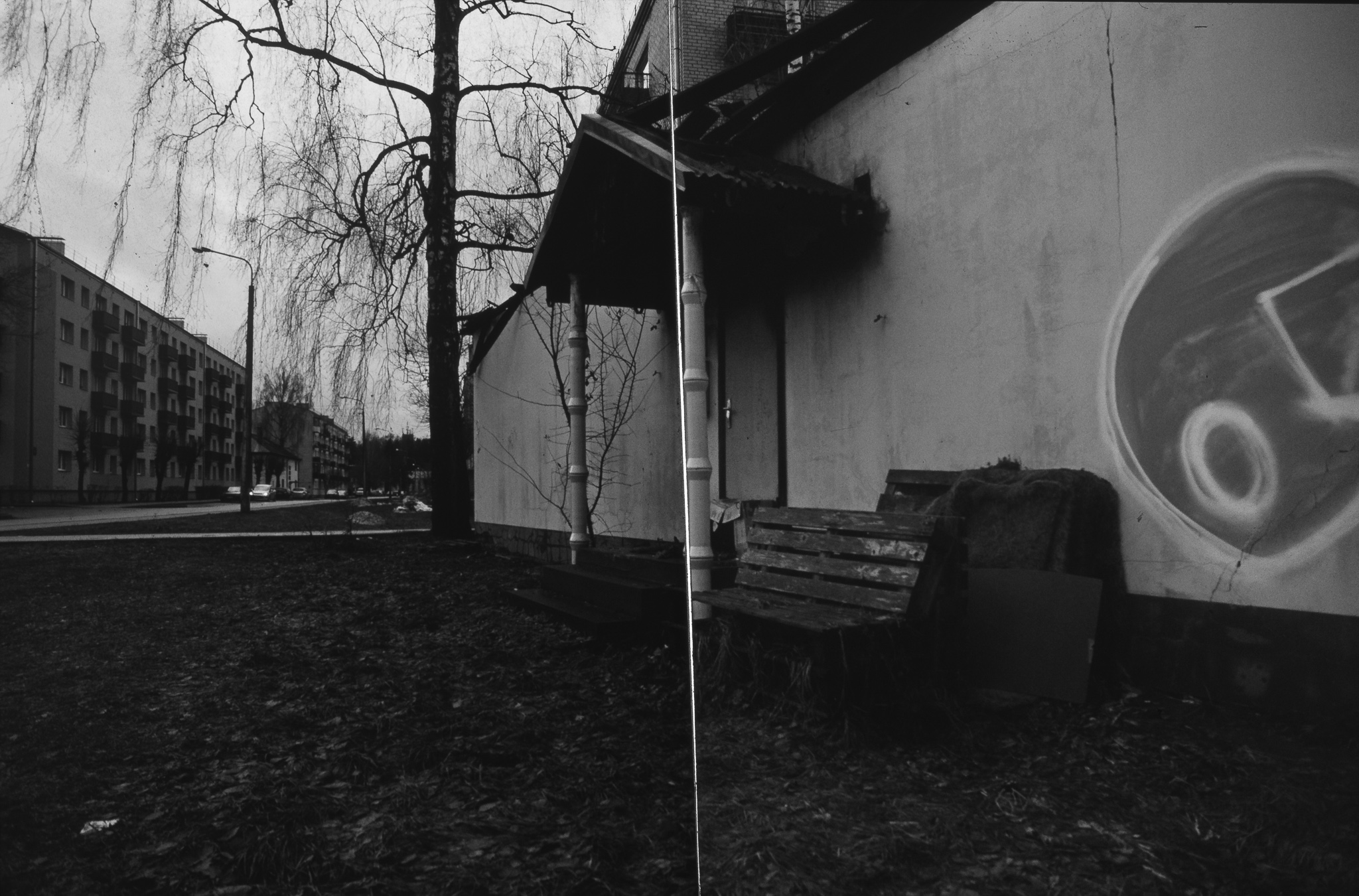

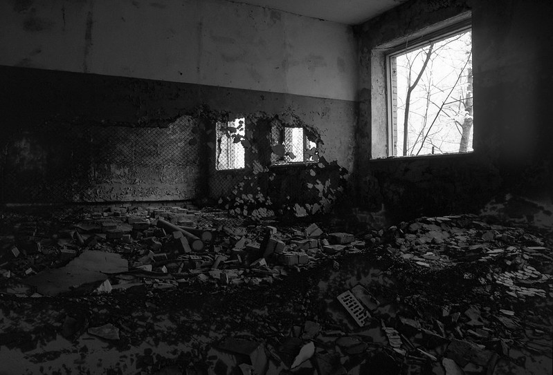

Left: Box speed test with highlights problem - not cleared to the base, "grit" left on film - to be removed by adding hypo crystals to 1st developer
Right: -1EI underexposure to check latitude and control 1st development time. Also has the same highlights problem...
Can you see some strange lines running across the power-lines? That's how you know you should add some hypo to remove "the highlight fog". Less is more - to hunt this down, test hypo in 0,2g increments at 500ml working developer solution. Tell-tale sign of this is also coloration of rinse aid - it should run off clear instead of gray. If it runs off black or gray, hypo is needed in 1st developer.

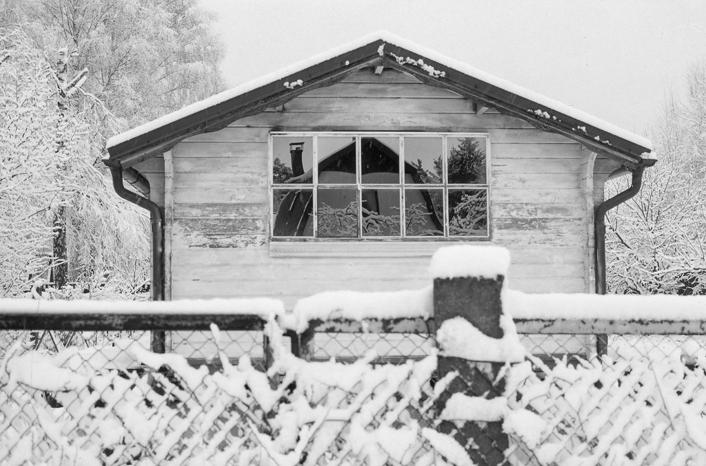

Fomapan R 100 in challenging natural lighting conditions, box speed on a tripod.
No strange performance of rite of "shoot film X at Ei X" is needed.

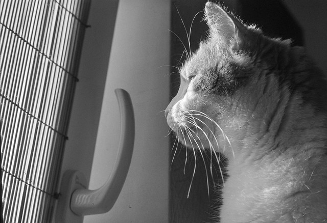

An old stand reversal experiment. Rated Delta 100 at 400 and illuminated the shot with a flashlight. Didn't hope for much, expected this to be completely unusable, alas... Stand Reversal gave an image.
By controlling hypo amount in tandem with development time and agitation frequency, you essentially are controlling where you want to land your film: normal development, pushing, pulling… all the traditional development techniques apply - down to agitation frequency and its effect on image contrast - which applies to slides even more so than to regular negatives, as slides often are the final product, ready for projection.

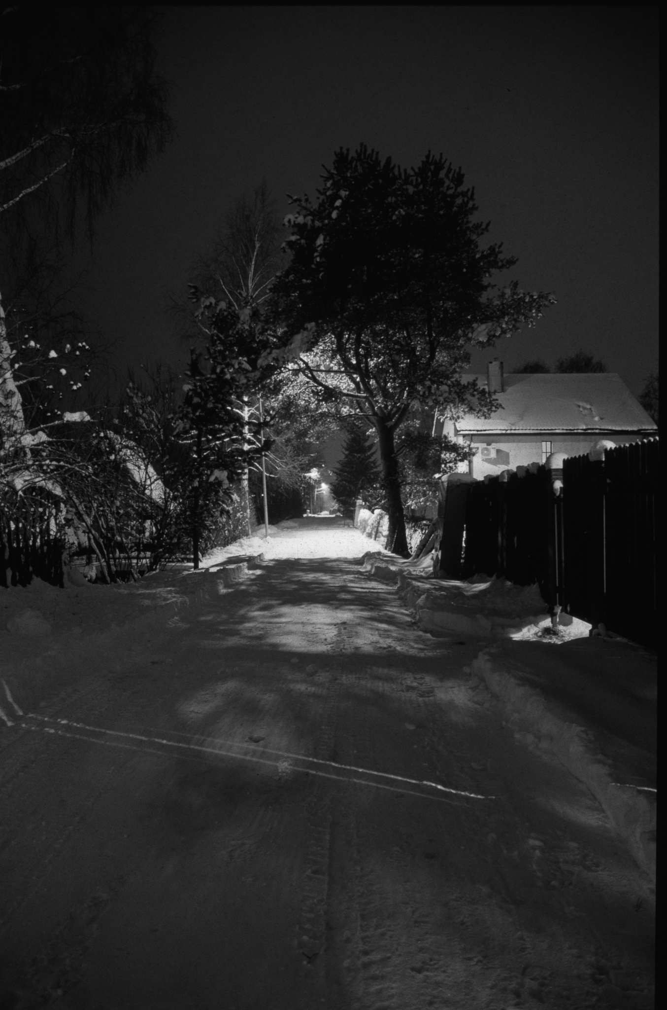

R 100 at night, box speed - nice latitude!

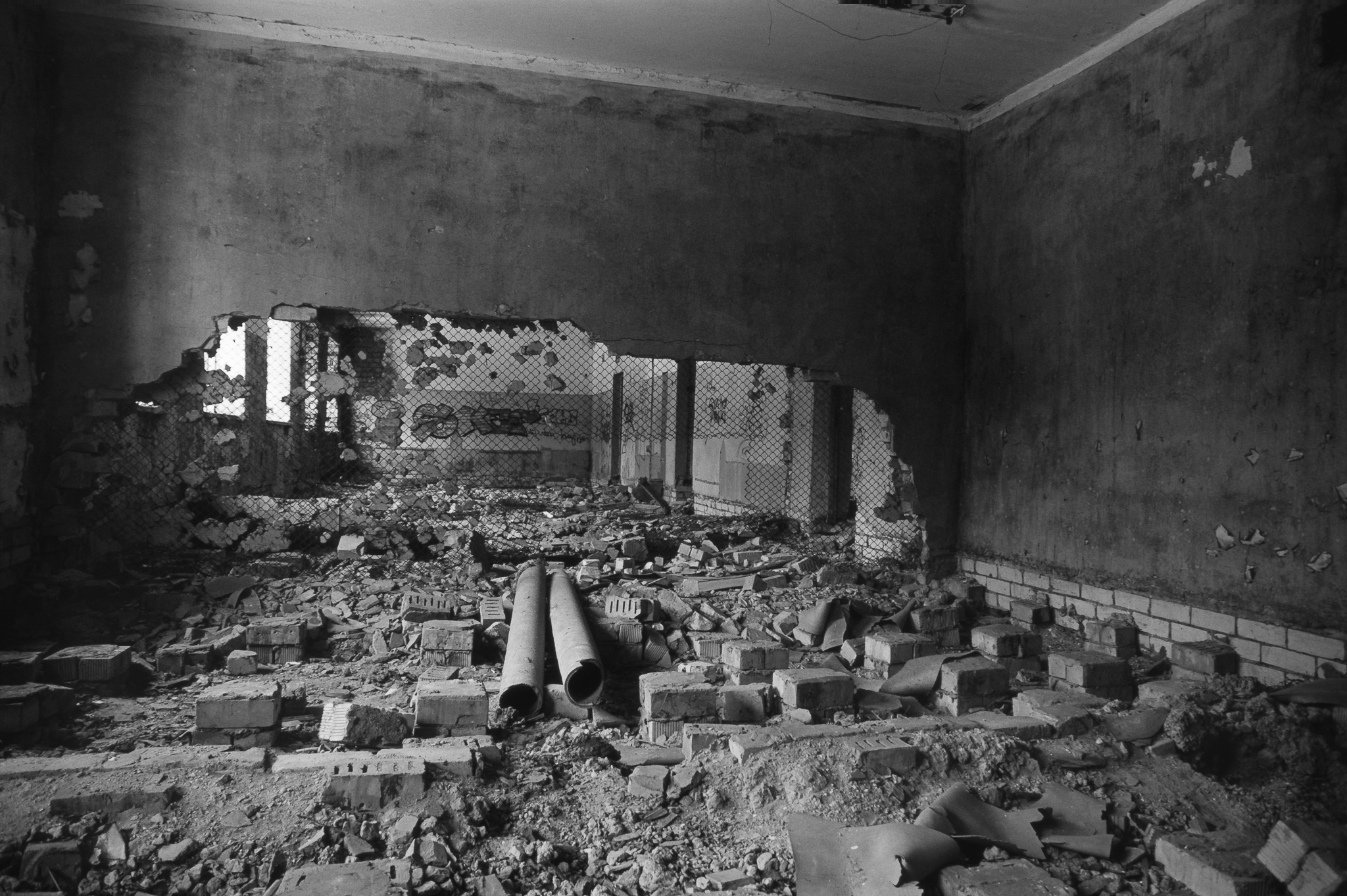

To question everything is nice up to a point when a test is needed. So do one. What are effects of over-bleaching? Our beloved emulsion departing from the base, of course.
Much rarer does one ask: what are the effects of under-bleaching? Something similar to solarisation in the densest parts of slide:
URBEX LV by Ivo Stunga, on Flickr
Zaķusalas TV tornis infrasarkanajā by Ivo Stunga, on Flickr
An example of emulsion damage due to overbleaching. To fix this, reduce bleach concentration or time.
