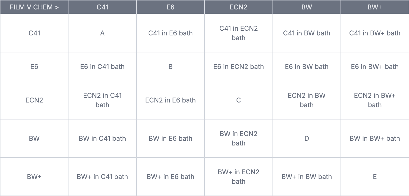

There are five major types of film processing solutions available today, which makes 20 different possible combinations (whether or not these results could be any good is another topic).
I am also assuming that for each one of these combinations, pushing and pulling might be possible during development if one wants to experiment (but please tell me if I'm wrong).
Am I correct in assuming that all 20 combinations of the below table are correct applications of "cross-processing"?
If anyone has examples of the most rare combinations, I would love to see them.
A: CineStill C41 kit or other - $30
B: CineStill CS6 or other - $40
C: CineStill CN2 - $13
D: Rodinal or other - $9
E: Adox Scala Reversal kit - $46
1: C41 in E6 bath
2: C41 in ECN2 bath
3: C41 in BW bath
4: C41 in BW positive bath
5: E6 in C41 bath
6: E6 in ECN2 bath
7: E6 in BW bath
8: E6 in BW positive bath
9: ECN2 in C41 bath
10: ECN2 in E6 bath
11: ECN2 in BW bath
12: ECN2 in BW positive bath
13: BW in C41 bath
14: BW in E6 bath
15: BW in ECN2 bath
16: BW in BW positive bath
17:BW positive in C41 bath
18: BW positive in E6 bath
19: BW positive in ECN2 bath
20: BW positive in BW bath

I suggest changing 'bath' to 'process'. There is no E6 bath - the process consists of multiple chemical baths.
#13-15 and #17-#19 don't make any sense. If you process a B&W film in C41 process, you get blank film. #20 also makes no sense for films like Foma R100 due to the silver mask.
For cases 1 through 20, however, I do not recall having seen examples of each scenario and wonder if they even exist!
#3 and #11 work fine. You can find plenty of examples on the web. #16 also works fine - there are many threads in this forum itself if you search for 'reversal processing'. On the web, search for Dr5 process and you can find many examples.

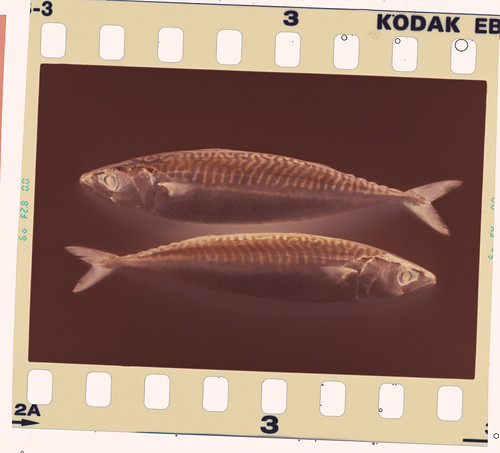

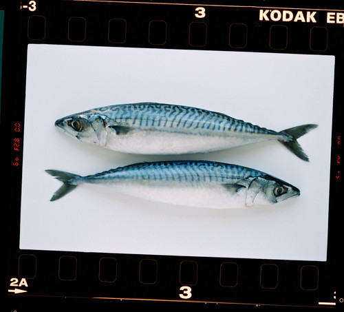

#1: here are examples of XP2 Super cross-process in E6.

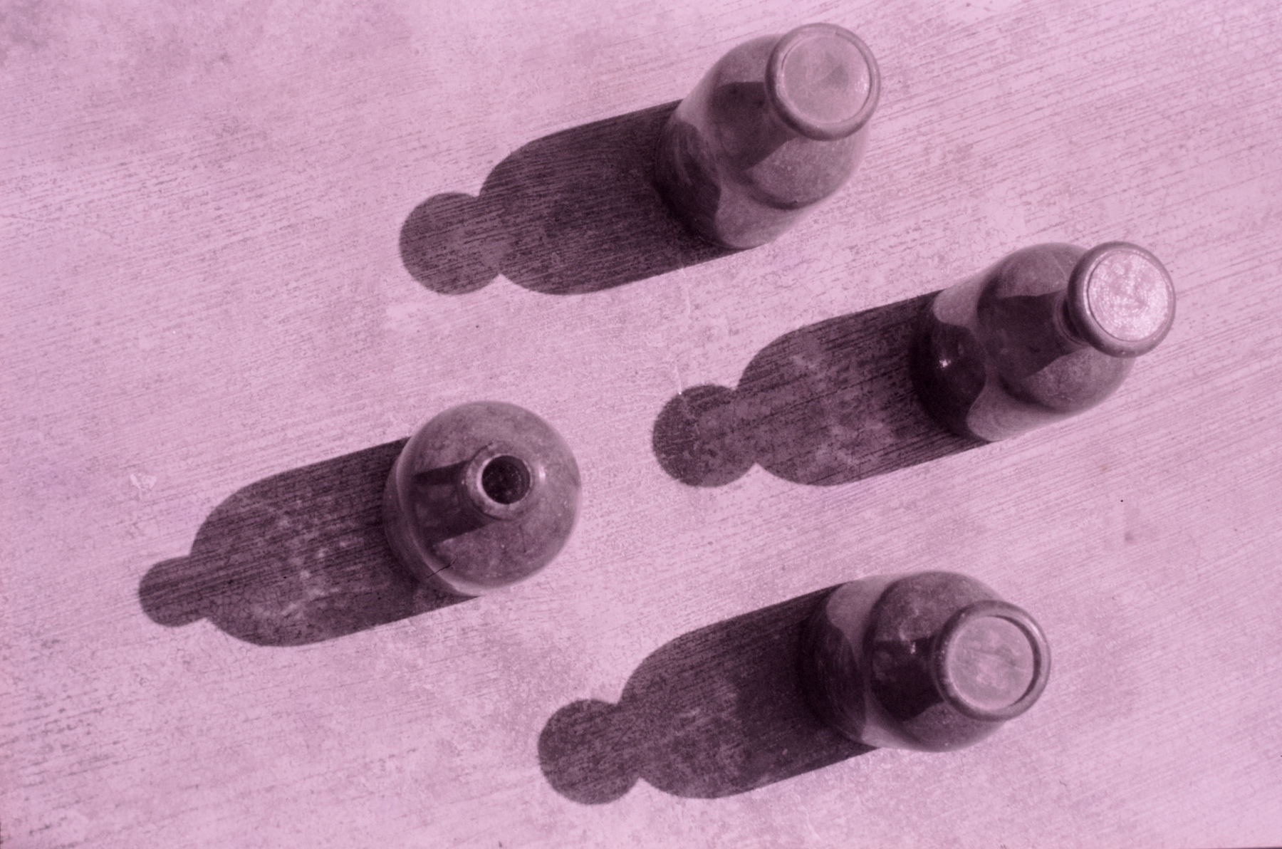

The way I've seen "cross-processing" used is 99% referring to E-6 in C-41. In particular I've never seen color developed as B&W referred to as cross-processing. That doesn't mean it's wrong to do so, just that it's not commonly used that way. People would instead refer to it as "developed as B&W".
My particular favs are E6 film in C41 - C41 flash of light half way through development.
John Callow was the king of E6 in C41 IMO.
C41 in E6 pushed 4 stops is also very seductive
E-6 in C-41 will vary a lot depending on film. Kodak slide films will be contrasty, but generally very nice and easy to invert:
I personally don't care for Fuji slide films cross processed in C-41, you have to fight it a lot more. Or embrace the oddities, which is probably the point of cross processing...
