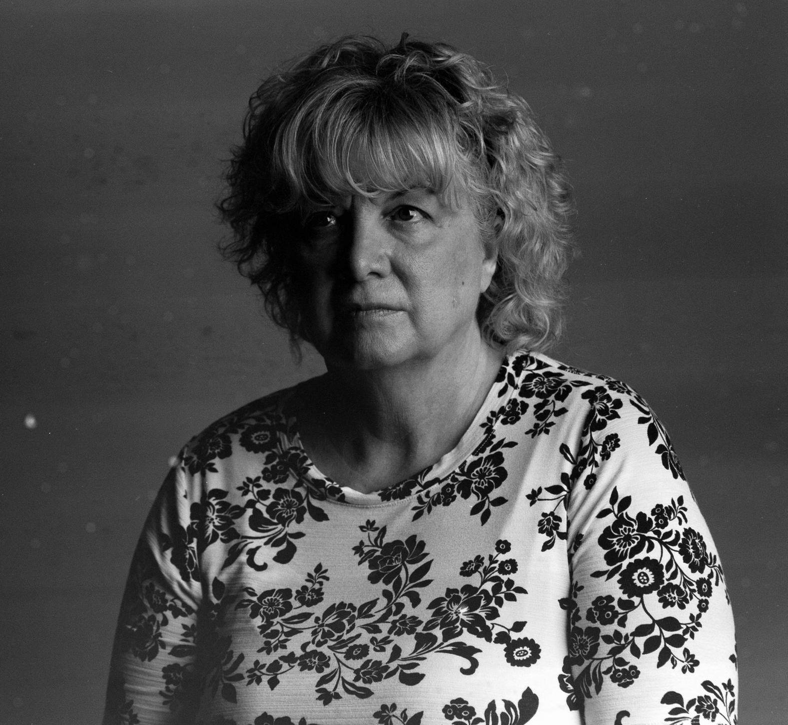

The water spots are one thing. thats on me. but the Horizontal streaks.. uh oh.
(no streaks like this on my 35 and 120 scans )
Straight out of Negative lab pro.
Looking at this, I think you have a lighting/metering problem. From what I see from the catchlight, you only have one strobe, located on the left side of her face (right side of the frame), is that it? If so, normal that the right side of her face is underexposed.
With a single strobe, you cannot use this setup and expect anything else, especially if you meter from the strobe side. So, either you change the setup of the single strobe to include more of the right side, add a fill on the right side, or meter (incident) from the shadowed right side. Last solution will ask you to find a compromise between the two readings, if you don't want your highlights to be blown.

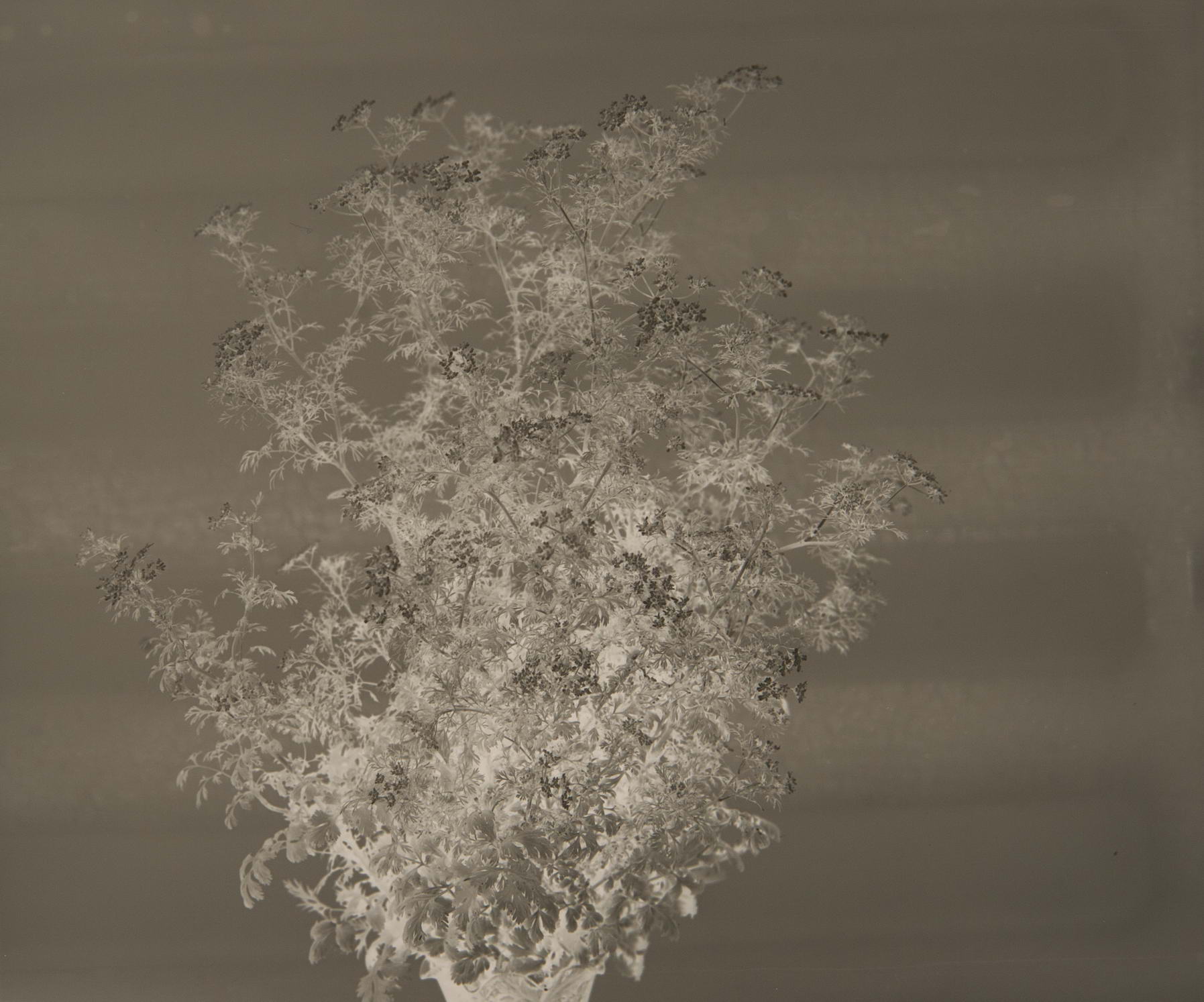

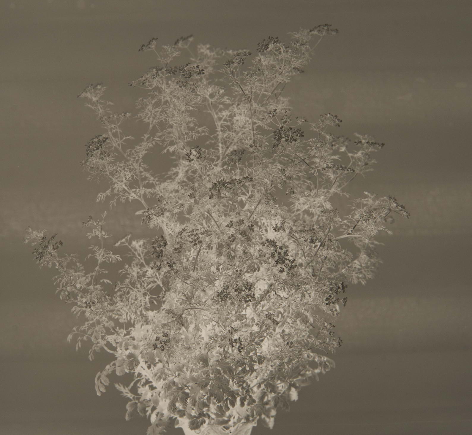

these are the D700 scans of one Negative. Cropped and resized to fit here.
nothing else. (upon examination I missed the focus though lol)
Ilford FP4+ (one of the problematic films it seems)
The first presentation is the Negative, with only distilled water used as a wash, followed by distilled water with photo flo.
The Second presentation is the same Negative, after 12 minutes of continuous washing in a large measuring cup, cold side, running tap water in the sink, with turbulence almost enough to float the Negative out of the cup. Then followed by 5 minutes of soaking/gentle agitation in a tray with distilled water and Photo Flo.

Forgive me for asking again, but are you certain that you have the emulsion facing away from the holder? I ask because I use the same holder and processing tank and same film without getting density bars like that. Only significant difference between us is that I process the FP-4 in DD-X and wash with the Ilford wash routine, although I generally wash about 50% more. I agitate per Ilford spec but rock the tank side-to-side because I can’t get mine to not leak. This is perplexing.

the more I think about it.... I bet I DID flip the film and put emulsion against the frame. Nothing brain surgery with a fork cant fix.

Yes, I took the film out of the 4x5 Holders exactly as I put them in and transferred to the Tank Holders...
I think you can now read between the lines... or perhaps peek under the darkslide....
