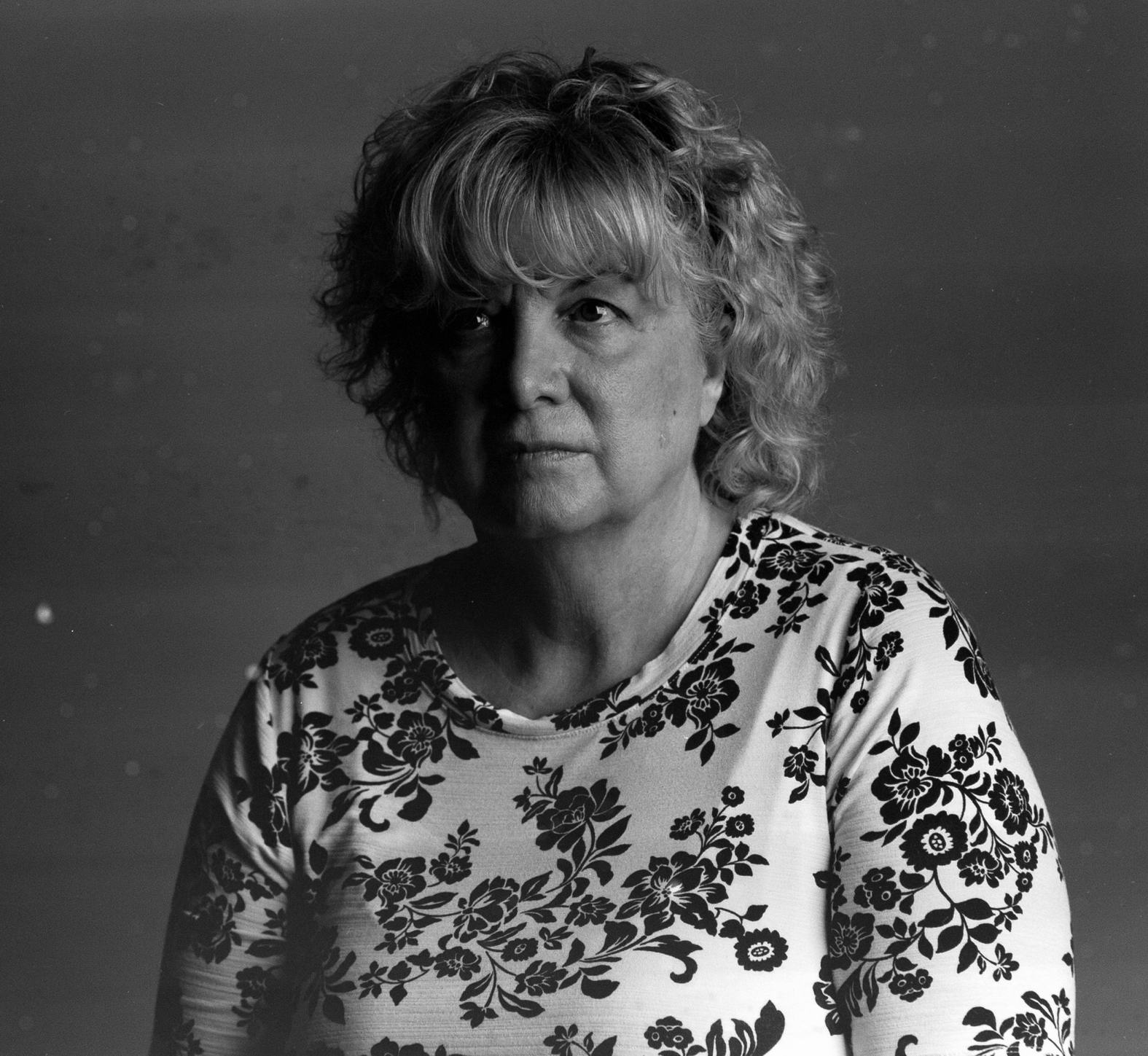

Houston we have more issues.. fun huh? LOL!
The water spots are one thing. thats on me. but the Horizontal streaks.. uh oh.
(no streaks like this on my 35 and 120 scans )
Straight out of Negative lab pro.
BrianShaw
Nov 30, 2005
16,526
La-la-land
Awesome detail and a very nice sitter. :smile:
So the flash works, and the lens works, and the film works. You are getting somewhere!
Seems like a processing issue. Did you have enough developer in the Stearman tank and did you agitate efficiently? Or are your film holders the older ones. I think I recall that the film holders were re-worked at some time in the past to eliminate problems like this.
EDIT: In case you haven't seen this: https://shop.stearmanpress.com/pages/blotches-of-doom-solved

I see the horizontal streaks on another scanned negative.
Re-washed the one above, crafeulyy wiped with kimtech, waiting to dry.
I always final wash in Distilled water plus kodak photo-flo
looks like I did not wash it enough at the very least. prior to using the distilled i wash under the sink, in the tank and we do in fact have minerals in the water.

checking that out now. They are Rev4

I noted that after the fix, I lifted a holder and saw bubbles/liquid trapped between the film and the Holder.
this is going to be a show-stopper. I think I will ask for a refund. Film $$, time and subjects are not things to waste.
yes, just under or at 475ml
agitation per massive chart for the film and developer.
I do the flip and some rotation at the same time.
Will see. about to go and develop two more negatives.

Very mysterious. Is there a chance that the film was emulsion side toward the holder? Other than that I'm out of ideas. But it sure would be nice for you (and your sitter) to solve this mystery.
The Stearman has worked flawlessly for me. I hope you figure it out because it really is a nice processing system.
