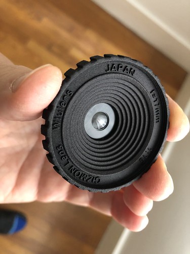

For those who claim uncoated lenses are useless... this was taken with a 17mm Wtulens which is made from the lens taken out of a Fuji QuickSnap disposable camera.
Uncoated and as basic as you can find. Handles flare pretty well!
