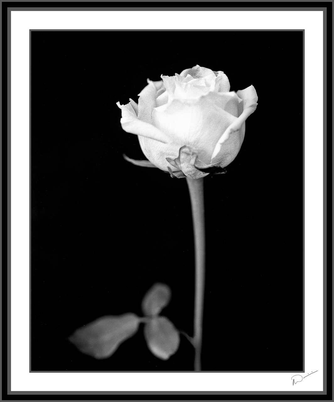

Heres my first attempt
Chamonix 8x10 Kowa Graphic 360mm Ilford HP5+ Developed in LC29
F9
1/10
Bellows @760mm

Very nice. Nothing quite like a large format contact print. Now you should practice your tilt to get all the bud in focus. Thats always a challenge with a stupidly big camera, I use two tripods.
I bought my first 10x8 camera assuming I'd make contact prints, however as soon as I held my first 10x8 negative I went looking for an enlarger and found a bargain De Vere 5108.
In this case I think it's a case of experience and stopping down a touch to get better sharpness of the rose head itself, movements won't really help.
