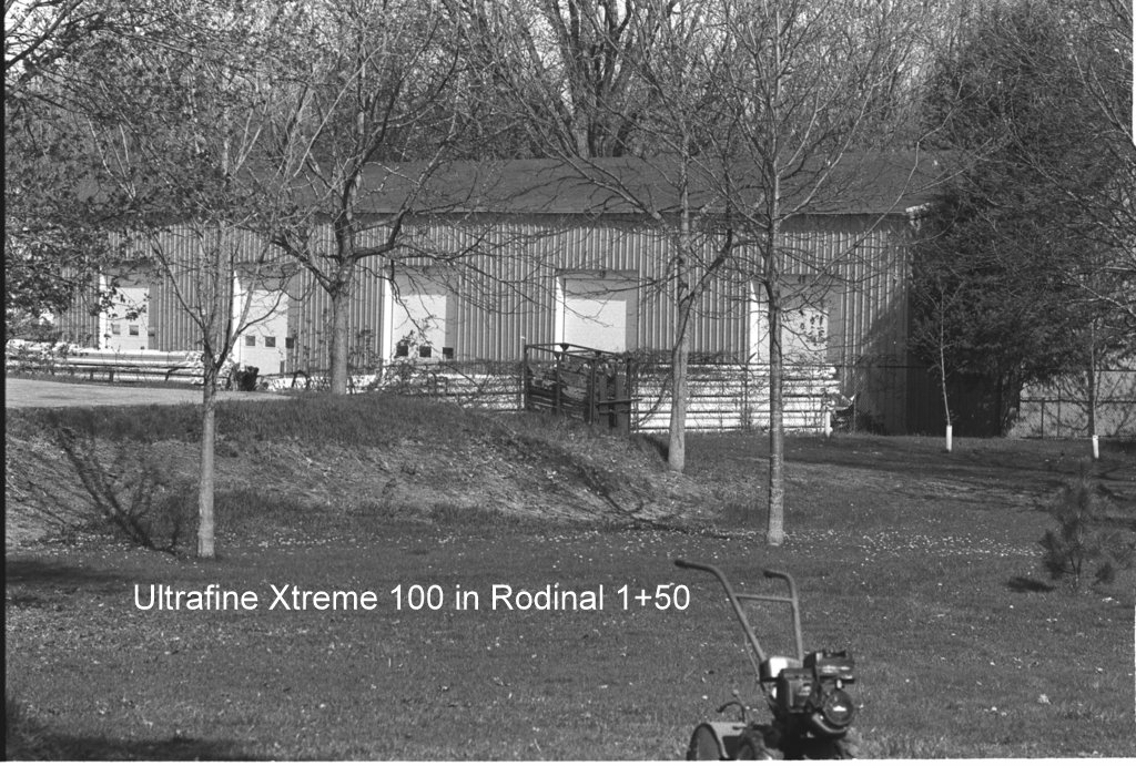

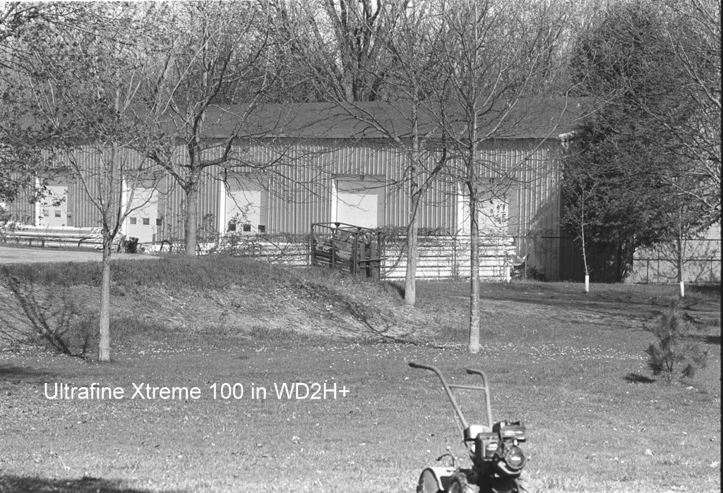

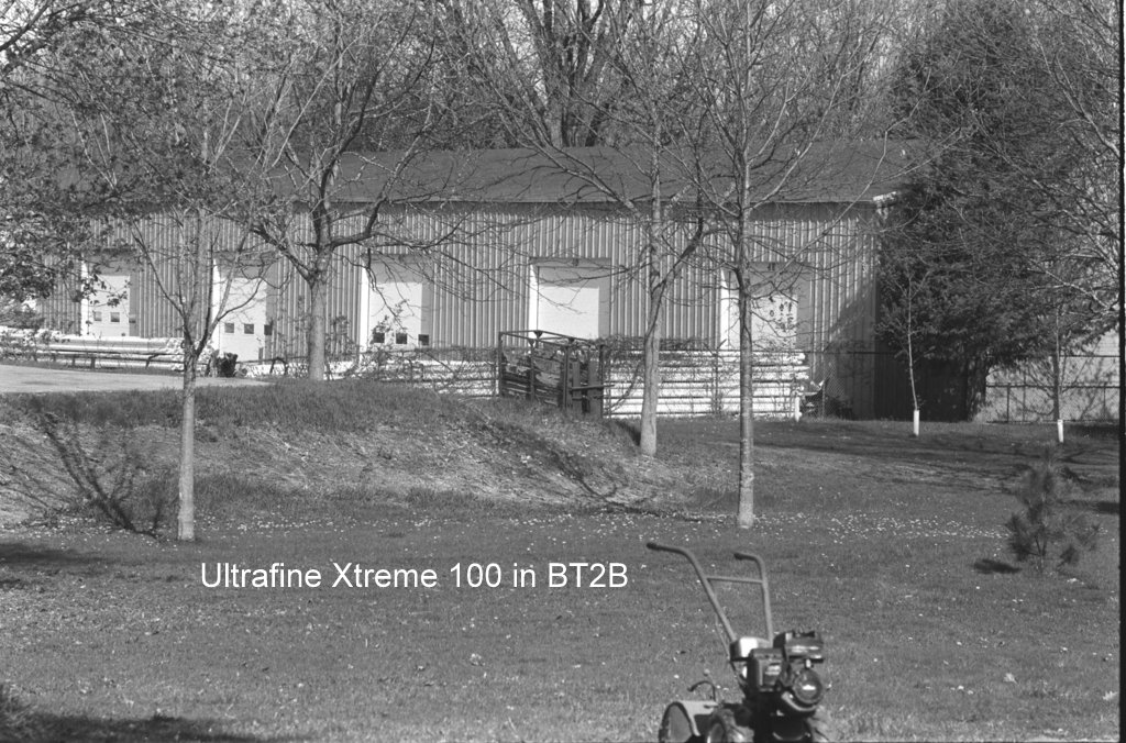

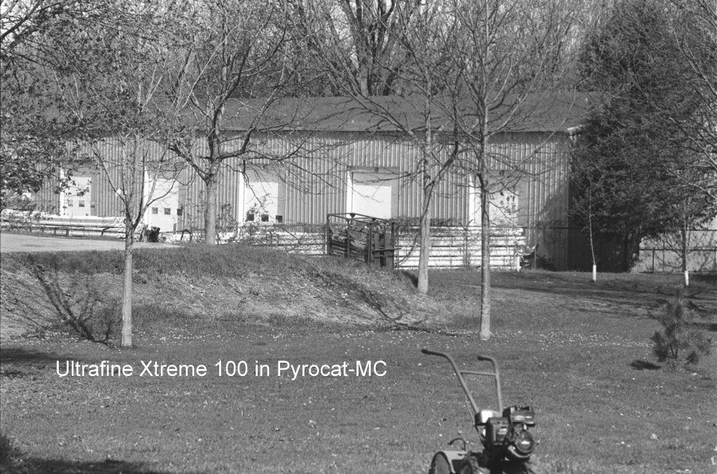

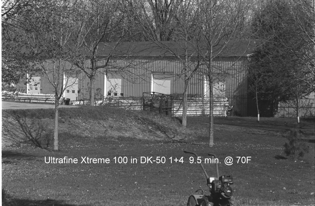

Here are the shots. Nothing to look at, but it's just a test anyway. 1-Image1  F4 135mm 2.8 Ultrafine X-100 PC-tea.jpg2-Image3.jpg3-Image5.jpg4-Image7.jpg5-Image9.jpg6-Image11.jpg

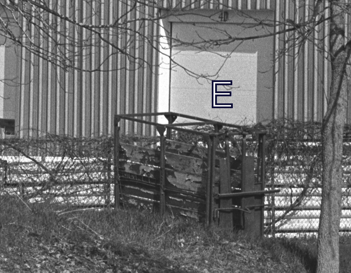

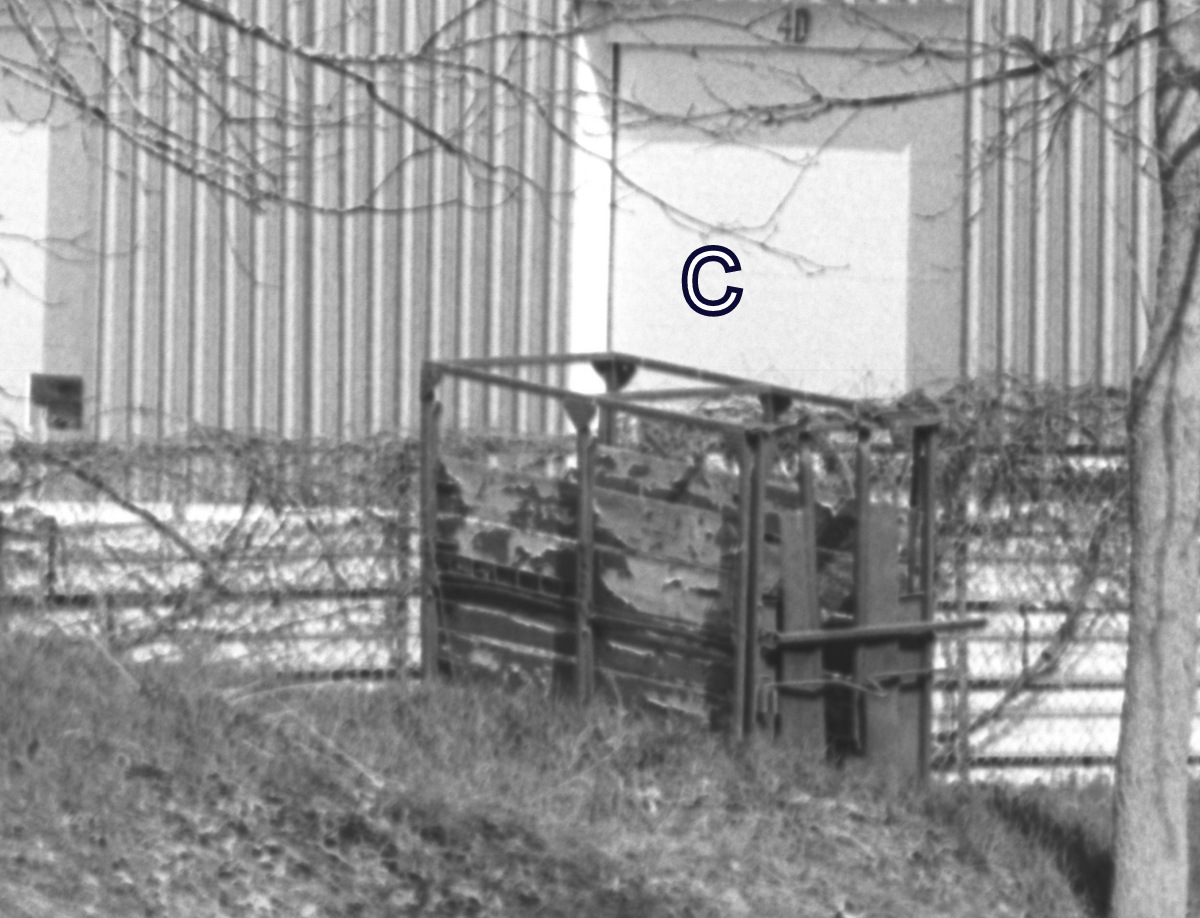

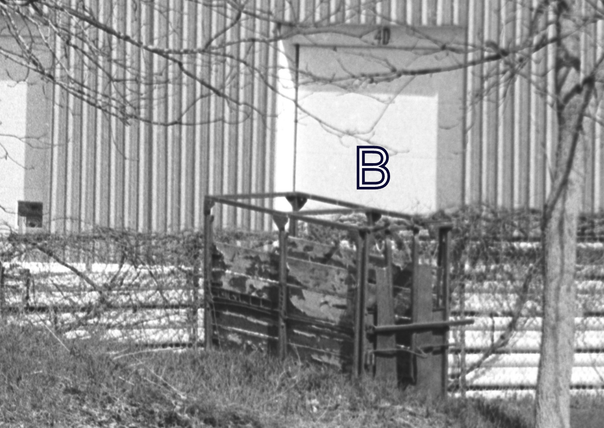

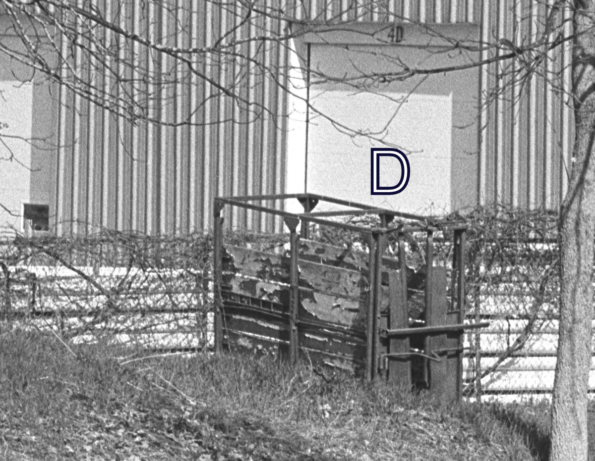

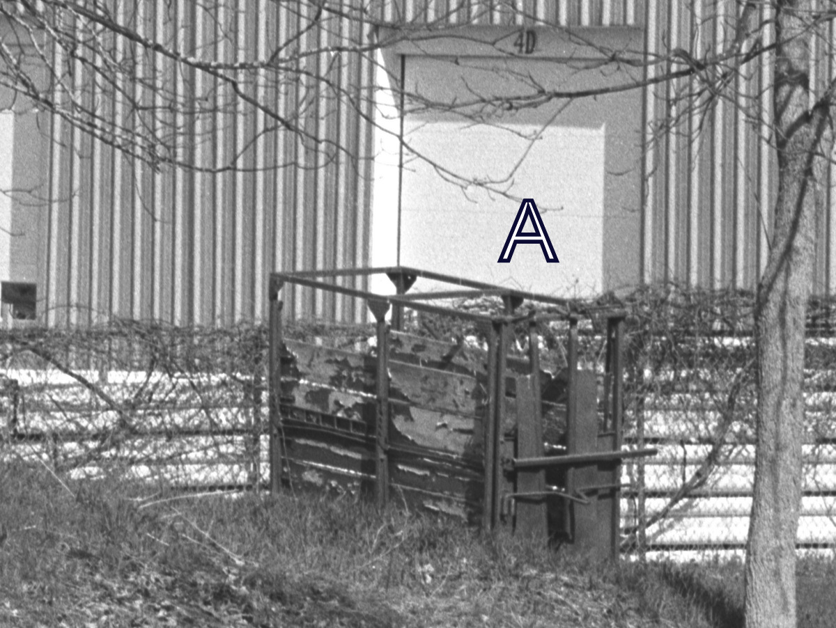

Here are the crops. I haven't told you which crop goes to which developer so as to let you try and guess a little. I'll match them up in a few hours. I also developed some snippets in FX-37, Hypercat and Perceptol 1+3, but they didn't standout over what is already posted so I dropped them.1-Image1  F4 135mm 2.8 Ultrafine X-100 PC-tea-001.jpg2-Image3-001.jpg3-Image5-001.jpg4-Image7-001.jpg5-Image9-001.jpg6-Image11-001.jpg
Here you go:
A= Thornton's 2-bath
B= Pyrocat-MC
C= PC TEA
D= Wd2H+ pyro
E= DK-50
F= Rodinal

Odd how the DK50 and Rodinal negs are so much darker, but as you mentioned, there may have been some less than optimal development times. There's a big difference in sharpness on the negs too (which doesn't surprise me), especially if you look at the little motorized machine on the right in the foreground.

Is the PC-Tea scan possibly out of focus...?
No, not likely! Nothing from the camera end/exposure was changed for the whole roll and I scanned three separate negatives from the PC-TEA batch. All came out the same - no grain, but not sharp either. Now, it might be the developer itself, but that's only about 7 months old. I surely would have expected sharper results from the PC-TEA developed negatives, but will not be trying it with this film again. John W

I found the Pyrocat rather mushy. I think your conclusions are spot on, and the DK-50 is a real contender, all these years later.
I think the other thing proven is that until you blow it up to extremes, (Xtremes?) all of the developers are good, especially if they were tweaked further. With modern films grain just isn't an issue any more, but old habits and beliefs die hard. (And that isn't even a very latest emultion! Presumed mostly to be Kentmere, which in turn is presumed to be Ilford's 100 and 400 for third world countries.)

I even check the negative with a high-power magnifier and I can see it's softer than the others. I'm beginning to think something is up with my bottle of PC-TEA as I don't remember any softness/lack of grain when I first used it. Still has me a little puzzled as does the negatives from Pyrocat-MC. I use Pyrocat-MC a ton and would have thought those negatives should have had a little more acutance/sharpness also. Glad you had good results with it, but I'll have to sort this out later. I'm out of TEA at the moment so no new batch for a while. Besides, I think I'll be using WD2H+ as my "go-to" for Xtreme 100 while I test out the DK-50 some more. John W

The blur in shot C is motion-blur. Notice that horizontals are blurred and verticals are fairly sharp. On horizontals, the blur is uneven (look at the branches), which looks just like motion-blur to me.
Mark Overton
