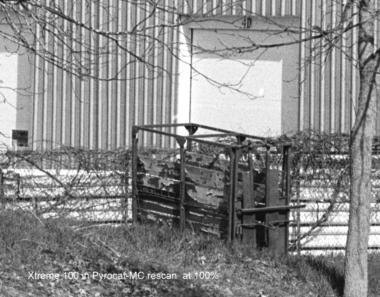

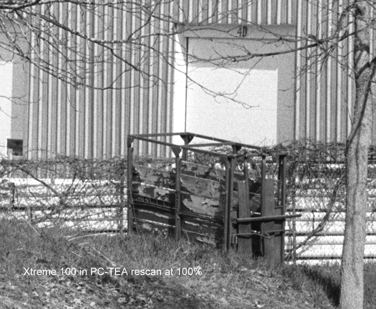

The blur in shot C is motion-blur. Notice that horizontals are blurred and verticals are fairly sharp. On horizontals, the blur is uneven (look at the branches), which looks just like motion-blur to me.
Mark Overton
Mark,
Trust me, it's not motion-blur, but I did rescan both the PC-TEA negatives and the Pyrocat-MC negatives. I don't have time at the moment to post the scans, but will later on. I recalibrated the scanner on each set and came away with some surprising results. More like what I expected the negatives to look like in the first place. John W

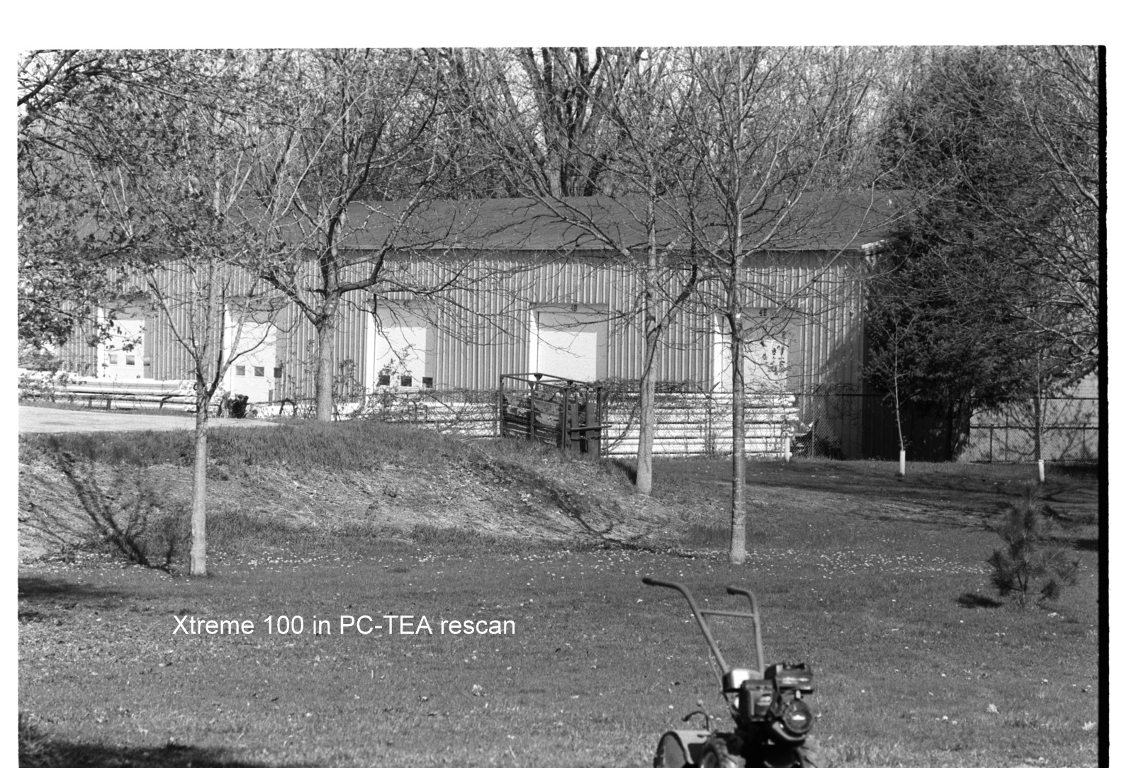

These are the rescans and I did tweak the curves black point up to match the drop-off point on the histogram. This added slightly more contrast and apparent grain, but looks pretty good for sharpness. I also recalibrated the Nikon LS8000 on each set of the negatives. I'm starting to wonder what happened on the first scan????? Did I put the negatives in the carrier upside down(don't think so since the numbers on the door look right)? Or not close it properly? Is my scanner going bonkers??? I just don't get it, but it doesn't matter since the rescans look more like what I expect from both developers.

Those scans look better! Looks like the scanner's focus was out of whack for whatever reason...
JW PHOTO
May 15, 2006
1,148
Lake, Michig
Yes, more like what I would expect from Pyrocat-MC as I've never been disappointed in it's ability to render a sharper than average negative. That's what made me rescan I just couldn't believe those original scans. That, and the fact that I pulled them out of their classine holders and really looked at them close on a light table. I guess I'm going to have to check this scanner out every time from now on. Live and learn! John W

IMO, with this scanner's shallow dof, it's necessary to use the AF on every frame.
I'm tending to agree with you 100%. I have the glass carrier for 120 film and that's what I use 95% of the time. I can't say I have ever had this focus problem with the glass carrier and 120 film. I don't do much 35mm stuff, but from now on, when I do, I'll AF on every frame. John W
