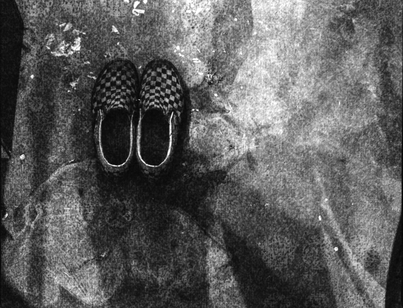

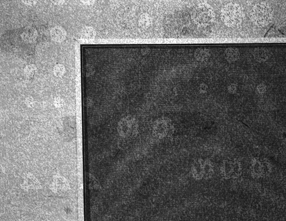

This print-transfer is pretty much identical to what happens with some rolls of Shanghai GP3. I bought a brick a few years ago and it got worse with time, more or less. Didn't notice it on the first rolls, glaring on the last one I shot.
I had the same effect on the that film too. The dots are for those MF cameras that have the red window on the back and the number are pretty obvious. The film is not even worth "Playing with" complete crap. The grain was massive too. I tossed what I had left.

I think you can totally discount the 120 is harman sourced. One of the things they have to buy in bulk is the backing paper, so even if they were manufacturing for someone else, why would they use a different backing, and that backing isn't Ilford, which as we know has little outline dotted circle shapes plus numbers and not solid dots like the image.

you sure it isn't Shanghai? Numbers printing through to film, curly, sounds pretty familiar...

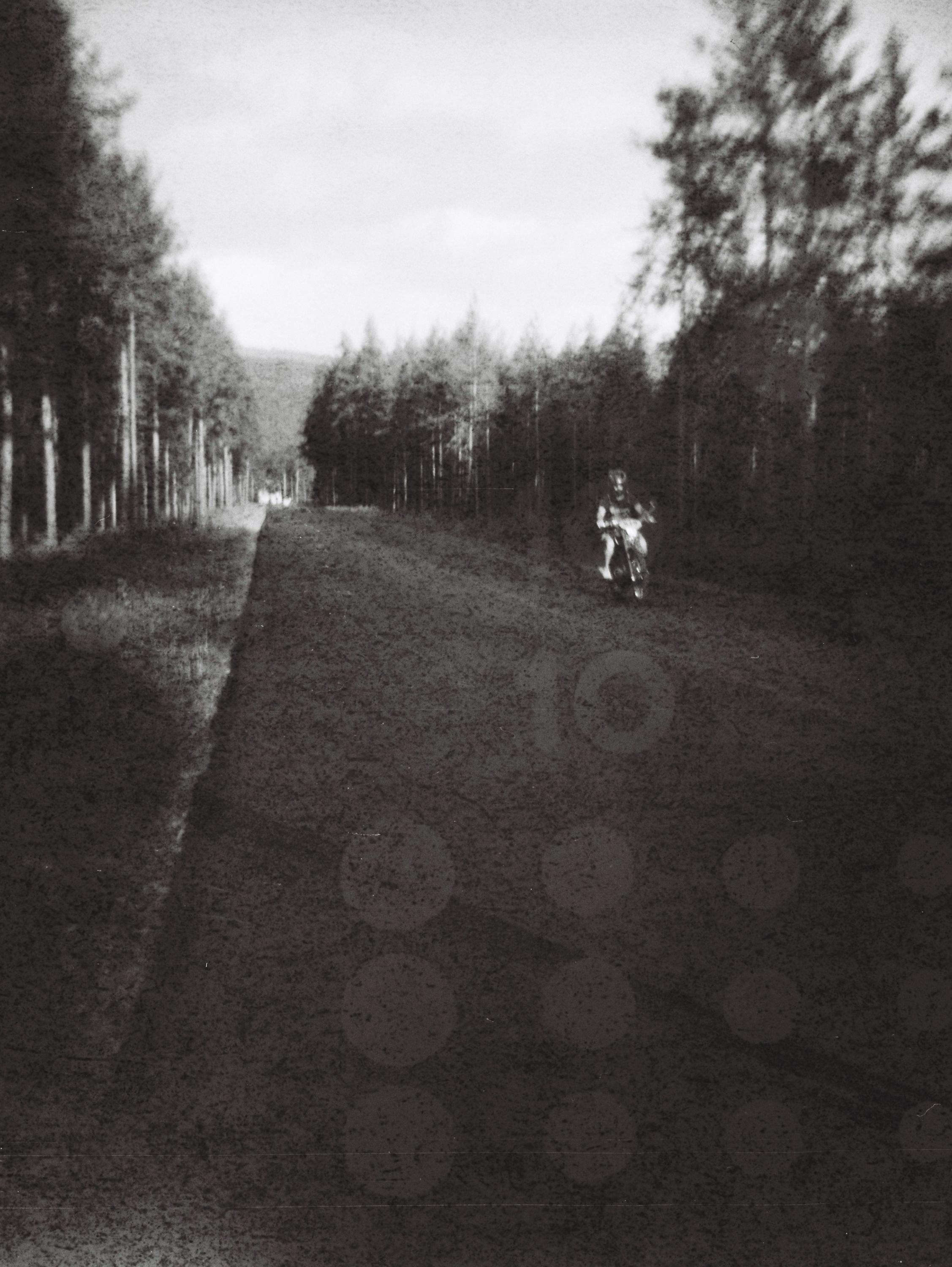

Here's my results from Ultrafine 100 in 120 format. Never again. I stick w/ Kodak and Ilford now. If you like circles, dots, and even film numbers on your images, this is your film. As for customer support, I called them on this. A very pleasant woman answered the phone, and said she was going to get someone who knew more than she did about the film to answer my questions. That was a couple of months ago. I'm still waiting.

Same mottling, same dot pattern and same font that I got on my negatives with Shanghai GP3.

I've used and had very similar poor experiences with the Ultrafine Plus 100 film as noted here.
All of my film had the 'bleed through' numbers and dots on it regardless of what camera it was shot in and how little light was allowed into the roll itself. The grain was a mottled mess just like the samples here already and it curled so bad that I had to use a mask around each frame to hold it down enough to get a scan.

I can report that I tried some of the Ultrafine 100 film that was given to me. Shot a test roll and got exactly the same marks as above, with numbers and dots being imprinted on the film from the backing paper text.
