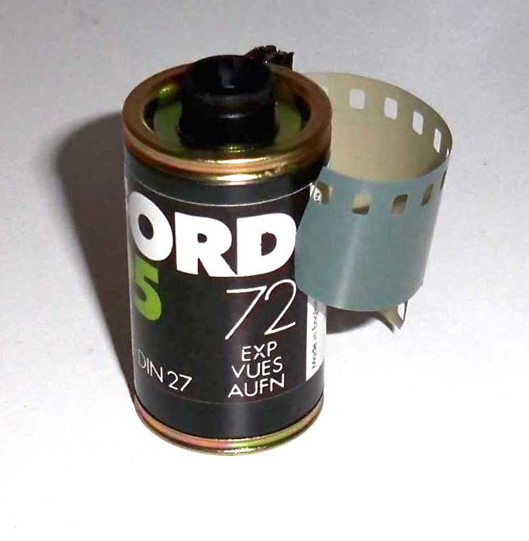

For a while Ilford made 135 film in 72 exposure rolls on very thin stock.
It was the "HP5 autowinder". It was available for a short period of time only. Very thin and blueish. A special tank spiral was available, too. I used one expired discount roll.
I used a lot of these back when they were avaliable.
When I told folks how thin 42L was, this was their immediate first suggestion, lol. Unfortunately I have no way to develop the entire 72 exposure roll, so that would be kinda pointless…
On the other hand, anyone can develop a 100 exposure roll of Minox film -- shorter than a 36 exposure roll of 35mm film.
For a while Ilford made 135 film in 72 exposure rolls on very thin stock. IIRC, there were problems!
I remember these films from around 1982 or 1983. I also remember that Leica offered a special back for the R4 to use these 72 exp. rolls. We had a long thread on this topic about 3 years ago. AgX may have found an advertisement about this back.
