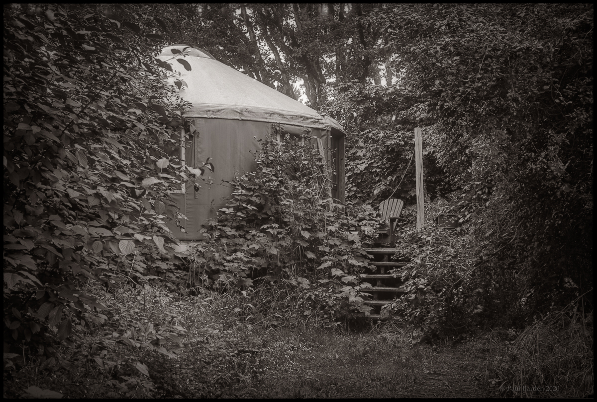

Testing a newly restored and serviced Kodak Retina IIa with Svema/Astrum MZ3, at 2 ASA and processed by inspection (under safelight - its totally red blind) using Xtol stock. This MZ3 stuff is capable of delivering remarkable detail and tonality, if processed correctly.
Large version here: https://live.staticflickr.com/65535/49989920533_18b6055612_3k.jpg

What time did you use for developing? Let's just say my first crack at MZ3 was nowhere near as successful.

5 minutes in Xtol stock. As I mentioned, I developed it by inspection: pull it out of the developer around 3.5 minutes, and then I left it a bit longer. Under safelight, of course.
