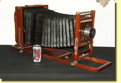

Regarding the 7x11 format I must announce a new baby. I've wanted a 7x11 for several years and finally found one and just received it. It is a Korona in like new condition (bellows are brittle and shot though) with 4 film holders, the extension rail, the support struts and a 5x7 and 8x10 back adapter.
In line with the history question, does anyone know how popular any of these odd formats were?

Hi David,
cool camera!
Just out of curiosity, how big is the back frame? If you can use 8x10, can you do 7x11 verticals!?
cheers
Tim
The back is removable and can rotate like most LF backs so 7x11 verticals are easy as anything. The back is 13" square (330mm). It has 35" of extendion and is surprisingly rigid. The front has rise and shift and the back has swing and axis tilt. I'm certain it has had very little if any use and has just been stored for decades. The camera gods have smiled.
Sounds like a great set-up. I was looking at a 7x11 a year or so ago, but was thinking of mainly using it for 5x7s --and so didnt get it (I have a 5x7 already). I'm regretting that decision now a bit. I guess the problem for me was obtaining 7x11 holders (the one I was looking at didnt have any --it also only had a 5x7 sliding back). Have you managed to get a hold of many holders? That would seem to me to be the main drawback of this format, I hardly see any coming up used. I guess you could buy new ones from S&S, but that would be well out of my price range.
Tim
Holders are indeed the biggest drawback to the 711 format. Sort of hi-jacking the thread here, sorry. The S&S holders are not only expensive, but the film doesn't register in the same plane as the original Kodak holders did which is problematic. Original holders are all at least 80 years old and most are tired. I actually bid on the camera that David bought with the thought of robbing the 3 good holders and re-selling just the camera at a loss.
I've actively kept an eye on holders for about a year and a half now and found only two on ebay which I bought. The camera came with 4. Lens and Repro has several for sale at $125.00 each. I'm led to believe that there were not that many of them out there. Happily all these holders are in fine condition but as Jim said, they are often 'tired'. Getting into 7x11 takes patience, luck or both but I think it is worth the bother. Funny how some things just seem to fit a person or way of seeing for no apparently objective reason.
