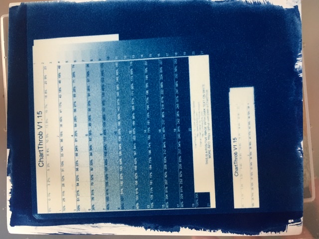

This was WAY to easy. And WAY too much fun. I can see this becoming a very active creative hobby. I think I almost like it better than traditional printing...I won’t make that decision yet though.
3.5 minutes under the natural sun.

Way cool!

This does look like a good time. :smile:
The perceived simplicity of it seems like it’s going to be a big winner in my book! That perception may change once I put an actual negative down but I am so So SO looking forward to the challenge.

Welcome to Wonderland!
Now that you have gone down the rabbit hole, just wait until the experiments begin... there is the whole world of toning cyanotypes and then there are "surfaces" to consider... many, many papers and even other surfaces to adorn with cyanotypes!

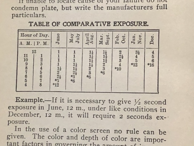

Good start. For me, the first print with a real negative only increased my interest. Printing under the sun has lots of variables, though, that I found a bit frustrating. This table is worth thinking about. I’ve seen others that also include corrections for latitude. And then there is the effect of heat...
I think you posted the Australian version of that chart by mistake. :blink: Hopefully, those of us in North America can simple invert the values...
